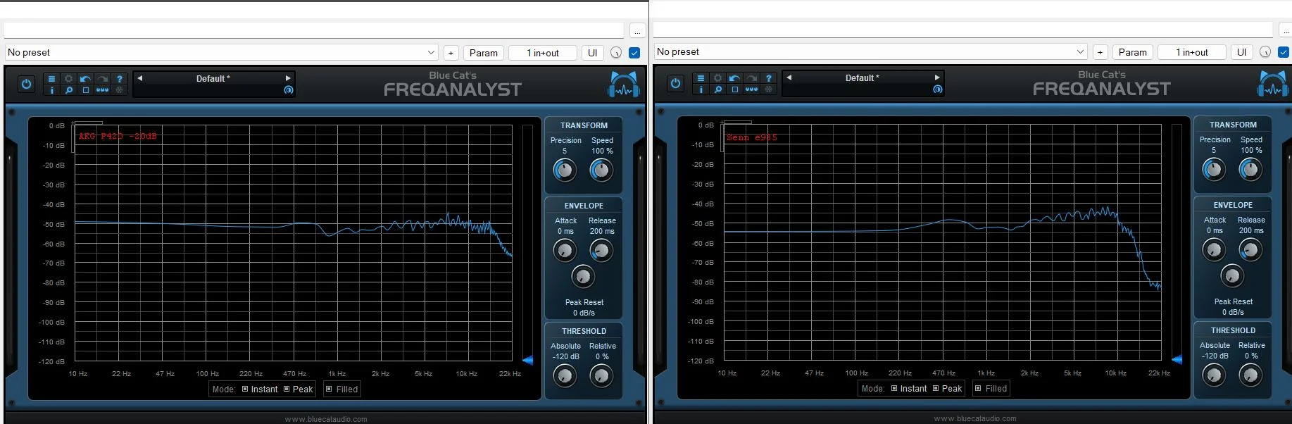

I just spent an hour or so playing with my P420 and my e935. Interesting results!
The setup was to put the two mics about 10ft from my monitors (JBL 805s). I set the level using an online tone generator to put out 440Hz at 80dB. I then set the pad on the AKG to -20, fired up the recording and set the levels as close as I could with the relatively crude adjustments on the interface. The AKG was at about 2:30 and the Senn was at 3:00, so they were fairly close.
I recorded the room noise which was about 44dB since the AC fan is running. I then recorded a 440Hz and 1kHz (the generator didn't put out the same level) so that I could compare them. Here were the readings (Lufs I):
Sound ___P-420____e935
Room ____-54.6 ____-59.8
440 Hz ___-24.7 ____-24.3
1000Hz___-15.1 ____-13.4
10kHz____-22.4 ____-10.6
WhiteN __-23.9 ____-21.2
The 10K numbers really threw me for a loop, so I took a spectrum of the white noise. The 10K is a real boost in the e935. P-420 on left, e935 on right. The AKG actually looks pretty good. Maybe the 935 being a vocal mic, is depending on the proximity boost to even things out.
Now, the whole reason for doing this was to try to get two different types of mics at approximately the same sensitivity, and compare them for how much noise rejection you might get between them. Is a condenser going to hear quiet sounds better? The -20dB pad should do the same thing as turning down the input level. So, the last bit was while recording some silence at the end, I fiddle with two guitar slides on my desk, not very loudly, just moved them around. I then amplified that section equally so you could get an idea of the background rejection. Each was boosted 35dB. They sound very close in volume. The noise levels are obviously different as are the frequency responses.
First is the P420, next is the e935.
I should probably do a part two where I just use the input gain for the interface to do the same thing as the pad did here. But for now, my observation is that a condenser mic doesn't pick up background noise more than a dynamic if the recording levels are equalized.
