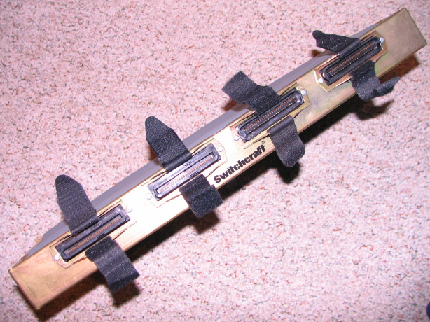

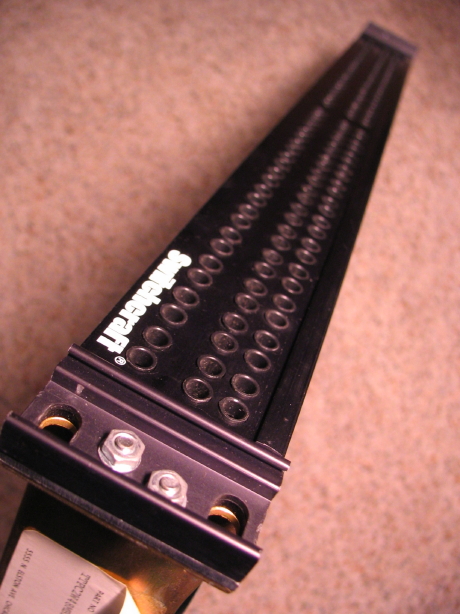

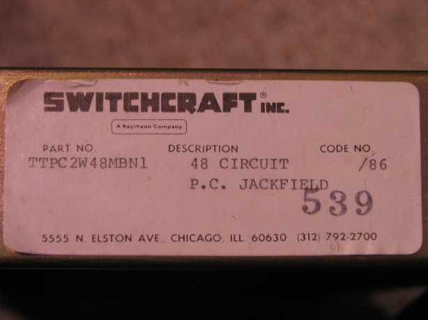

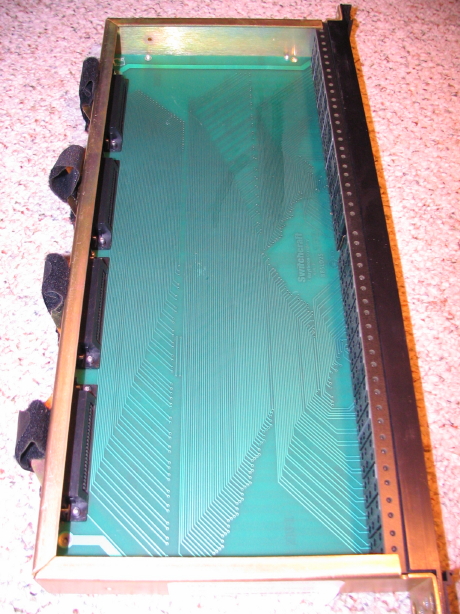

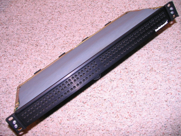

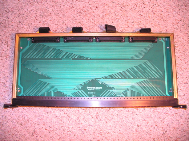

And THAT'S NOT ALL! Anybody need a TT patchbay? I'm yer guy. FOUR 72-point SWITCHCRAFT TT patchbays, PC board type with cinch connector termination...these also LOOK NEW:
And...Oh yes...

Ohhh I hate you! :D

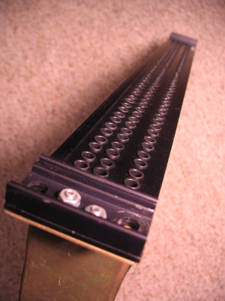

Here's a few more shots of this most recent patchbay:
The contacts are heavy guage. The insulators are, like, resin or something, not phenolic board.
So, again, the JH-416A mixers utilize 5 1U half-width patchbay modules. The factory configuration is 240 points total, 48 points per module. The JH-416B mixers utilize 6 modules for a total of 288 points which could be advantageous if you have a 16+ track tape machine as well as a DAW that's getting tied into the patchfield. The factory modules (which, again, are also made by ADC) are configured as 2 x 24...2 rows of 24 jacks in 2 separate jacks blocks. When I started picking up used ADC patchbays they were all single jack blocks of 2 x 24 jacks...same jack count but squeezed closer together and normalled. I figured that was fine because the first 3 modules normalled anyway on the 416 mixers. Then I started finding the jack blocks with 72 points...3 rows of 24 jacks, 2 rows normalled and the 3rd row doubling the first. When all the wires are removed the first 2 rows are still fully normalled and the 3rd row is independent which is great for the tie lines where non-normalled sources connect. So I have a total of 4 of these 72 point blocks that are in, like, new condition. So I'm thinking of just using the 4 blocks and having 4 modules with a blank for the 5th bay. That would still give me 288 points with the option of adding another 48 points later if needed. The 72 point blocks with 2 normalled rows and a 3rd non-normalled row could actually be really sweet...dense, but practical with room to grow if needed.
