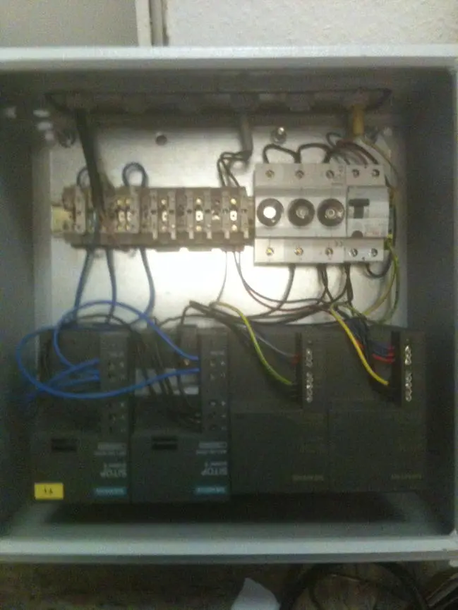

hi, long time lurker on Gearslutz and i found this and i´m trying to bring one idea to the table ...
nearly the same story ... bought a mci 416b without power supplies years ago ...
ended up that my buddy builds supplies with siemens sitop 5 Ampere units just like these :
uhh not allowed to insert ebay url , google siemens sitop 5 Ampere you´ll find them :)
he builds a housing and its works like a charm since then .. means 2007
always been on the hunt for original supplies , but nowadays i dont care anymore ...
it´s been dirt cheap , no fans , reliable ...
easy solution ... even when i think the originals would be "better"

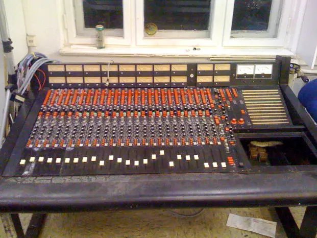

Oh man, thanks for the additional pics so far...what a cool looking room. The ceilings look like they are decently tall...and seeing that JH-416B and JH-16 together is just...cool. :cool: So sorry to hear that the JH-16 isn't working. :( I'm assuming you are going to keep it though and get it worked on when you can, yes? Get hooked up with that MCI forum I linked above. The JH-16 is a source of aggravation for those that have had them but you'll find help there.
So, you are looking for 4 more input/output modules for the JH-416 but it looks like you have a full compliment there...do you have some that aren't working? Just wondering what the additional 4 are for.
Man oh man, I know a lot of the "old timers" did not care for its touchy transport, but damn I'll bet that JH16 sounds SWEET when it's cooperating though! A billion bucks says you have a bunch of Molex pins that want to be re-soldered after being moved...the bane of all MCI tape machine users! Forget paying a tech, it's very tedious work but easy--and if you have a soldering iron and some solder already handy, won't cost a dime.

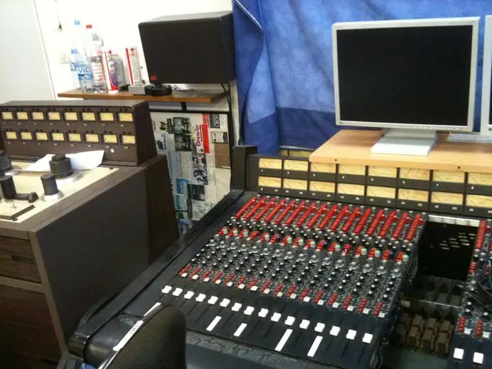

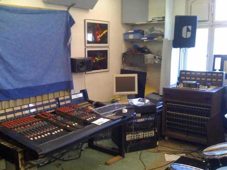

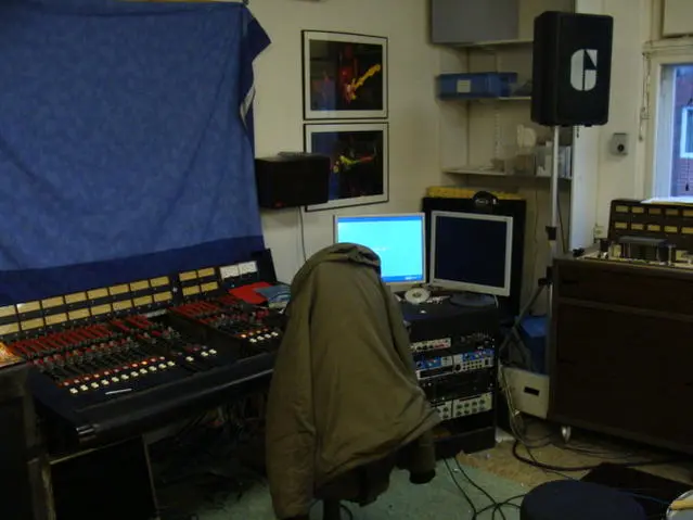

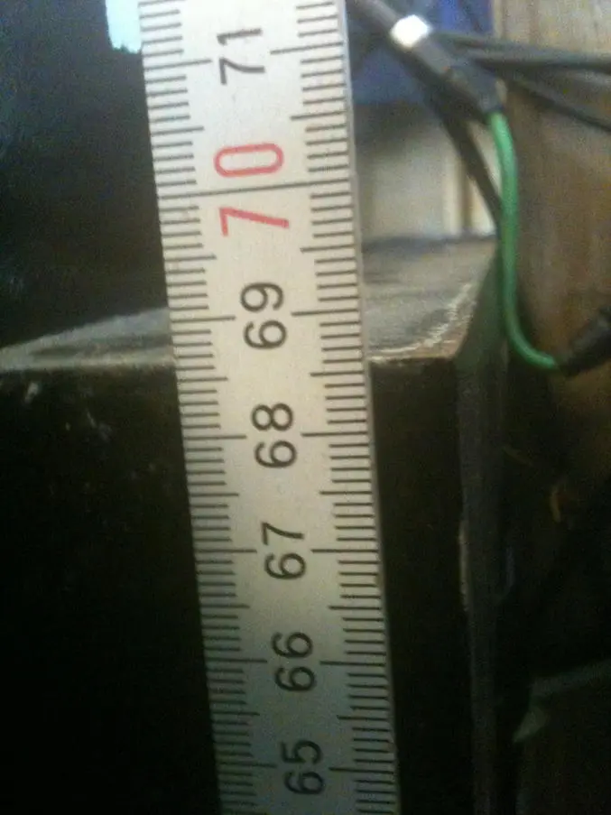

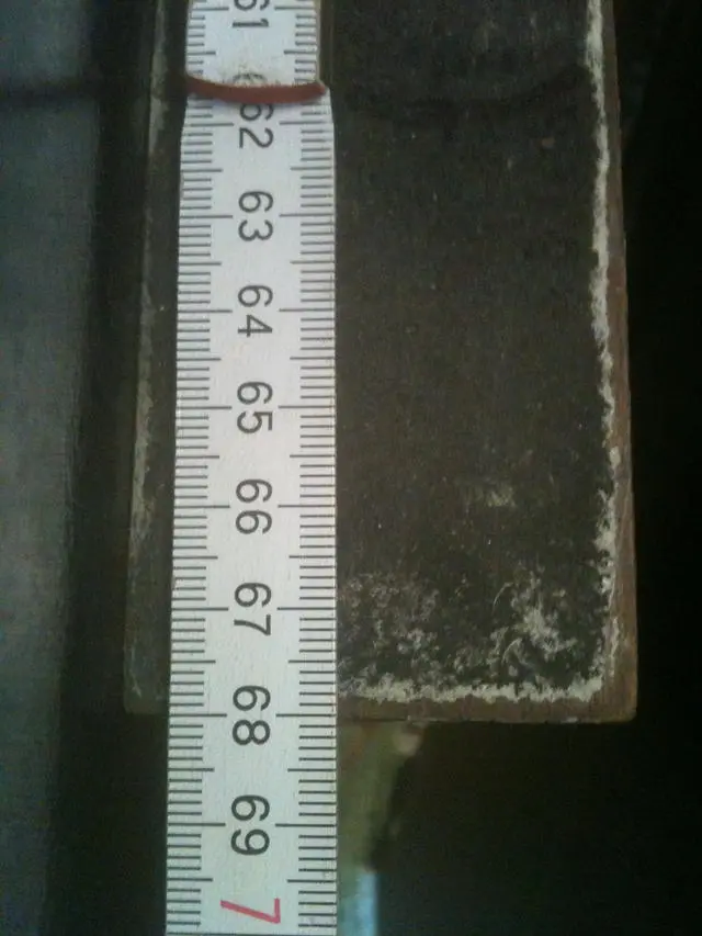

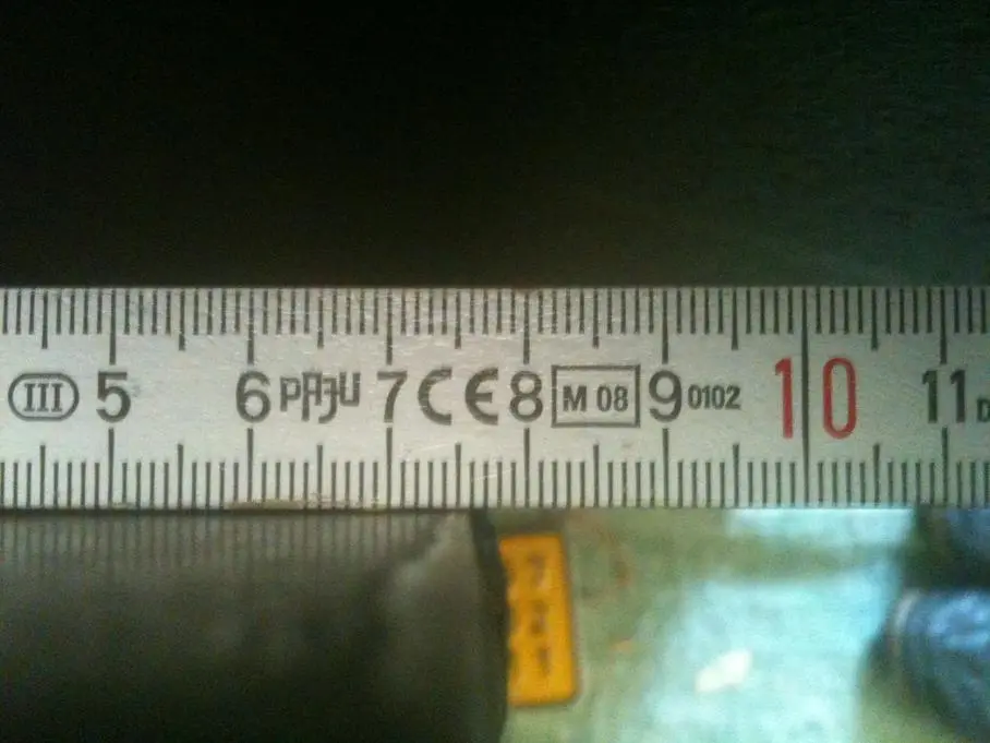

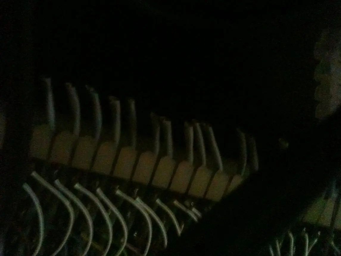

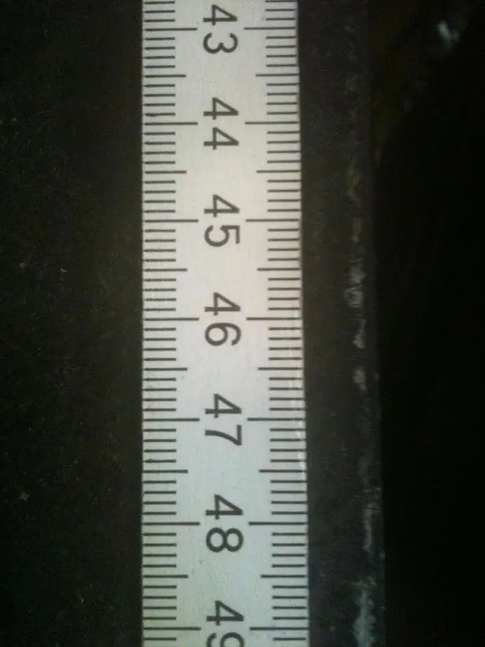

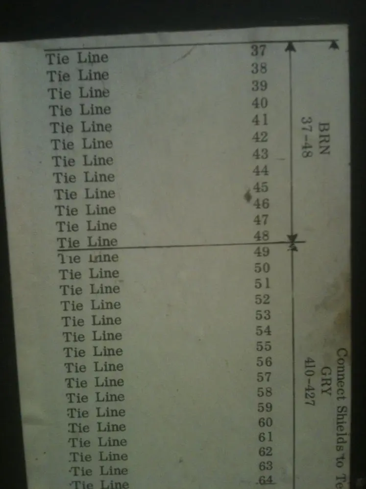

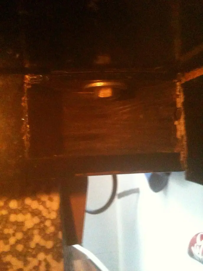

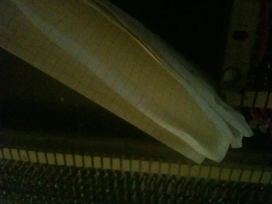

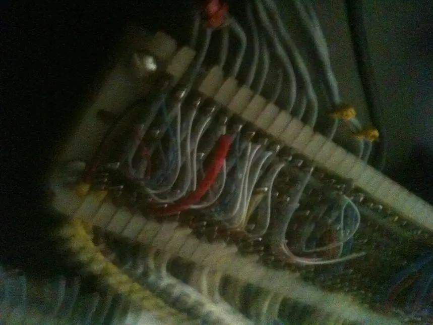

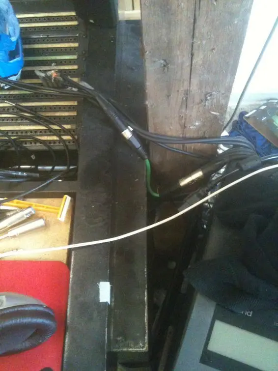

so young Jedi , here a few pics , detailed as possible , iphone quality.
on pic 625 you see the stand from above. Stand dimensions , as you can see : h 68,5 cm , deep : 68 cm and 5 cm thick (?) uhh excuse for my english ( old fart ) and the panels were 5 cm * 7,5 cm . I hope you get the picture. There are two holes beside the console frame. on the inner side of the stand is some metal attached where the the screw goes through. The wood behind is a bit undermined that the screwdriver fits in.
I cant take a good picture cause it so dark.

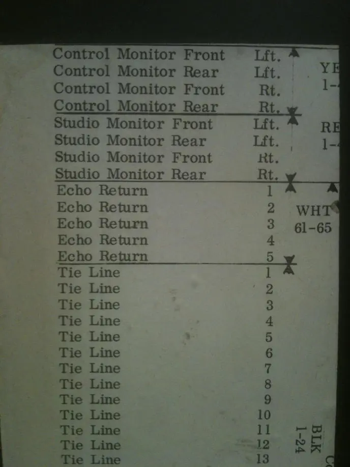

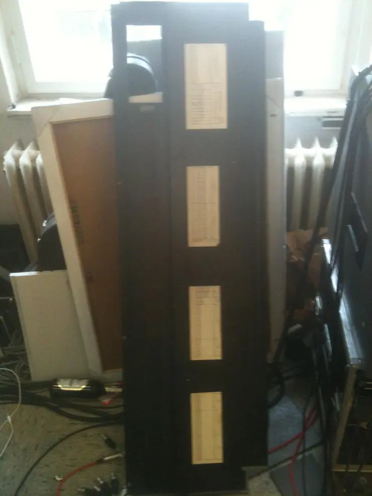

I made also pics from the Back panel and for your interest
From picture 632 on the labelling of the back connectors ....

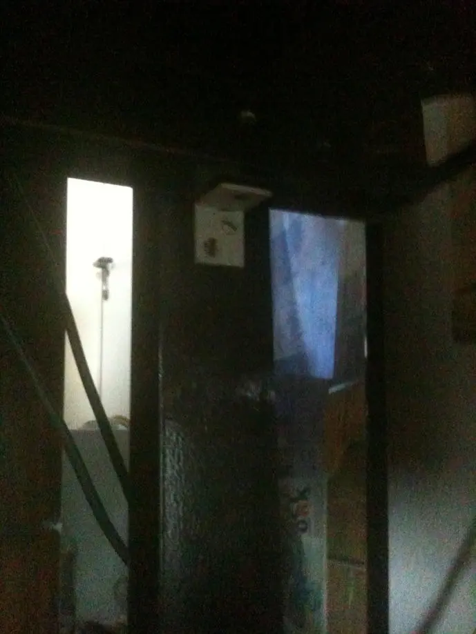

  • Are the square-shaped leg assemblies connected to each other in any way or are the only just attached to their end panels of the console frame?
  • What are the dimensions of the inside rectangle of the leg assembly? Is it, like, 63,5cm tall by 63cm deep?
  • You said in your last post that "the panels were 5 cm * 7,5 cm..." What panels?
  • I still don't understand how the leg assemblies attach to the console frame. I think I'm going to make a video of what I have and what I'm looking for. I think it would be easier to understand.
  • How does the rear panel of the mixer, the cover, attach to the back of the mixer? Does the bottom of it sit on the cable tray and the top bolt to the back side of the meter bridge?

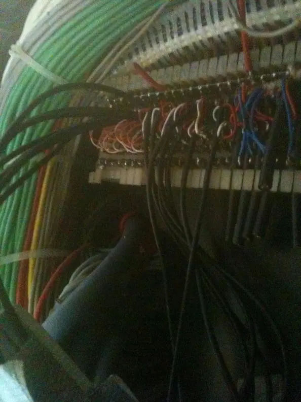

  • I also think I was not clear about what I need with the wiring in the back of the mixer. I need info about the talkback mic wiring and the wiring in that area. I will include this in the video.

So here is a video with my questions about the leg assemblies as well as some detail about some wiring questions behind the meter bridge:
YouTube
NOTE: After capturing the video I found another pair of wires loose...I'm holding them in the picture below; a white and grey twisted pair. So there is that pair of wires, and the terminal strip with one terminal that has two unterminated black wires and one unterminated wire that ends up red...starts out, like, white with blue stripe. The talkback mic has nothing connected to it nor does the lamp directly below the talkback mic.
You can see it all in the pic below:

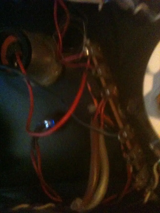

hello again, nice video, good quality ...
only just attached to their end panels of the console frame? yes
dimensions of the inside rectangle of the leg assembly? i´ve taken the outside , height is 68,5cm and alongside the console is 68 cm. And the legs ( not frame , my fault ) is 5x7,5cm.
no idea , ive took it off and since then its off....
now its time to take a closer look my infamous pictures ...ähem ...
dont know in which order theyre appear ,so i post them and reply at first...
