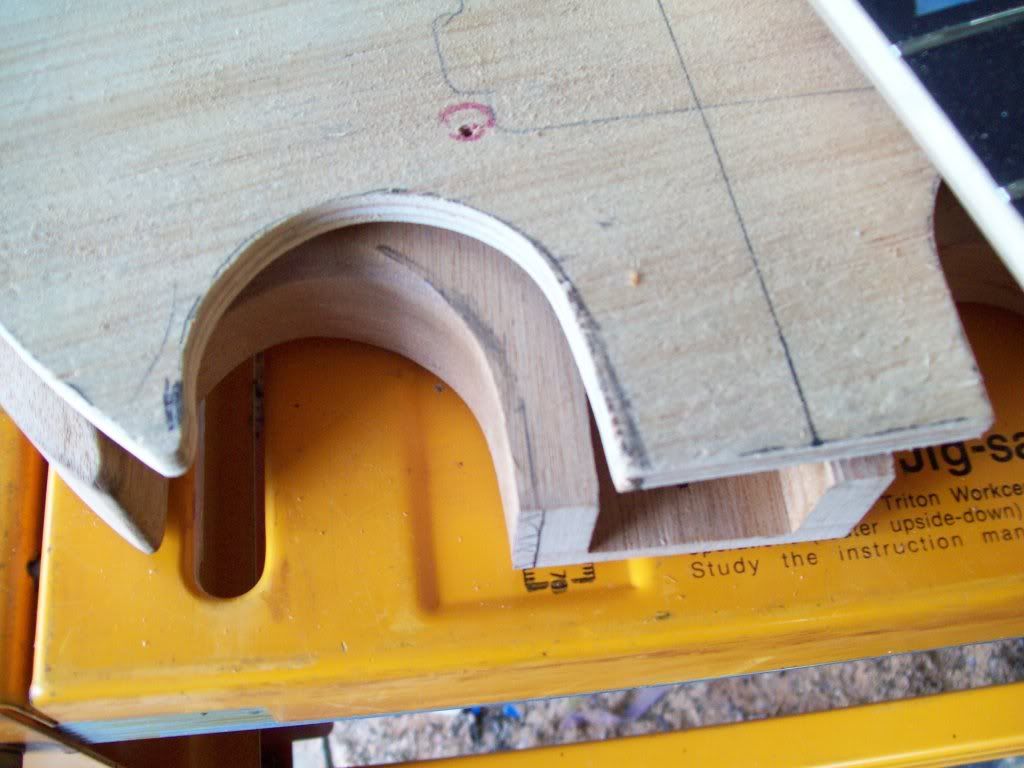

I used paper to make a pattern for the electronics cavity and then made a wood template that had a good fit. There were some slight gaps which I marked on the wood template and built up with wood filler. Sanded back and routed out the cover (same as for the pickguard).
Came out slightly oversize, which means I can sand it back and get a tight fit:

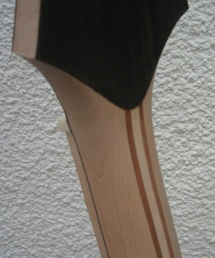

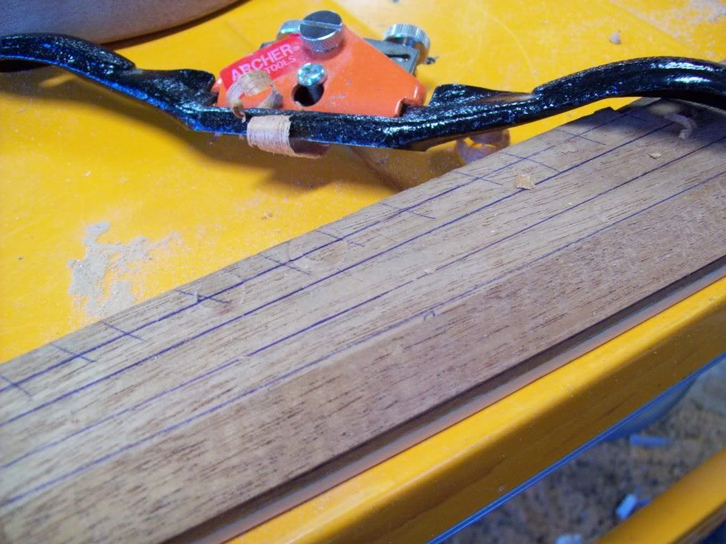

I used a spoke shave to get most of the first 2 facets done. You can work both directions, but must finish both ends by chisel (or a fancier spoke shave that can do tight corners). Leave enough at both ends to allow you to work out the transitions to the head and heel:
Nicely done. Just a few tips for next time and maybe for when you blend into the headstock and heel.
Get a few decent rasps and and some good Japanese knives. A spokeshave is for final shaping and finishing. I hardly ever use them these days and finish with rasps and scrapers.
I will be using rasps and files for blending. Spoke shave is veryt fast and easy, if it is sharp.

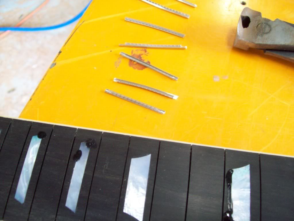

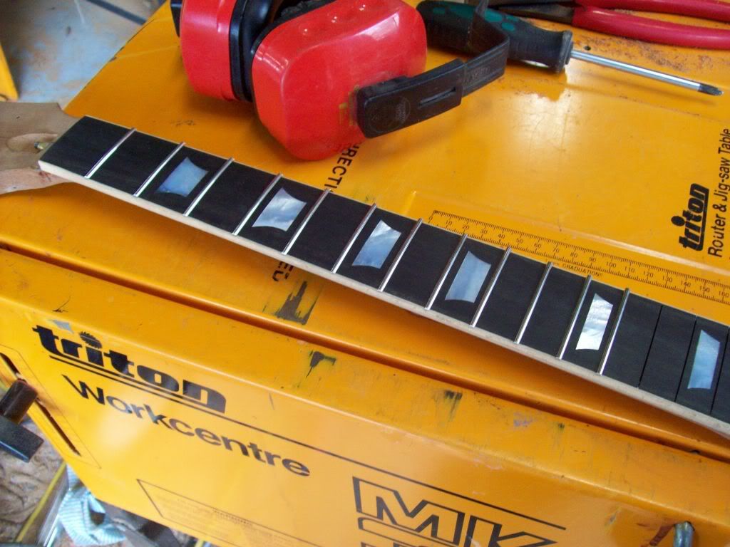

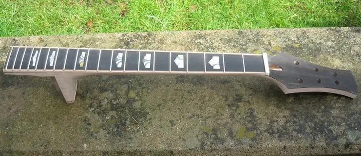

Anyway, I finished the fretboard sanding, filled some spots around the inlays with black superglue, and started trimming the frets. I used the fret nipper to take off the barb at each end and used a triangular file to finish them:

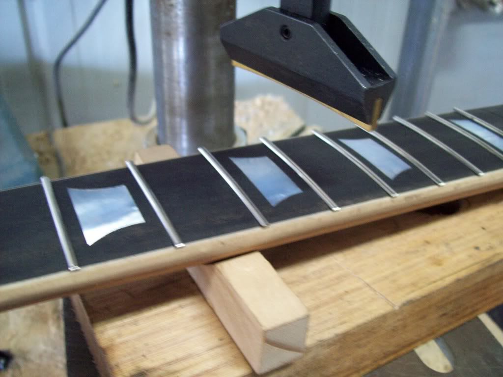

Bent the frets slightly and pressed them in:

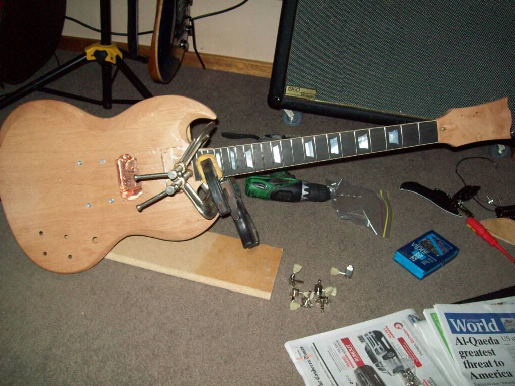

I want to get the neck onto the body this weekend....
Adjusted the template to make a better transition at the mortise and tenon joint. Then routed the body to suit:
I have sanded the head front and back and ready to fit the neck onto the body.

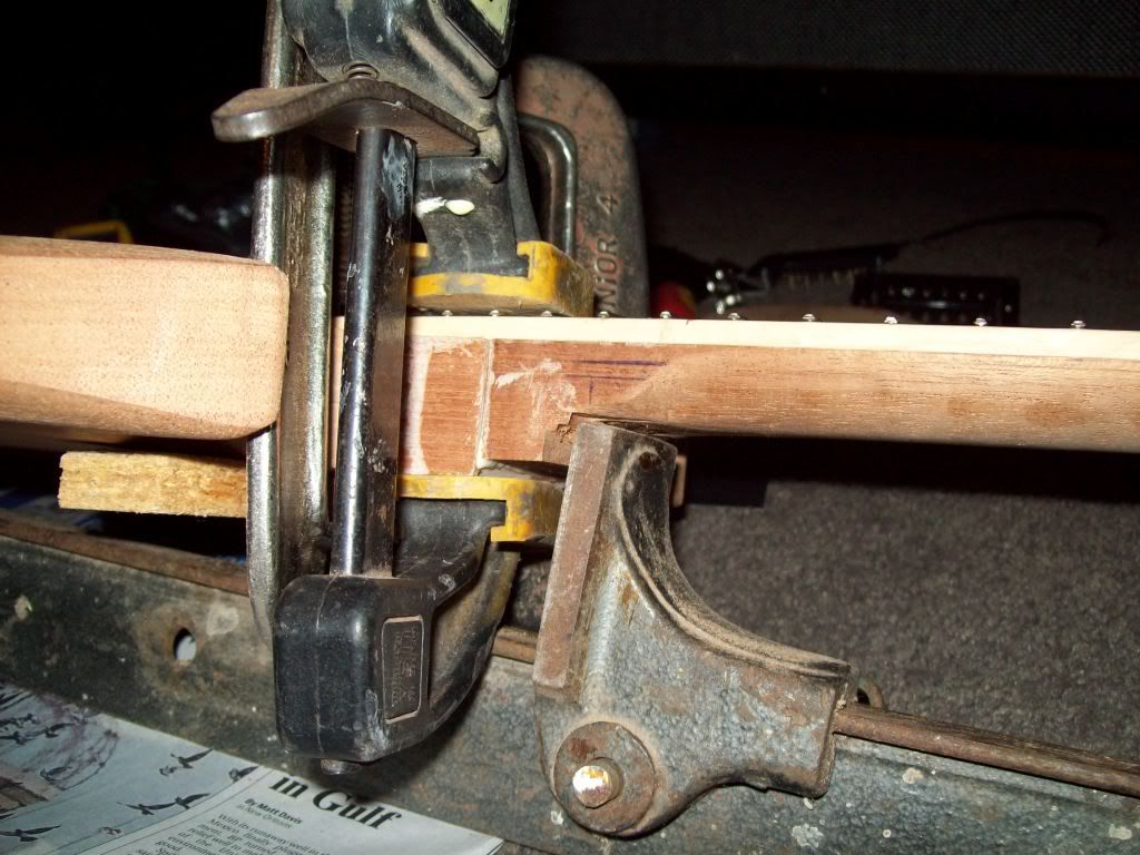

Cramping Neck to Body
I set up two G cramps so I could get a laser line between them and aligned the neck to the body. Then put a larger cramp to pull the neck into the body and another over the frets. Leave the the heel flat and oversize to allow this:
I'm not doing you down fella, I'm trying to help. You can use a spoke shave all you like if it works for you thats fine. I'm just telling you what works faster and ways that may make the process a bit easier to predict.
Most do it like this.
Have a template of the neck profile at the first and twelfth fret (or the nearest fret before the heel starts to shape). Take a rasp and cut the neck profile at those two points. Get it as close as you can with just a little for cleaning up the teeth marks. Next blend in the heel and headstock with a fine rasp. Then remove the remaining timber between the first and twelfth fret that you have cut to the finished profile. You then use the spokeshave set to a very fine cut to remove the teeth marks and finish of with a sharp cabinet scraper.
All tools should be sharp. If they are not they lead to mistakes and even worse accidents.;)

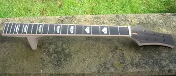

Here is the result of about two days work from start to finish. I'll butt out now good luck with the rest of the project. I hope it plays as good as it looks.

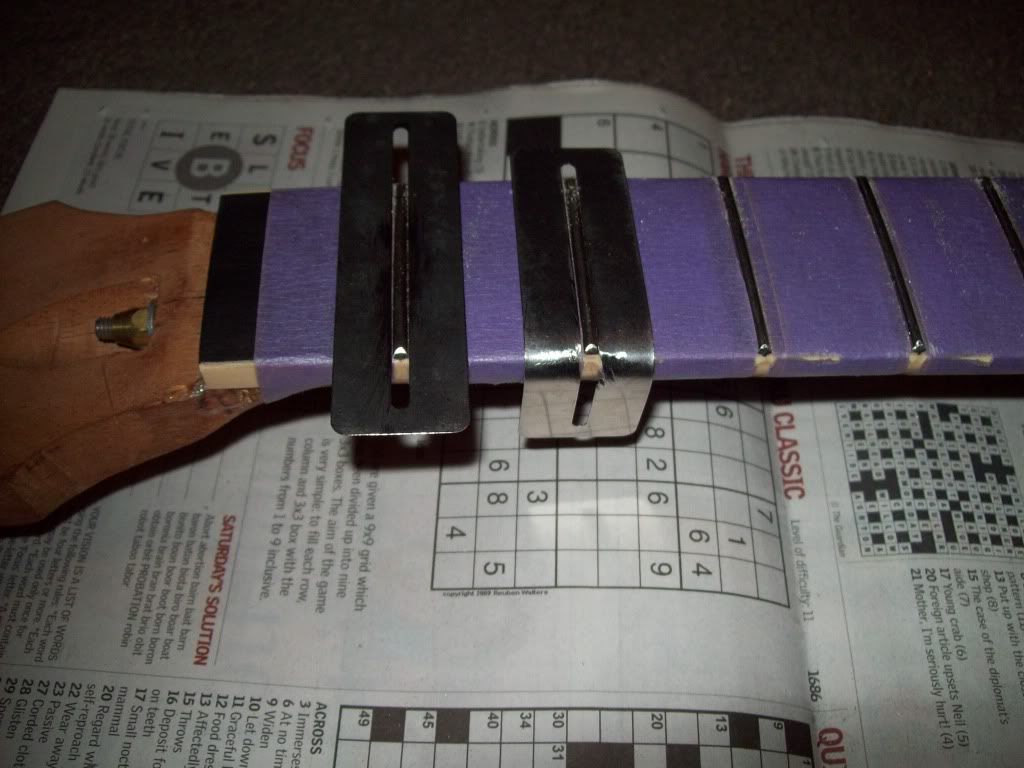

Filing the Frets

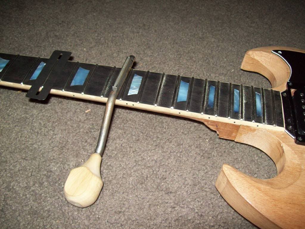

I covered up the fretbaord and used Stewmac's fret protectors when I filed the ends of the frets. I bend one in half and it protects the fretboard and binding. Also put dots on the binding:
Then used a straight edge to rock between three frets and filed down high spots. I tested in at least three spots on the fret (top, middle and bottom):

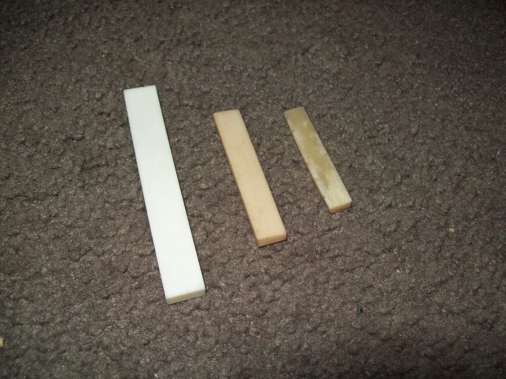

Wanted aged bone and could not get any. Used hot tea for about 10 minutes. Left is bone in original colour, middle is 'tea stained' bone and right is aged from Stewmac:

Stupidly took a gouge out of the binding and VERY UNHAPPY....
Pulled the frets and routed off the bindings on both sides. They actually came off very nicely so I did not take any wood.
Pulling the frets caused chipping, so I will be sanding the fretboard down. This will cause me to sand the inlays too thin so that the outside edges disappear. May get Gibson 'custom' squares instead now.
Anyway, about to order more inlays. If the chips cannot be fixed reasonably with minimal filling, then I will plane the fretboard off and replace it with rosewood that I have laying around.
Anyway, I can blend all the joints and should get the new inlays before next weekend.
So moral of the story is cover everything up.
