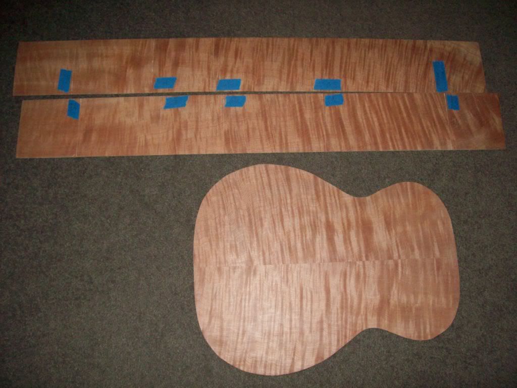

I am spending more time making a 'Martin' OM acoustic, but still trying to get the SG finished. You can see the acoustic (curly myrtle and engleman spruce)if you look at my photobucket account (check the pic's properties).
