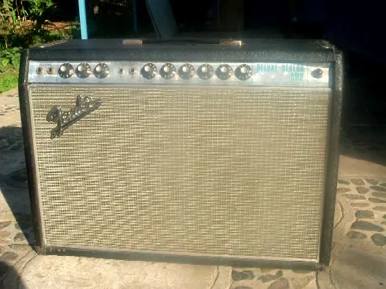

gotta check the chasis codes - but given the aluminum frame around the front - it sould either be a 68 or 69 ....
... damn - as old as I am :eek:
well.... true to my motto "the dumbest farmer has the biggest potatoes" :D ... - it also looks like it is a *very early* transition model, with the original (and highly desirable) Blackface circuit!
so its a blackface in a silverface dress ... and to top things off - I even managed to get the reverb to work
hmmm ... :cool:
Are you sure? I have a very early ('68) silverface Super Reverb, and Fender had already changed the -42V power tube biasing circuit and a couple of other things away from the AB763 (blackface) specs. It wasn't that hard to switch it all back, though. Anyway, according to what I can see on the web, the silverface cosmetic change coincided with the change from the AB763 to AB868 circuit.
I have a '65 Deluxe Reverb, and it is most likely the last amp I will ever need. Congratulations!
I am not 100% sure - havent pulled the board - (and if I would - I couldnt tell either ... I am dumb as dirt ... heheheh :D )
- but the tube-chart mentions the AB763 circuit ... so I'm thinking this circuit is actually in there ... (could be wrong - fender has screwed up before!)
btw... whats the chasis number of your's? mine is something like A26191
thx
alfred
ps: is there an easy way to tell for a non-electronic guy which circuit is in there?
