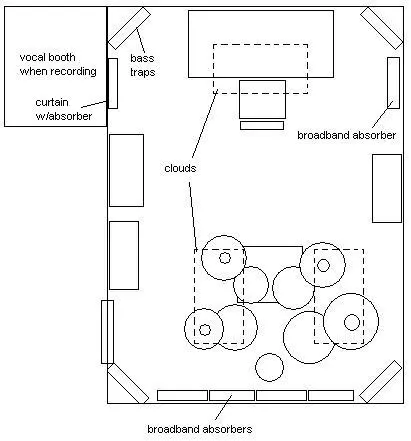

I have drawn a plan of how i would setup the room. Broadband aborbers and bass traps made of 4"x1" wood, 2x 2'x4' 4" rigid fiberglass, and cloth material. These will be movable so you can put them in the vocal booth when recording vocals. You don't need them for practice purposes, but when it comes to recording, you will be better off having them. Above the mixing position i have shown clouds, these are just like the bass traps and broadband absorbers but i would suggest not having the wood. You will want you mixing position to be centre of one wall like shown in the plan.
hey thanks alot for the help we im going to show the other guy this stuff tommorow and hopefully get started building. Again thanks alot for the info! -Jingleheimer-
You shouldn't need the absorber at the curtain, just as long as the curtain has a lot of waves in it, it sould work quite well, and possibly put all those clothes you have in the vocal booth behind the curtain too. The rigid fiberglass usually comes in packs of 3 i think for $60, and you will need 18, so that it $360+wood and cloth. But it should be good for acoutics. Maybe, when mixing, take down the drums and put them out of the way.

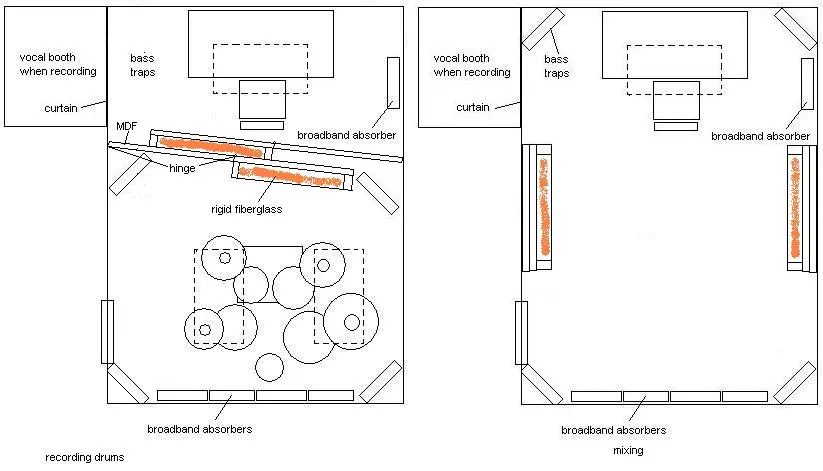

Just had a thought for isolating drums while recording. It should reduce the volume of the drums a little which will make tracking a lot easier, and when mixing it works as a broadband absorber. Will need 8 more 2x4 4" rigid fiberglass, more wood, cloth, and MDF
Might wana put plasterboard up for a ceiling, to reduce noise to upstairs, and so you can get a seal around the isolation thing. To get the signal from the drums, you cud install cables above the plasterboard ceiling. Forgot to show in the picture for the isolation thing that you will need seals anywhere that air can get through.
Hey thanks again man the help is great! And in the second picture with the movable absorbers on hinges i love the idea. In fact that was one of my concers for tracking as to how i would be able to track our drumer(he likes to play with volume HAHA) but again thanks a ton for all the help. Hopefully when we complete it ill post some pictures to let you know how it went. -Jingleheimer-
