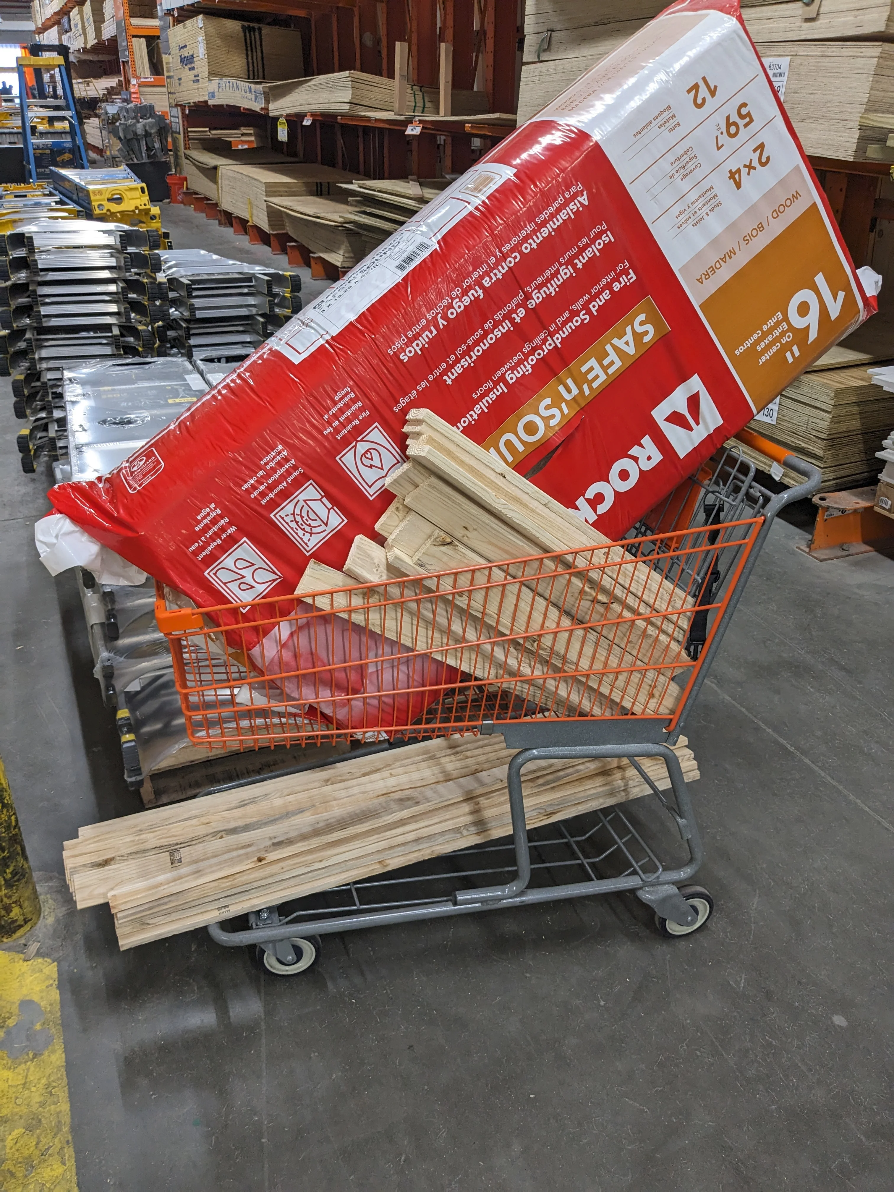

2. Went to Home Depot and bought enough lumber to make twelve 4' long pieces and twelve 2' long pieces, eyehooks for hanging, and twelve 2'x4' batts of Rockwool

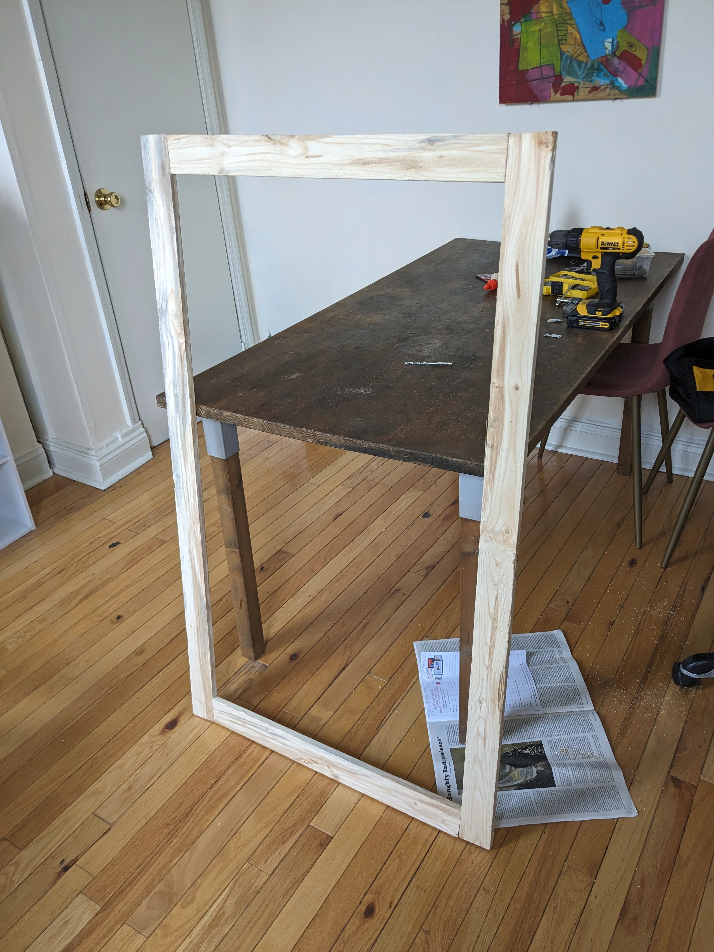

3. Drilled the lumber together to make wooden frames, installed hooks on inside of frame towards rear.

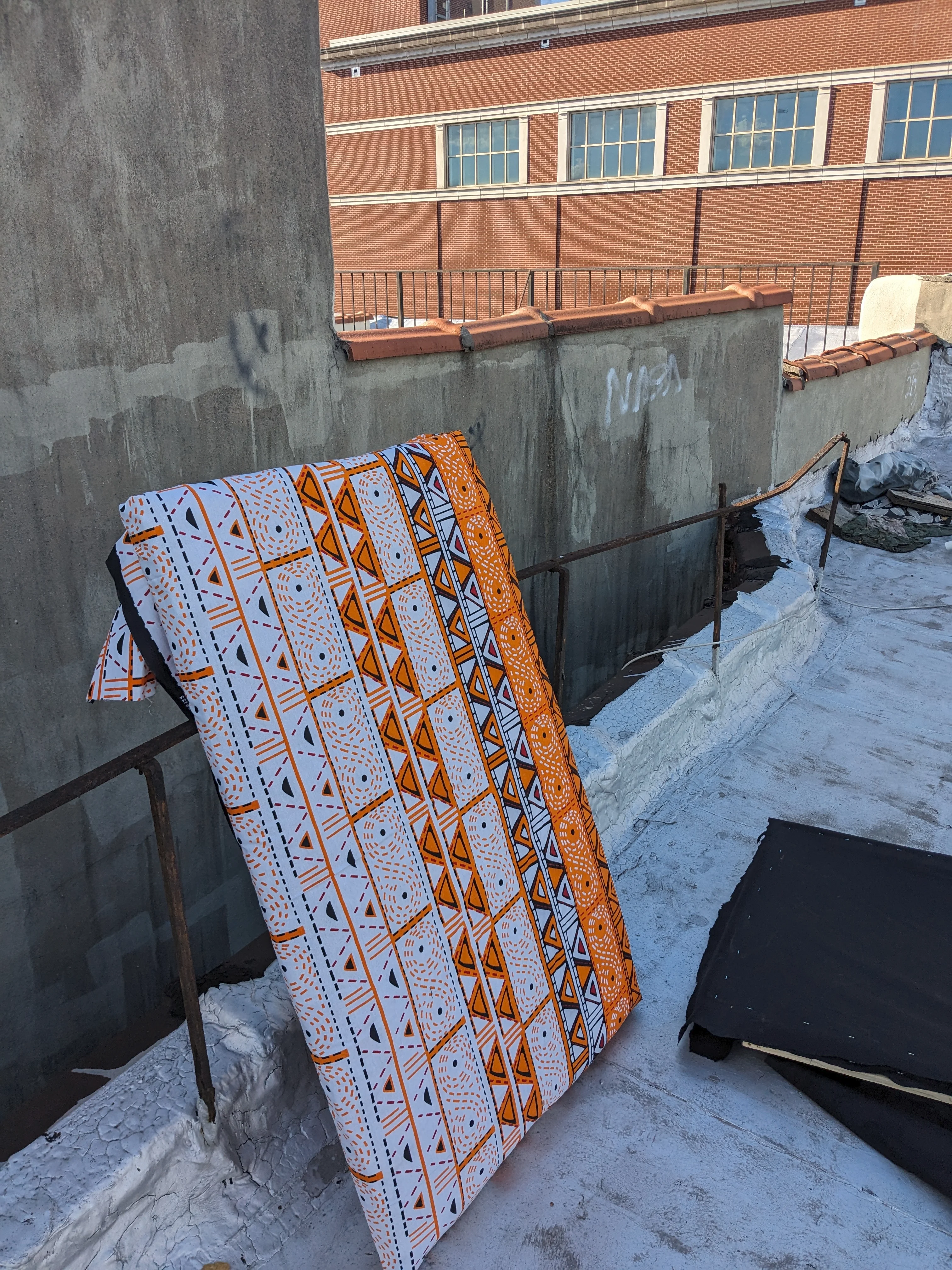

4. Picked up some fabric from a nearby fabric store.

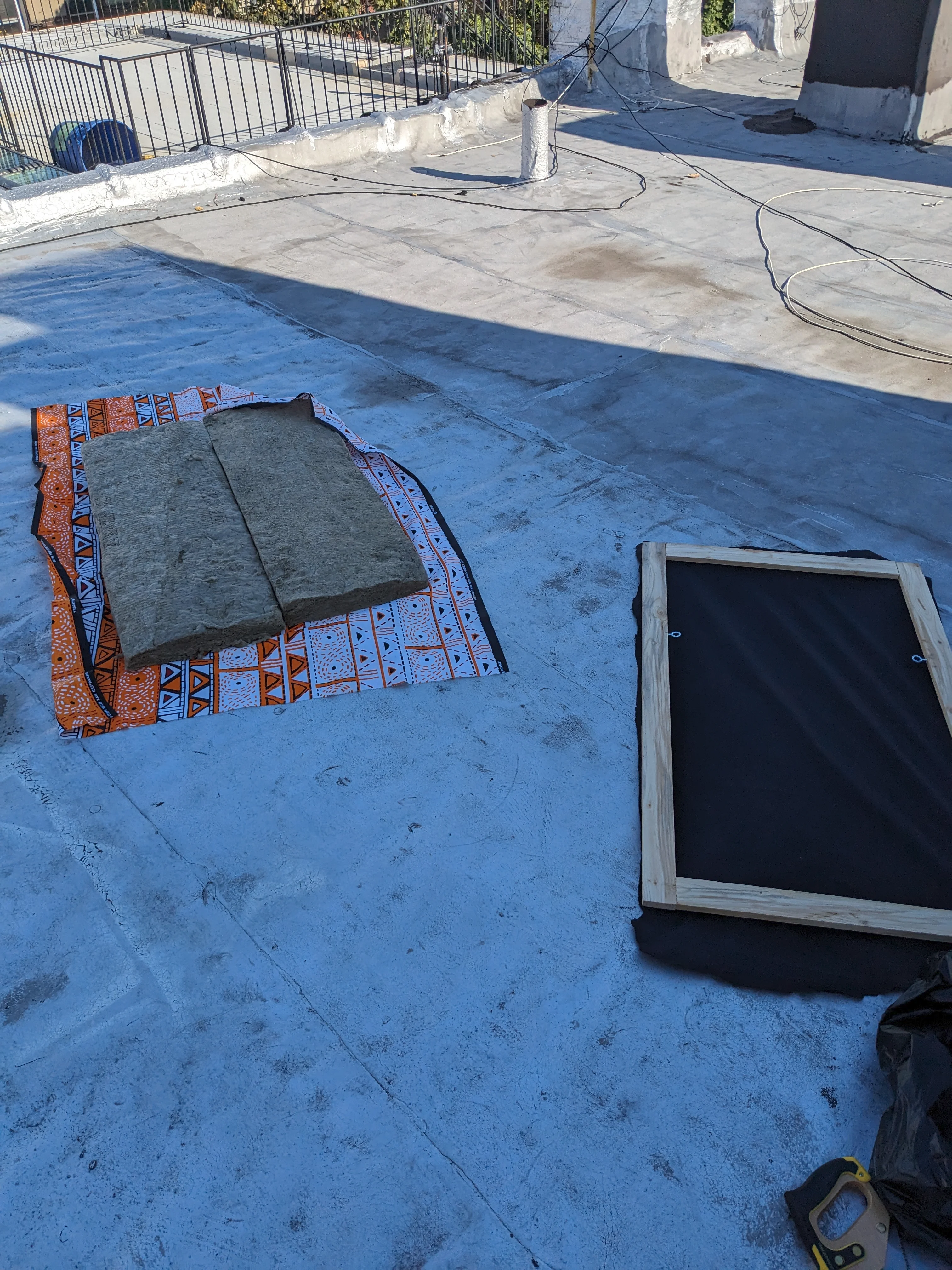

5. Stapled boring inner fabric to the inside of frame.
6. Laid down pretty outer fabric, laid Rockwool inside outer fabric, put frame on black-fabric-side-down, pulled the outer fabric tight and stapled all around (took almost 1000 staples for all 6 panels)

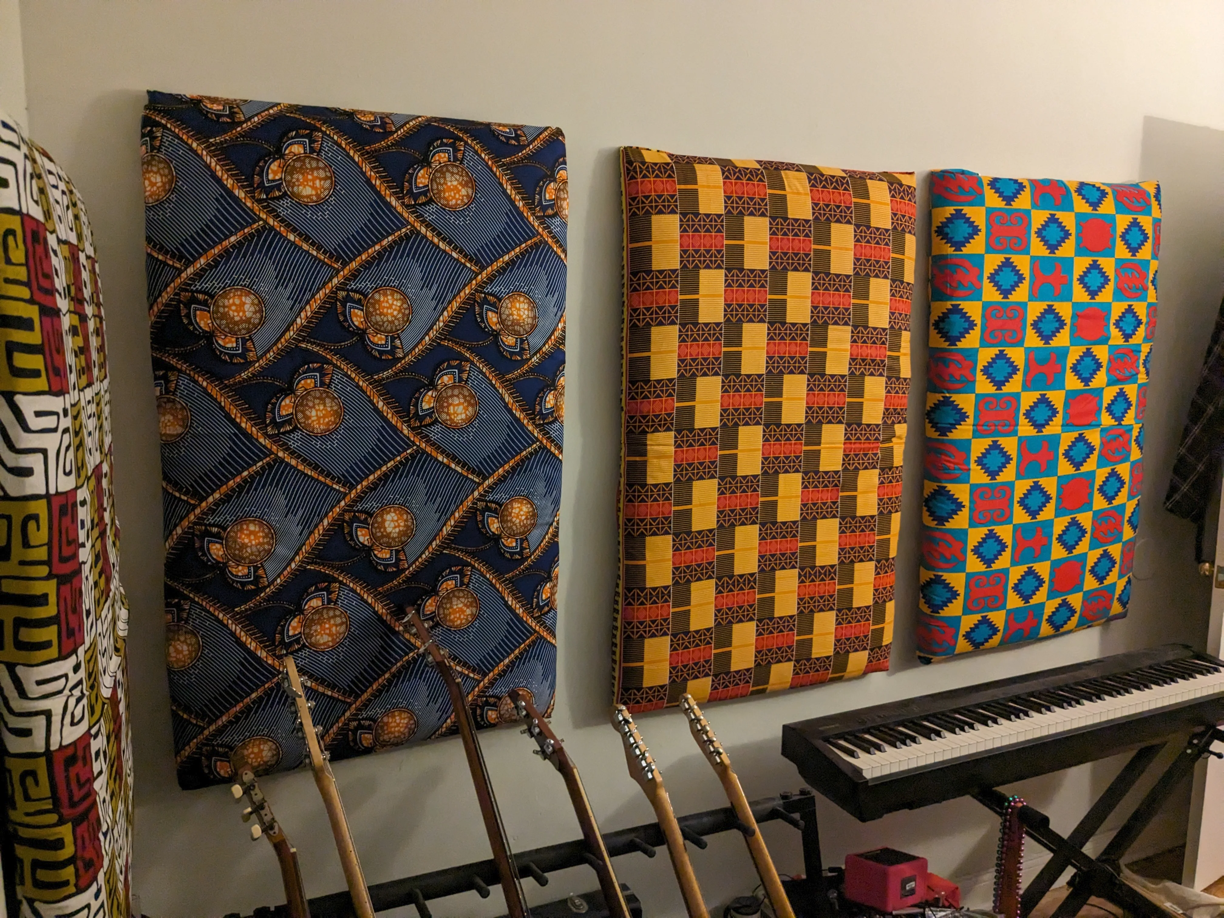

7. Hung them from picture wire off the hooks.
8. Realized I needed a rug and moving blankets too, so back to Home Depot for those.
It sounds... better. It does not sound like an immaculately treated recording studio; there is still a noticeable early reflection. But I need to get back to recording to stay on track, so it will have to do for now -- this was only supposed to enable me to record mics, not become its own endless project!!
I am able to use an Oktava Mk 12 and an SM57 in here and they sound awesome. I also have an AKG Perception 220 LDC which is very finicky, I'm really only able to use it in here if I drape one of the moving blankets over my head and the mic lol.

I think I watched that same video, when I was going to build some panels (again, I've built a few in the past).
Good for you! That is awesome building your own panels. And it does make a difference for sure on early reflections. Considerably more frequencies dealt with then your usual Amazon foam stuff (which I use a bit of as well).
I built some last summer, in a similar fashion, but my frames were at a depth to lay the rockwool inside of the frame, and then use some sort of fabric to cover it.
I like the fabric you found, nice designs.

That is really cool. How did you decide how many panels you needed for the size of your room?
Your panels are definitely nicer looking than mine from 7 years back. Good project.
CLICK THIS TO EXPAND ↓
Well, the room sounded awful and echoey before, so I just wanted as much coverage as possible. Measured the walls, and anything that could fit a ~2.5 ft wide panel got one. Wound up with six panels overall.
