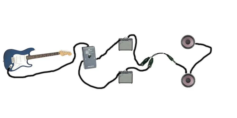

Alright, so here is a rough diagram of what I was thinking.
I diagrammed it with the speakers outside of the amps to make it more clear. Just think of the speakers as separate cabs, and the SCXD's don't have speakers.
Would this work?

apparently not, because you're basically trying to drive the two 8-ohm speakers with 1 power amp (which has a 8-16 ohm power out).
From what I understand, if you run the 2 speakers together (I wanted to do that too) you'll end up with a 16 ohm load, which will defeat the purpose of having 2 speakers (if I understand that correctly). Plus, you'll still need to do some soldering to even make that possible.
You'll also need to do some soldering to add a line-in on the driving amp, to run the other amp's line-out.
way too complicated and voids warranty on both amps.
you'd be better off getting an external cab, like the currently cheap Crate V-series 2x12 ($120 shipped!). Then you could maybe mod to add a line-in and get something like a modeling preamp, maybe a SansAmp, which would model a similar clean you want. Standard SansAmp GT2 has a "Fender" rig, but they also have their "character series" Bassman sansamp. Or maybe the Boss Bassman pedal?
Keep in mind, in your drawing you're basically using SCXD's digital preamp on one of them and using the power section of the other (with or without its preamp) to drive the 2 speakers.
With that kind of investment, why not just get a decent fender 2-channel all-tube amp, like maybe Hot Rod Deluxe?

I'm so confused by this.
I don't want to sound too much like a jackass here, so just so you know, I really do appreciate the input, and I'm really trying to understand:D
Alright. So the 2 speaker thing. They would be daisy chained. As if they were separate cabs. I've been told by members on this forum that when you daisy chain speakers it doesn't affect anything. But this is just what I remember, I might remember wrong, or have been told wrong. So I just want that to be clear.
when you say this...
"Keep in mind, in your drawing you're basically using SCXD's digital preamp on one of them and using the power section of the other (with or without its preamp) to drive the 2 speakers."
I don't get it.
Why? In my drawing I (this is at least what I thought...) I have it so the guitar will only be going through one amp at a time, and that the amps aren't connected to eachother in any way. Only one of them would be played at a time. And then only one of them would be powering the speakers at one time.
Does that make sense? I don't get the whole using digital of one and power section of other. If you could explain, that'd be sweet :D
Soldering I don't mind really at all. I'm just wondering in theory if something like my diagram up there would work.
Assuming I'd be using just the "amp" part of the SCXD's and that I'd just use 2 separate cabs.(both have in AND out on them for daisy chaining).
So does that make more sense? Did my diagram just not make sense? Or does everything you said still apply here?

First off, it sure looks to me like in your diagram, assuming each of the two speakers is an 8 ohm speaker, you are looking at a 4 ohm load. For the 8 ohm output this is not a good idea and will add a lot of stress to your amp. It may handle it for quite some time, but it may not last long either before you are replacing an output transformer. What would worry me about this layout is that you have two amps hooked to one set of speakers. This could be an issue, but I am not sure how it will affect things because I think it depends partly upon other factors that are unknown to me. One thing I would at least be wary of in this situation is getting a GOOD A/B pedal that does not allow you to do a Y signal path like many A/B boxes do. If you were to accidentally hit a Y setting, both power amp sections would be feeding the same set of speakers at the same time. Technaically this may or may not be a problem, but it seems like there are some bad possibilities there.

Actually, you can. Radial Tonebone makes an amp switcher to switch between 2 amps to the same cab. You can wire up the two speakers together (As if they were together in one cabinet), and hook up the outs of the amp to the switcher, and the switcher to your "cabinet". Be aware, wiring the speakers together will change your ohmage. Doubled in series, cut in half in parallel. This will only work if the amp can be outputted to a different ohmage than the built in speaker by itself.
http://guitars.musiciansfriend.com/...VT-Amp-Head-Switcher-for-Tube-Amps?sku=153911
This also incorporates an A/B. It's pricy, though.
