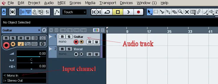

You just need to create a mono bus via VST Connections. Select the mic input from the Alpha there. Then create a mono track, and select the mono bus input you created, on the left pane.

omg I cant get that choice on my inspector only no buss or stereo left or stereo right exist your pic says mono in i cant get that option???
Devices>VST Connections>Inputs>Add Bus. Select Mono under Configuration. Now it will. :)
