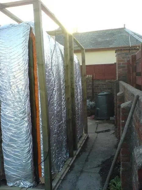

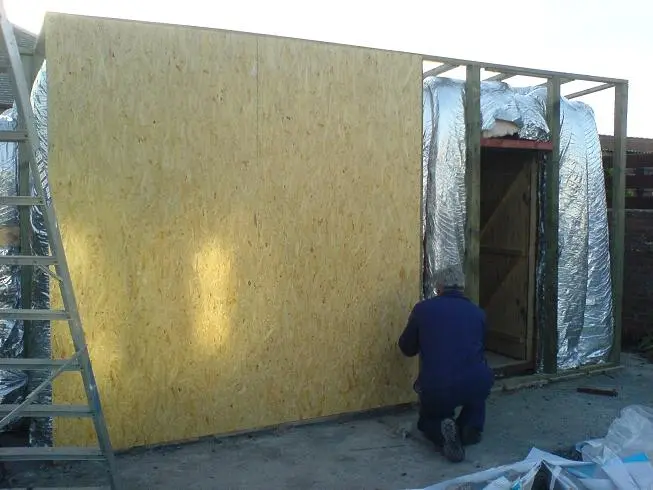

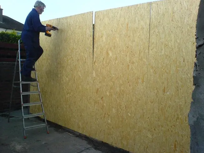

Got all the insulation in and started on the outer layer. Also, the guy came round about air conditioning today.

Looks like its going well! Unusual approach to insulating but its a really good idea! Good luck with the rest, keep us posted!
Thanks very much, hope it works. It seems to be at the moment and it's not even done yet :D
Hey Pandamonk...where are you from? Just curious...I seem to get drawn in when I see the different construction techniques from around the world.
Hey Pandamonk, I haven't seen your plans, but I'm a bit curious about some things I saw in the pics. Is this a "room within a room" design? Is this being built on an existing slab? :confused: :eek: Not to be negative, but am I missing something here? It looks as if there is NO foundation, is that correct? Dose your local building codes allow building something like this with no permits, or do the pics not show certain things. Like...ceiling rafters? You aren't really planning on hanging drywall from those "2x4's" spanning the space are you? Is there a "seperate" floor for the interior space? Sometimes work in progress pics suggest things that arn't there, and if thats the case, sorry. But if what I see is reality....man, MY local building inspection department would have a field day :eek: No offence intended, as the pics don't show everything. Thats why I am asking questions. Say, do you have any drawings, like sections or details you could post. Some people might learn something from them.

Yeah room within a room. Yeah on slab which we laid. No foundation, you are correct. It is being built as a shed and you are allowed to build a shed up to 25m2(squared)without planning permission. There are ceiling rafters which will support the weight(hopefully)The floor is what came with the shed. I know what I've done, ain't the best idea, but it's all I can afford, and it seems to be doing the job. I only have a plan which are posted in "home studio, help needed"
Cool. Thats all I was wondering. I've made recording spaces from worse. :D Please don't take offence to my questions. Its just that some people may get the idea that certain things are legal in general just because they saw it on the internet. ;) And good luck with your space. Most of all, have fun! :D
