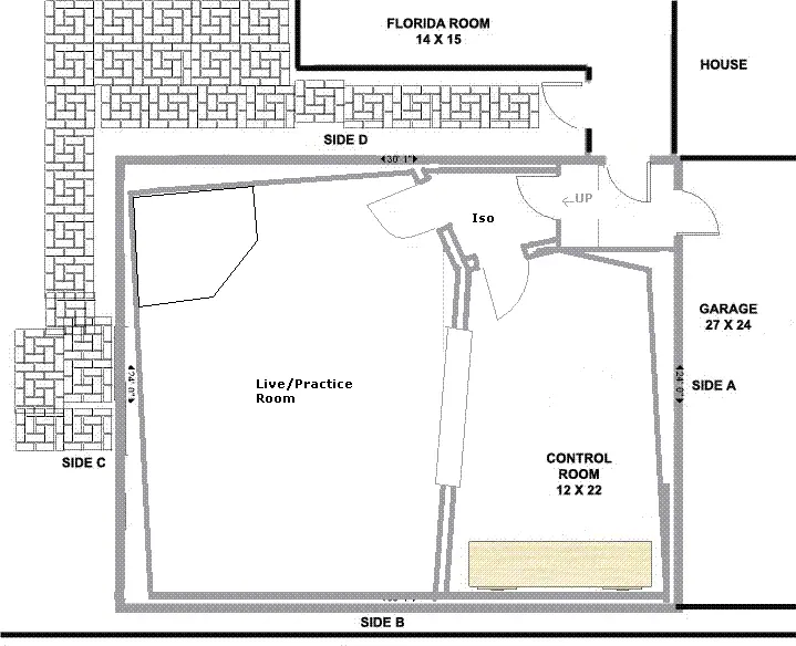

Here is my outline of proposed Studio: (furniture not to scale)

Here is the latest upgraded design/layout based on recommendations from here, and also John Sayers site.

My redesign. You might want to make the vestibule/iso a little larger and the control room a little shorter.

Thanks for the input and I understand the un-paralleled walls concept and I will probably consider using that.
The wall space between the exterior wall and the interior walls is only going to be about 5". My drawings arent to scale. (I WOULD like more room though in the tracking "live" room if possible,,,another 2 or 3 feet deep would be nice) ;)
A couple questions though,,,,(and thanks for your drawing by the way, good ideas on it) ;) but,,,, arent the red arrows I put on the drawing what you would call "coupling points" connecting the exterior wall with the interior, thus making it a place for sound transmission??
What do you use to place between the studs and facings at these locations to isolate them?? Is there something out there that actually works,,,or is plain AIR and SPACE the best choice?
And the blue arrow, is that to represent a drum riser in the corner?? And if so, wouldnt it be better to have it in the other corner so its projecting away from the neighbors side of the building?? I know the drums sound will go in all directions, but I thought they would project more from the front>?>?
oh yea,,,and why would you place the mixing desk off to the one side wall instead of in front of the window as I had it?? Just curious>?>? Isnt it better to be able to see the people your recording while your tracking?? :confused:
Thanks again and Peace
Aj :cool:

Ok,,,I hope this isnt tooo long winded, but I have collected the advice and suggestions thus far and here is what I came up with. (and I apologize for it being all caps below, I typed it up that way in MS OFFICE WORD when i did it)
I am hoping for more input from some of the others on here who are well-versed in this area.
So far this whole studio idea has changed from the first drawing, and I am lovin it every time, because it seems to get soo much better. Thanks again for those who have responded.
Anyway, here is the run down. And please feel free to correct anything that I have listed that needs changed. I am a newB at this all and am learning as we go. There are also questions throughout that I still have.
PROPOSED STUDIO – PLANS, CONCERNS AND ISSUES
1- THE STUDIO WILL BE DESIGNED AS A HOME RECORDING STUDIO THAT WILL BE BUILT WITH THE POSSIBILITY OF A LATER CONVERSION INTO A FAMILY/GREAT ROOM AREA.
(SINCE IT’S NOW ATTACHED TO THE HOUSE, AND NO LONGER A SEPERATE BUILDING)
2- THE STUDIO IS PROPOSED TO BE 24FT WIDE X X30FT DEEP (POSSIBLY 31FT DEEP) IT WILL BE BUILT AND VIEWED AS AN EXTENSION OF THE GARAGE ITSELF IN ITS FRAMING AND LOCATION.
3- THE STUDIO WILL BE ATTACHED AS “AN ADDITION” ONTO THE HOUSE INSTEAD OF BEING A SEPARATE BUILDING. THIS IS DUE TO RECOMMENDATIONS FROM THE BOROUGH OF CARLISLE AND THE VARIANCES NEED TO DO OTHERWISE. THE ONLY COMMON WALL WITH THE HOUSE WILL BE THE GARAGE (SIDE A).
4- ATTENTION AND CONSTRUCTION HAS TO BE BASED ON THE FACT THAT THE ONE NEIGHBORS HOUSE IS ONLY 20FT AWAY FROM PROPOSED STUDIO SITE. ISOLATION MUST BE THE PRIMARY FACTOR WITH BUILDING. THERE WILL BE NO FRAMINGS FOR ANY DOORS OR WINDOWS ON THAT SIDE (SIDE B) OF THE STUDIO. IT WILL BE KEPT SOLID.
5- THE STUDIO WILL HAVE A “BOX IN BOX” TYPE CONSTRUCTION (ROOM WITHIN A ROOM, TOTALLY UNCOUPLED)
6- THE STUDIO WILL BE STICK BUILT OUT OF 2X4X8 STUDS. IT WILL BE FRAMED STRAIGHT WITH ALL 2X4’S– THERE WILL NOT BE STAGGERED STUDS ON A 2X6.
7- THE STUDIO WILL HAVE EITHER SCISSORS TYPE, OR BARN STYLE TYPE TRUSSES FOR THE ROOF, THIS WILL ALLOW ME TO HAVE A HIGH PEAKED ROOF (INTERIOR CEILING) THAT SHOULD BE ABOUT 1 ½ TO 2 STORIES HIGH AT THE PEAK. THE CURRENT GARAGE ROOF IS 2 STORIES HIGH WITH A STEEP 9/12 PITCH.
8- THE WALLS ON SIDES C & D WILL HAVE FRAMED OUT PLACES FOR THE LATER INSTALL OF A SLIDING DOOR AND WINDOWS. THESE DOORS AND WINDOWS WILL NOT BE INSTALLED UPON THE BUILDING OF THE STUDIO, AND THAT OPTION WILL BE RESERVED FOR WHEN/IF THE BUILDING IS TRANSFORMED INTO FAMILY/GREAT ROOM DOWN THE ROAD.
9- FOR MASS TO HELP WITH ISOLATION OF SOUND, THE STUDIO WILL HAVE AT LEAST 2 LAYERS OF DRYWALL (POSSIBLE 3) ON ALL THE INTERIOR WALLS AND CEILING. THESE LAYERS WILL BE INSTALLED IN AN ALTERNATING FASHION SO THE JOINING SEAMS DO NOT LINE UP (FIRST LAYER WILL BE UP AND DOWN, THE SECOND WILL BE SIDEWAYS, AND THE THIRD WILL BE UP AND DOWN AGAIN ETC – OR IS IT BETTER TO HAVE THEM ALL INSTALLED UP AND DOWN THE SAME, AND JUST STAGGERED WHEN MOUNTING THEM SO NO SEAMS LINE UP??)
10- THE STUDIO WILL HAVE A TRACKING “LIVE” ROOM, ALSO A SEPARATE CONTROL ROOM, ALSO 1 ISOLATION BOOTH (ROOM), AND A SMALL FOYER “SOUND LOCK” HALLWAY AREA.
11- THE STUDIO WILL BE BUILT ON A 6” CONCRETE SLAB. NO FLOATING FLOORS, (BUT POSSIBLY ISOLATED SLABS AS NEEDED>?>?) THIS FLOOR WILL BE REINFORCED USING REBAR IN IT, ALONG WITH FIBERMESH TO REDUCE THE CHANCES OF CRACKING>?>?
12- THE INTERIOR FLOOR WITH NOT BE COVERED WITH WOOD OR CARPET, BUT INSTEAD BE ACID STAIND AND SEALED FOR A SMOOTH MARBLE LOOKING FINISH. FLOOR AREA RUGS WILL BE THEN USED THROUGHOUT AS NEEDED.
13- THERE WILL BE NO DRUM RISER BUILT WITHIN THE ROOM AT THIS TIME.
14- THE STUDIO WILL HAVE 32” AND/OR 36” SOLID CORE DOORS USED THROUGHOUT THE ENTIRE BUILDING. THESE DOORWAYS ARE TO BE SEALED DOORWAYS AROUND THE DOOR PERIMETER AND UNDER THE DOORS.
15- THERE WILL BE A “SOUND LOCK” (FOYER) AREA BUILT AT THE STUDIO ENTERANCE. THIS WILL PREVENT ANY COUPLING OF ANY INTERIOR WALLS WITH THE EXTERIOR WALLS, TO AQUIRE THE BEST ISOLATION POSSIBLE. THERE WILL BE A 3RD DOOR IN THE SOUND LOCK AREA TO ENTER INTO THE CONTROL ROOM.
16- A FABRIC TYPE MATERIAL WILL BE ATTACHED ONTO THE 5” END WALL SPACE OPENINGS IN THE SOUND LOCK / FOYER AREA (TO THE RIGHT AND LEFT OF THAT ROOM) THUS NOT COUPLING THE INTERIOR AND EXTERIOR WALLS ANYWHERE THROUGHOUT THE STRUCTURE, AND KEEPING ANY INSULATION FROM ENTERING THE AREA WHERE WE WORK, PLAY, LIVE AND BREATHE.
17- IN ORDER TO KEEP THE ROOM “TRANSFORMABLE” FOR LATER USE, THE INTERIOR TRACKING ROOM WALL (SIDE B) WILL BE SLIGHTLY ANGLED ON A CENTER OUTWARD PEAK, SO IT’S NOT PARALLEL WITH THE SIDE A,C OR D INTERIOR TRACKING WALLS. ALSO THE SIDE A AND C INTERIOR WALLS FACING EACH OTHER, WILL NOT BE PARALLEL EITHER WITH THE SIDE A ENTERANCE AND ISO BOOTH CONSTRUCTED AS SHOWN IN THE DRAWING.
18- THE SIDES C & D WALLS WILL BE THE ONLY FLAT STRAIGHT SURFACED WALLS. THIS IS ALSO FOR LATER EASE TO CONVERT BOX AREAS FOR THE FRAMED WINDOWS AND DOORS ON THOSE SIDES. (GOTTA KEEP THE WIFE HAPPY)
19- THERE WILL BE A THICK DOUBLE GLASS WINDOW BETWEEN THE TRACKING ROOM AND THE CONTROL ROOM. THE WINDOW PANE FACING THE TRACKING ROOM WILL BE ANGLED. (OR SHOULD BOTH BE ANGLED)??

HERE ARE 2 DIAGRAMS. ONE IS THE LOCATION OF THE STUDIO REFERENCE THE HOUSE AND NEIGHBORS. AND THE OTHER ONE IS A CLOSE UP OF THE STUDIO LAYOUT AND DESIGN SO FAR.
I AM STILL WAY OPEN FOR ANY AND ALL SUGGESTIONS, RECOMMENDATIONS AND CHANGES???

How do you propose to reconcile a "room within a room" with this roof? In other words, how are you going to build a ceiling that is decoupled from a trussed roof? Just curious.
fitZ
correct, so you usually have a decoupling filler, like a neoprene gasket, for at least part of the gap. For someting put together with paintbrush I couldn't get that detailed. But it is a good sign that you are thinking about the little details.
Indeed drums radiate in all directions, the only one that is sort of directional is the kick. Now if you decide instead of a riser to have some sort of drum enclosure or gobos you would want it on the away side.
During mixing you want the room to be symmetrical around your monitors and it is considered best to have them centered on the LONG axis of the room. True this means that you will be looking over your shoulder at the musicians but honestly there won't be that many cases where you need to make eye contact. most of the time you will be looking at your display and control surface.

THE DISECTED WALL DIAGRAM FOR THIS STUDIO’S WALLS AND CEILINGS WILL BE:
(EXTERIOR TO INTERIOR - and see diagram below):
STUCCO ON OUTSIDE FACE
OSB 7/16 EXTERIOR SHEETING
2X4X8 STUD WALL FRAMING
UNFACED INSULATION BETWEEN STUDS
EXTERIOR WALL INSIDE FACE WILL BE LEFT EXPOSED
A 5” AIR GAP ALL THE WAY AROUND (ROOF AND SIDES)
2 X 4X8X STUD WALL FRAMING FOR INTERIOR WALL
(POSSIBLY MORE INFACED INSULATION BETWEEN THESE STUDS AS WELL ??)
2 OR 3 LAYERS OF 5/8 SHEETROCK
ALL SEAMS SEALED WITH ACOUSTICAL CAULKING
INTERIOR WALLS THEN PAINTED
five inches is larger than normal on the air gap. If you really want to use an air gap that large you might want to consider an inside-out construction for the interior wall.
(ALSO – JUST AN FYI NOTE: THERE WILL BE BROADBAND ABSORPTION PANELS (4X8 703 FRAMED PANELS) THROUGHOUT THE STUDIO AND CORNER BASS TRAPS. (UNDERSTANDING THIS IS NOT FOR ISOLATION, BUT ABSORPTION PURPOSES, JUST WANTED TO NOTE THEY WILL BE USED.)
Or use the inside-out constuction of the interior wall.
Larger than normal? I was under the impression that the airgap was measured from the cavity face of the drywall of one leaf to the same of the other leaf. If a standard stud is 3 1/2", a 5" gap wouldn't even include the other wall cavity. With 1" between the two wall frames, that would be an airgap of 8". BTW, better check with your local building authority about FIRESTOPS within these airgaps. :)
fitZ
I was planning on stick building the roof trusses on the inner room, keeping it also 5" from the exterior ceiling (totally not tied in). So I basically have 2 complete seperate buildings. Or is this a no-no??
As for the 5" gap, I was under the impression that the bigger the gap, the better the osolation. So, I was going for the approach of 31/2" stud walls,,,,5" gap,,,then the interior 3/12" walls this giving me a total "Air Space" of about 12">?>?
