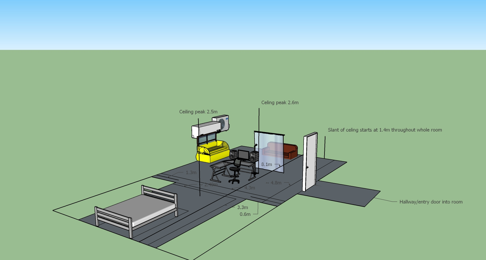

A floor diagram rather than a lot of dimensioned photos would be easier to see stuff. With the L-shaped desk you may be getting more desk reflections on the left side, making for an unsymmetric listening field. With carpet and all the furniture, you're absorbing the high frequency reflections, but not the low end, so you need to make/buy some bass traps for as many corners as you can.
Hi Mike,
Thanks for your reply -
Ive done a very quick sketchup diagram of the room to reference with the photos.
Image is attached, or you can download the sketchup file here:
Download
Hope this helps,
Aaron

Hello AB5150, and welcome to the forum. You'll find a lot of useful information on these pages. Read the "Sticky's" I learned a lot from them.
As for your room, (I'm no expert) but I'd think that placing your desk about 4' or 3.?m from wall facing long ways on the widest end (looks like there is a sofa there) would be optimal in your situation. Put traps in those corners behind the desk, and some broadband absorbers on wall behind the desk.

Hi, thanks for your reply :)
Very useful info.
Just to be clear, were you referring to the yellow or the brown couch?
Cheers
The brown couch. Bass traps in all corners you can do, and a ceiling cloud trap (at least 2" thick OX703 or Roxul), too.
