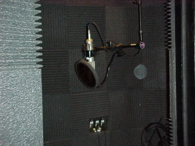

New Studio
Just Redid Studio Comments Please Need A Boost Or Something Like That Was A Lot Of Work

nice....say....got any more of that foam left that i can use so blue bear and co. can quit laughing at me? lol
Hey -- that looks like a lot of work! :D Looks great! What mic is that?
U 87 Have More Pictures Of The Control Room And Tracking But There To Big 1.5 Mb Do You Now To Compress Them Without Distroying Them To Much To .65MB Or So Thats All They Will Let Use Here

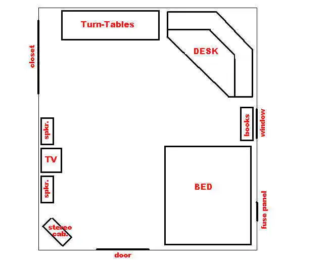

Hello thane1200
That SHOULD be your first priority. The two shelf units on the desk top should be moved in favor of the monitors. I mean, how do you determine a stereo image with this configuration? Also, mixing in a corner is the WORST place you can mix because that is where room modes terminate.
fitZ
I know this is not the optimal set-up but i am limited to the space. There is a window on the wall directly right of the desk as well as a breaker box, thus I am unable to use that wall. The wall directly left of my turntables has a closet which I cannot block. And lastly the wall behind my turntables is very narrow and has a door. Also the MKII's are currently being used for DJ monitors and do no good on the desk anyway. If I get a blueprint of my room posted maybe we can come up with a better idea.
Thanx
Thane,
Rick is right in that your placement of your little white speakers there will probably hurt your perception of the stereo image, but here is an idea for you. A pair of cheap, $35 wall mounts for those speakers. They are small enough that the units they have in Lowes or Home Depot should support them no problem, and mount those speakers to the side of your hutch, facing you. This way you're not giving up valuable desk space, but increasing your ability to perceive stereo imaging.
Just an idea... and a not so expensive one either...
You keep forgetting one important thing:
Dance music is MONO! (which is obviously what he's producing)
In a club or bar, there are way too many speakers to have a stereo image. Also, you don't wanna dance near those speakers where the vocals come out, while others dance near the speakers where the lead synth comes out. That'll be weird, right?
Experienced dance music producers hence produce in mono. :eek: :eek:
I therefore don't really see a big problem with thane1200' setup.
good one!
frederic said:
Thane,
Rick is right in that your placement of your little white speakers there will probably hurt your perception of the stereo image, but here is an idea for you. A pair of cheap, $35 wall mounts...........mount those speakers to the side of your hutch, facing you. This way you're not giving up valuable desk space, but increasing your ability to perceive stereo imaging.
I've never thought to do that. Good idea! Thanx guys, I know that BestBuy and WalMart both have those for under 25$.
> stereo < is our friend
I just whipped up a quick lay-out of my room. This shows how limited the space is. Any suggestions on re-arrangement, monitor placement, acousitcs, etc. would be appreciated. Thanks to frederic for the speaker mount idea. Any other input would be great.
~thanx for the help
-thane
