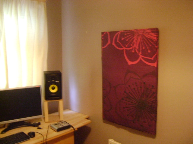

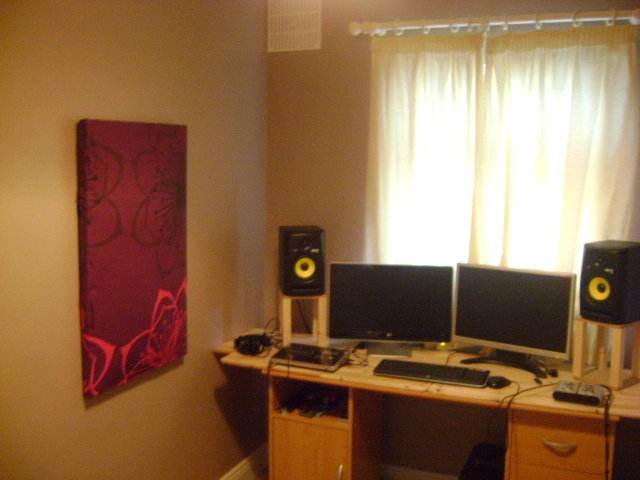

Ok I've taken some advice and changed my room around, I've set up my speakers and listen position correctly, each spaker is the same distance from the wall and pointing at my listening position at ear level and my listening position completes the equalatiral triangle, here's some pics to show where I'm at.
In these 2 pics you can see where I've put my absorption panels for early reflections. I sat in my listening position and got my missus to run a mirror along the wall to the point where I could see the opposing speakers tweeter and this is where I hung the panels.

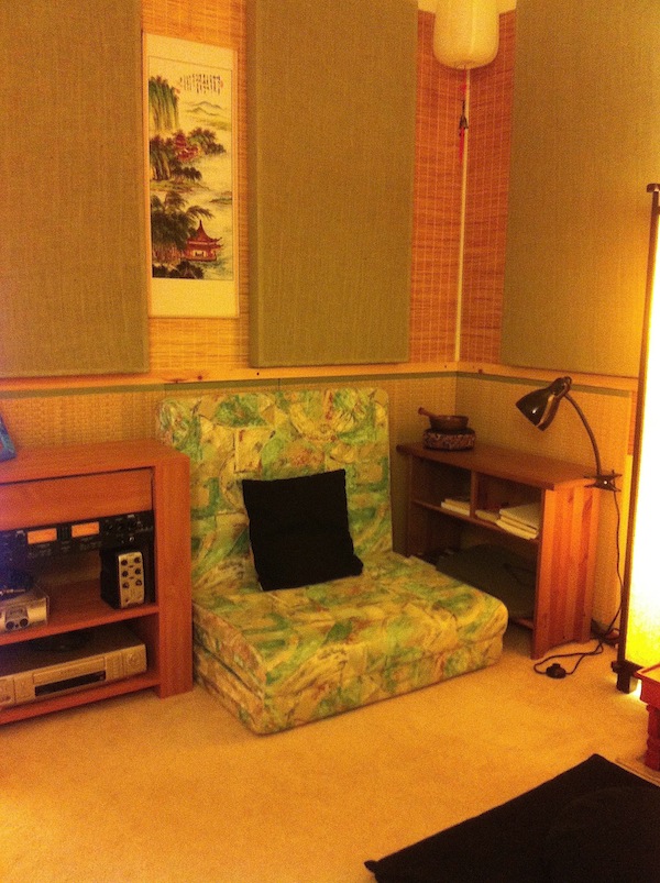

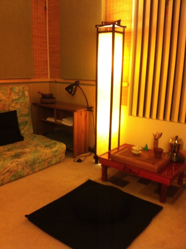

I just recently did some rearrangement in my spare room. Since this room is used as my study, as music room, as tea ceremony room, a yoga and meditation room, I did not want it to look like a music studio :)
This is a pretty small room with no parallel walls. The entrance door is parallel to one of the walls, but I got it treated. It is 8' high, has carpet and "popcorn" ceiling. I plan to test it and decide if I need a cloud or not.
Now I am in a process of making 2'x4'x4" Roxul GOBO's. I wanna make them look like Japanese shoji screens :)
Instruments I will be recording are Shakuhachi flute, Native American flute, Chakra Chimes and Tibetan singing bowls, didgeridoo, Udu drum and possibly Cajon. Other instruments are Akai EWI USB, Yamaha DGX-202
I use MacBook Pro + GarageBand, Cubase 5, Logic Express, Real Guitar 2
Mics: AKG c414 XLS, Rode NT3
ART Pro MPA II Mic pre
Lexicon Lambda USB interface
Headphones for mixing… at this time at least :)
Here's my humble space. Lower part of the wall is covered with 3'x3' tatami pads (about 1/2" thick)

Of course, my tea table :)
This is a view from the window in front of the tea table.

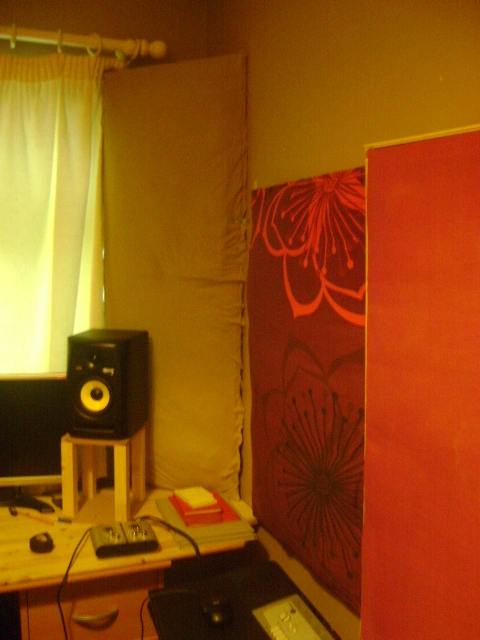

This is how my room looks now, I have built 2 bass traps for the corners, I built a 2 frames, 15" against both walls and joined across then I wrapped the frames in sheet and filled with rockwool loft insulation, wat I did with the insulation was roll it out and cut it into triangles and stacked the triangles on top of each other in the trangular frame, then i mounted them in the corner of my room behind the monitors, I have 2 absorbtion panels on each side wall in the reflection points both 4" deep of rockwool loft insulation.
Bass trap left 2.webpBass Trap left.webpBass trap right 2.webpBass trap right.webp
View attachment 72821View attachment 72822View attachment 72823View attachment 72824
Sounding any better?
If you have any open cell foam that is on the denser side, I'd suggest placing it under your monitors, since right now, they're just sitting on a wooden stand which is also on a wooden desk. So the sound from your speakers will vibrate right through the stand and the desk, coloring the sound. You could go the lazy way (instead of trying to find some foam free somewhere) and just buy these.
Yeah room sounds much better, much tighter on the low end, a lot less wooly if you know what I mean, also not too dead. Yeah I'm gonna sort out everything on my desk with stuff for anti vibration. I've done everything diy so far, just trying to get the sound right and then I'm gonna sort out how it looks. First thing I'm gonna buy for aestics is gonna be a lava lamp.
