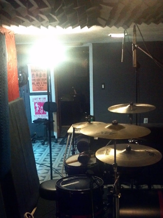

Haven't posted any pics in a while. Some new additions over the past year or so. This shows a lot of the bass traps too.

you cant really see them very well but behind the drums and the desk there are floor to ceiling superchunk corner traps.

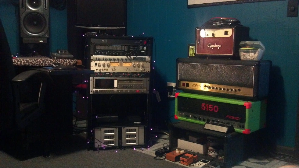

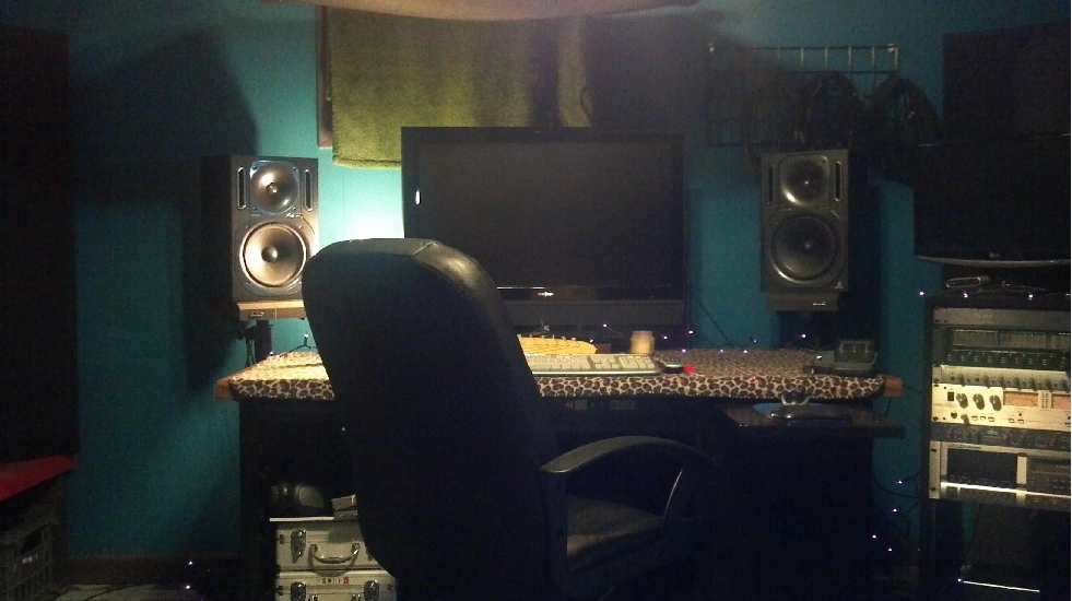

Long time admirer of this thread. Just moved and setting up the new space has been tedious yet exciting. Thanks for looking!

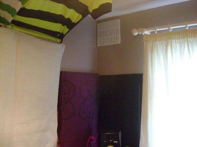

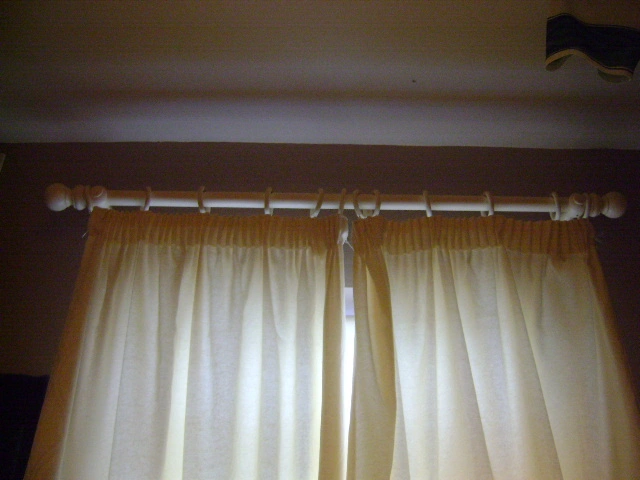

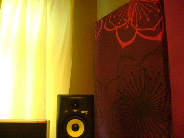

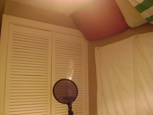

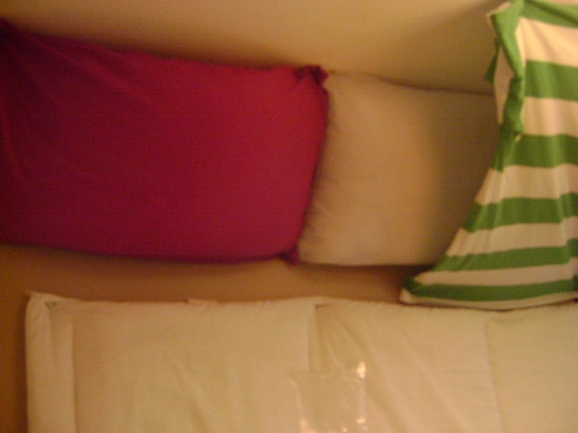

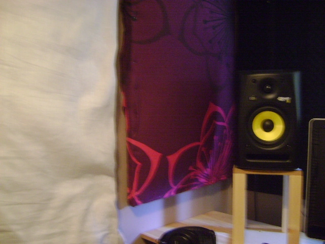

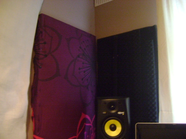

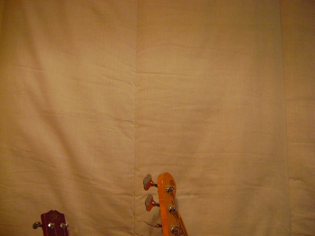

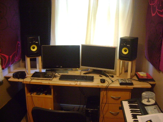

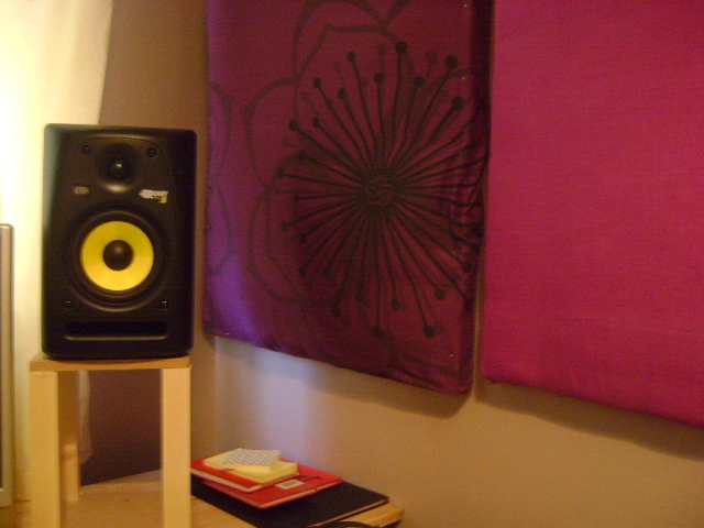

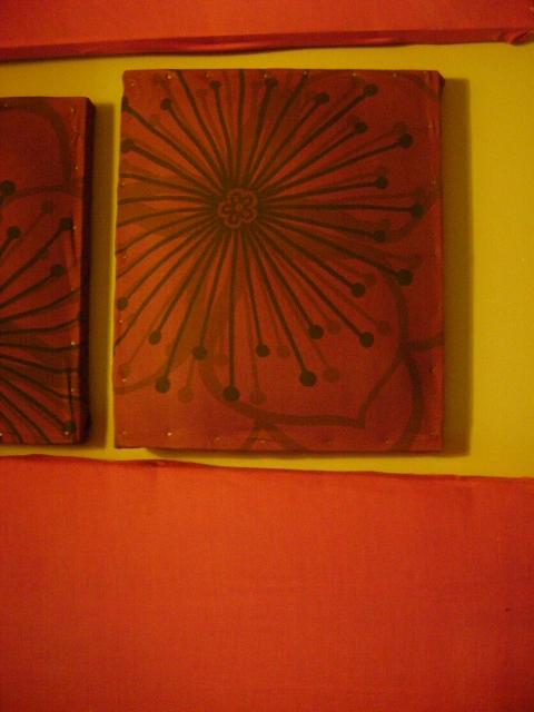

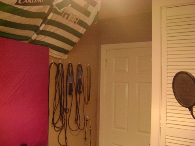

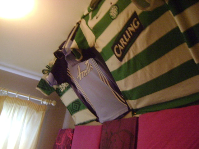

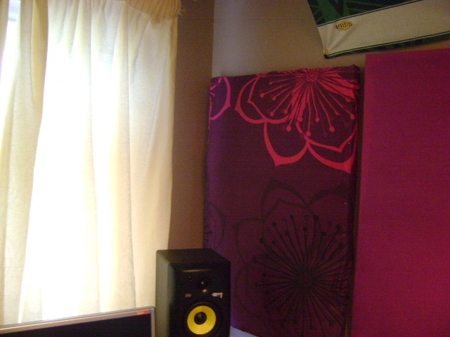

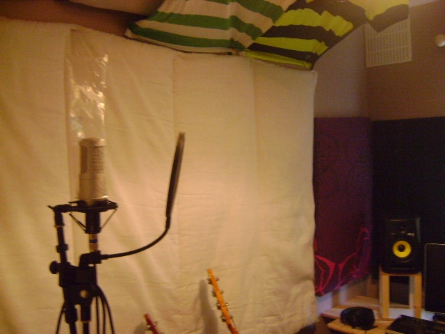

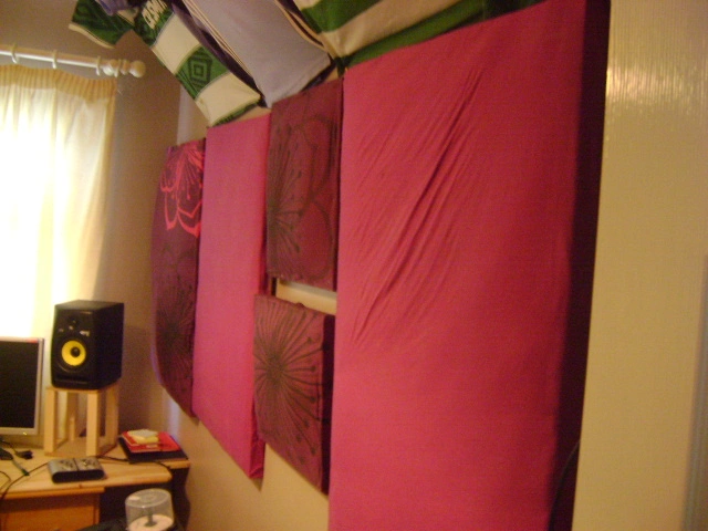

This is my set up, Has anybody got advice for acoustically trating this space better, I know its a very small room, but its all I have, My speakers ar set in the best positon possible, their both equal distance from side wall and my listening postion is at the apex of the triangle.
Sausy is it super dead in there and do your mixes have tons of treble when you listen to them elsewhere? Just curious because you have tons of high-frequency absorbing materials, but the pillows will likely do not much for your bass absorption (biggest issue especially in a small room). I doubt the jerseys are doing anything at all. I suggest taking everything down, get some good bass trapping in all four corner (in your case you might only have room in the 2 corners behind the desk). Look up super chunks or how to build a bass trap panel and straddle it on your corners. Then add your mid-high frequency absorption as needed. Mostly, next to each ear (side walls) and on the wall you're staring at. Those are the most import for the mid-high.
Note, a pet peave of mine has always been dangling mic cables when they are plugged into the mic...especially if it's there all the time, permanently set up! I'm always so annoyed when my singer sets up his stuff and never does that. Even though he plays keys and has a boom stand hovering over his keyboard rig, he has the #!@#ing cable hanging there right onto the keys!!! Haha, sorry, just so annoying to me. And dangerous. Wrap those suckas around! :P
Good advice. Everything he said there is true.
Saucy, for now you can take the panels that you have meeting each other in the corner and, instead, have them straddling the corner, one on top of the other, or rather, one in front of the other, if you know what I mean (double up their thickness is what I'm trying to say).
In any room, but especially a small room, the corners are the most important thing to treat for starters.
Thanks guys, great advice. This is why I put up the pics, I'm planning to re-arrange everything this weekend, I'm gonna take a lot of it down as it probably is too dead, and I'm gonna get some rigid fiberglass panels and make some bass traps for the corners behind the speakers and for the point where the wall meets the ceiling, the jerseys are just asthetic tho.
Rami do you mean I should use the absorbtion panels in the corner at an angle rather than flat against the wall? Would an absorbtion panel over my head be benificial?
Thanks man, not the first time you've given me sound advice, appreciated.
