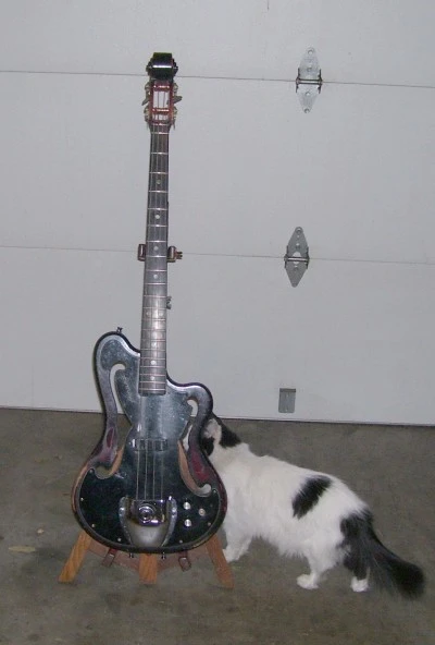

I think I'm off today (no one has called wondering where I am) so I took some pics. Here it is getting the "new thing inspection" by one of our three cats:

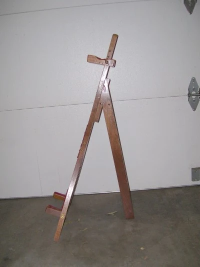

Just the stand:

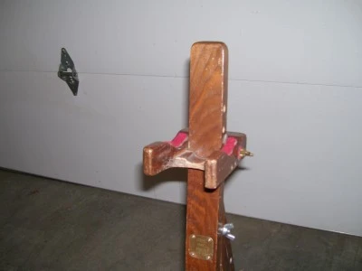

Here's the top of the stand. Note the carved-out dip to make room for the strap bolt thingy:

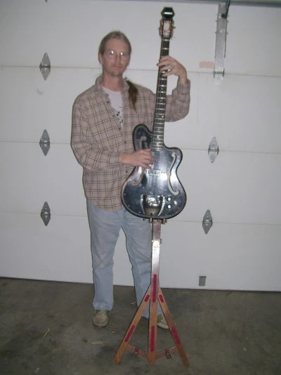

Last one. Me playing it upright style. My ampeg has two strap bolts so it's offset a little to one side.
Oh -that is genius!! :cool:
That's exactly what I mean....and I love that it serves double duty so elegantly!!
....if you're ever looking to knock off another one of those, I'd be first in line!! Barring that, would you mind if I tried to copy it? That's just perfect - great idea and execution! :cool: :)

Knock yourself out man. It's rather low-tech. I used a 3-inch bolt and a wing nut to mount the "leg". I have to remove the bolt, flip the leg around and put the bolt back in so the leg fits flush against the body.
The wood was from an old thick plank of walnut finished with tung oil. A neighbor cut it into strips for me.

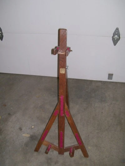

Do you have any shots from side, or back? I can visualize it, but it would cool to see that too if you have it... :)
It looks like the post is drilled, and the bolt and wingnut hold the top in place....but I'm unclear on exactly how where the back leg connects....another bolt and wingnut?
Side view when in "operational mode":

Another side view showing the rail with 3 holes for the leg. It bolts to one of the 3 holes. The top hole lets it lean back the farthest and is the most stable. Three holes is probably overkill.
The leg is just there to hold it up for the picture view.
