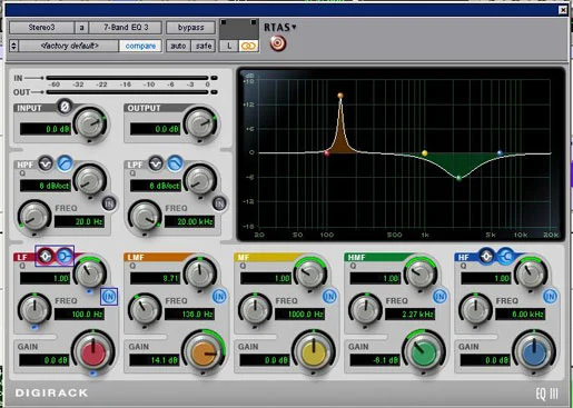

narrow boost would mean amplifying a portion of the EQ plugin and setting the Q to narrow. The Q changes the range of frequencies you boost. If you use a "wide" Q you are effecting lots of frequencies...if you use a narrow Q (cutting or boosting) you can effect only a few frequencies. Basically a narrow boost will graphically look like a sharp peak.
below is a pic of a graphical EQ. The orange boost is narrow, while the green one is rather wide. The terms are pretty self explanatory.
sweeping means just moving the frequency the boost is at, back and forth slowly until you find the frequency you're looking for. A lot of people do this when they're looking for a problematic frequency. When you finally come across the frequency while sweeping it, all of a sudden you'll hear it increase in amplitude fairly dramatically...so then you know that's the frequency you're looking for. I do this a lot when there seems to be a high pitched squeal coming from somewhere. I'll sweep the upper 15kHz range and when I find it, I'll just reduce that narrow frequency range by several decibels and adjust the Q as needed so that the frequency starts to go away.
A lot of times sweeping the EQ takes a good ear as well. You have to be able to recognize when you've got the pitch you're listening for. This has a lot to do with your ability to know an in-tune note from an out-of-tune note.
