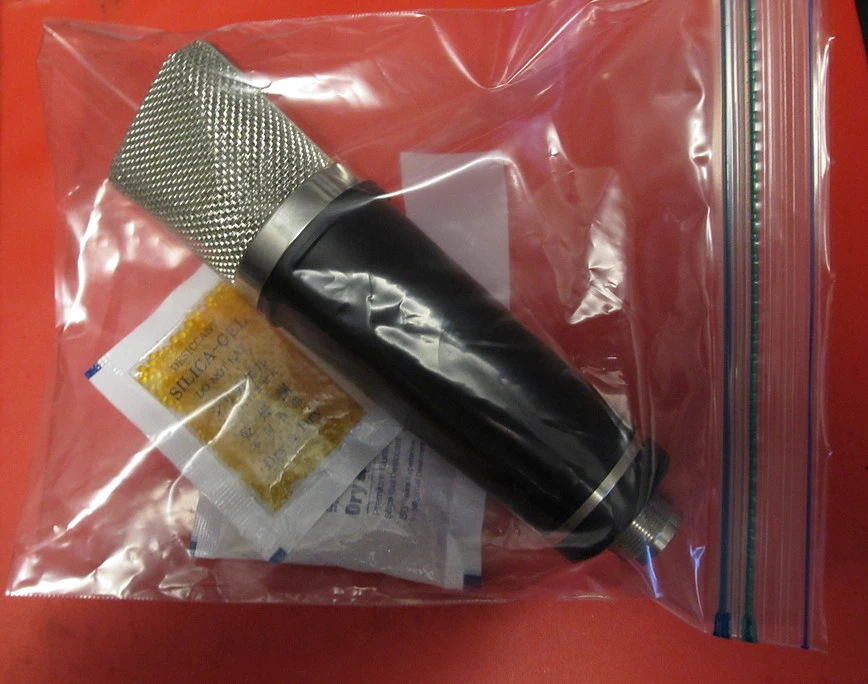

Any chance the mic has been exposed to damp air/humidity? Brought (transported) in from the cold into a room that has moisture in the air? Similarly using a condenser mic without a pop filter, it's possible moisture in ones breath to get on the mic capsule and degrade the sound. Does the mic have more than usual background hiss/noise?
If it is moisture on the capsule, it usually can be dried out with desiccant packs and the mic in a ziplock plastic bag for a day or two.

If its moisture, you can also put it in a baggie with uncooked white rice to draw moisture out.

I hear differences - but what interested me were the plosives. In one the P's and B's (butterfly) were obvious, but in the other, we had the Ps but not the Bs. The breath intake was quite different too. My conclusion being that either the physical position to the mouth was different or the capsule is behaving differently - something is indeed wrong and I think the idea of warming it would be my starting point. A couple of days in a boiler room type warmth would be my first call - mainly because I don't have any desiccant.
