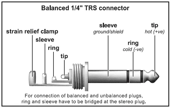

Sorry to be totally thick, but tip, ring, sleeve - how do you know which wire goes to which ?

Here's a picture.
