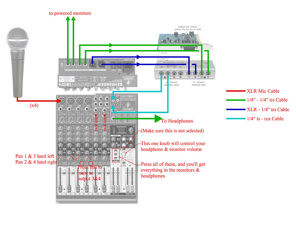

is this about right?
i would use the xenyx as a preamp and then just pan the different inputs separately and route them to as many different outputs as i can in order to send them to the inputs on the delta interface?

yup. lol pretty much, you got it. The trick with these small format mixers is figuring out how to pan and route everything to get there. Its like a eff'n puzzle.

see if this helps...
I can email a higher res image if you want. Some of that is tough to read.
You're still making it tough on yourself though by not getting an 8 channel interface so here's what I'd suggest.
Get a 4 channel interface (M Audio Fast track Ultra e.g.) and run your two main outs from the Behringer to lines 1 & 2 in the Fast Track. That still leaves you with 2 channels to play with on your interface.
Or... if you're only recording your kit, plug them directly into your interface.
Or.......... You have at least three pairs of lines out of your 1204. (I used mine for live sound today, by the way. I love it) There's your main XLR Outs,
Control room Outs and Alternate 3 & 4 Lines Out. There may be more, I'm going strictly from memory but what Jeff is basically suggesting is that you send a different mix to say the control room and Main Outs thus giving you two pairs of stereo lines out.

wow jeff, thanks so much, that totally cleared up everything. now i just have to decide if i want to go for the delta to try this out. i don't think i'd be able to spring for an 8 channel for a long time, so this might be my best option

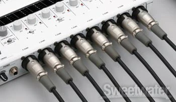

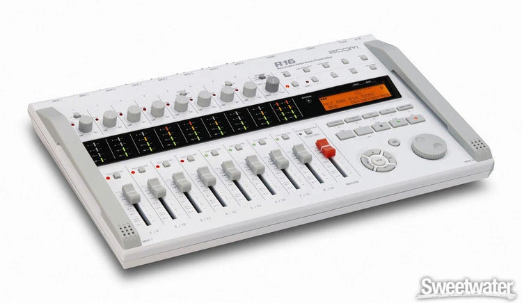

Well, I'll make the obligatory Zoom R16 recommendation.:o
8 channel mixer. 8 in 8 out functionality to your DAW. Also works as a standalone recorder that records to flash drive making it easy to drag and drop files to your pc.
It's a USB 2.0 interface, but I've had mine for over a month now, and I'm extremely impressed with it.:cool:
$399 @ Sweetwater.

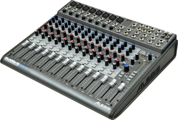

Alesis Multimix 16 USB - 16 individual tracks via USB to computer. You can get a smaller version too...

i think i may end up going for the multimix 8 instead of the firestudio eventually. what're the drawbacks of usb vs firewire? any?

haha yeah, i've got a desktop. and jeff - if i use that setup that you diagrammed out, would everything going into the delta be pre or post-fader?
