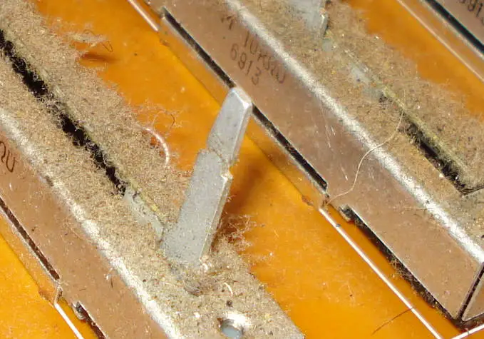

That's in case one may wonder why it (the legendary porta!!!, that is :D ) seems not to be good even for a demo ;)
This is TEAC-144,
Here's a high resolution shot: http://www.mzentertainment.com/photos/teac_144_dust.jpg
The problem is that (due to the way it is built, (and it is built WELL!)), in order to just see what's going on and in order to be able to clean all the pots of mixing section you must almost completely disassemble it. (here's how it looks: http://www.mzentertainment.com/photos/teac_144_parts.jpg )
And there's no way around it. Even if you get around opening the unit up and removing the face cover you still will not get there.
And you have to clean all the pots and sliders. I has to be done.
btw-1:
The little mixer is a killer there.
The recorder is cool, that's so if the transport works, of course , heh heh
btw-2,
I've made bunch of photos, when I get time, I maybe put together sort-of-step-by-step how to get to change a VU-meter, lamp, clean pots etc. It's a trip, I must say. We had a topic or two in the past in that respect as I recall.
Here's a "clean shot":

Yikes... I haven't had a 144 apart in about 25 years.
Hey Mike, those faders could use a little of this. :D
(unless it's cat hair... in that case you can save the $3.99 and lick it off) :p

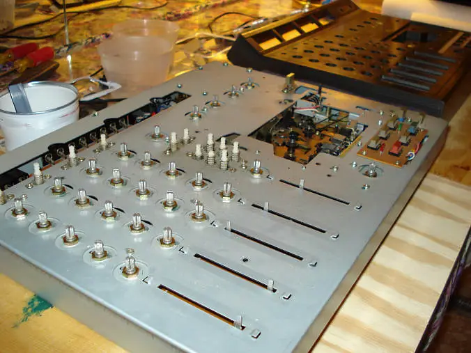

serious point, though, again, I just want to highlight. I am attaching another photo, that is when you take the face plate off. See how nice and clean it looks :), and on the bottom side there two layers of PCBs: Record/Play Amps/Dolby + Power Supply, and then inside there is the mixer's board. You can't see nor you can get to the pots from here. Spraying DioxIt through the holes here and there and around would not do good at all, actually it may make things worse ..heh heh
Does not 244 have the same (or similar) construction?
here's the "nice'n clean" inside (yet not so!) photo:

Yes, the early portas all have the inner metal chassis... but that's a good thing. It's sturdy and well grounded and shielded.
They should really come with dust covers though. I have a 20-year-old 246 that looks new inside and out, but I bought a custom dust cover from the (now defunct) Gotcha-Covered company at the time I bought the 246.
