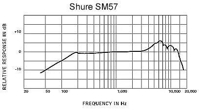

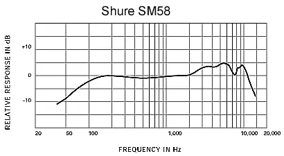

This might have something to do with it.
my understanding was always that the pop filter was the major difference, and that a 57 uncapped with one of those cheapo foamy windscreens was a pretty decent overall solution.
