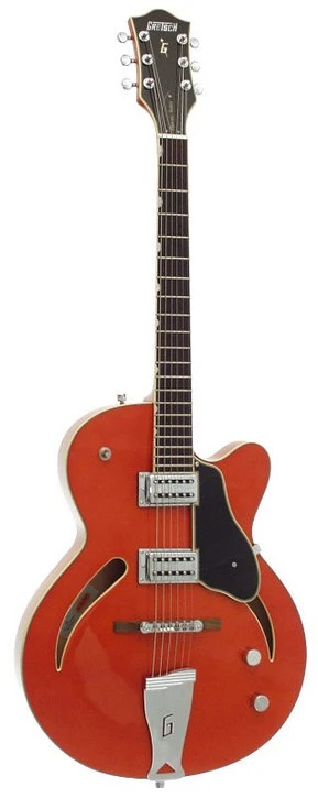

I have a question about it, but I need to know what kind it is first. Some type of Tune-O-Matic?

I'm not sure but I have an old Teisco (late 60s) that has one that looks very similar. Is the lower (wood) part free on yours? Mine just sits on the body.
Its an standard archtop floating bridge with hight adjuster wheels and a tun-o-matic on top.

Yes, it floats. I usually replace one string at a time, so I had no idea until last night when I took them all off to clean it up, and it fell off. :eek: :D
My question is: There's a small wire that holds the intonating screws in place. It's rattling, and IT MUST BE STOPPED!!
Does that wire serve any other purpose? Can I just wedge something in there to keep it from vibrating?
no other purpose ..... it just keeps the screws and saddles from falling off if there's no string on them. You could wedge something in there or you could bend that spring so it would hold itself in place more firmly or you could even remove it, which I did on one of my early Pauls although then every time you changed strings you'd curse and wail about the saddles falling off.

I had the same problem on my Les Paul. I pulled the spring wire out and bent it so it would sit more firmly on the screws, and put it back on. Prob solved.

Put a drop or 2 of Elmer's glue on them. If you need to adjust the intonation the glue will just peel off.
Funny thing about this story is, I was trying to adjust the intonation on the B string, but the saddle was backed all the way up and it was still out.
I almost posted a question of how to fix that problem, or even if it were possible to fix, but decided to replace the strings and give it another try. That's when the whole thing fell off. :D
Another question. On the saddle itself, it's angled on one side. One the top three strings they slope towards the neck, on the bottom three strings, they slope towards the bridge.
Why?

because they usually need the most adjustment in that direction for those strings. So the flat side of the saddle will get the furthest forward or rearward depending on which way it's turned.
