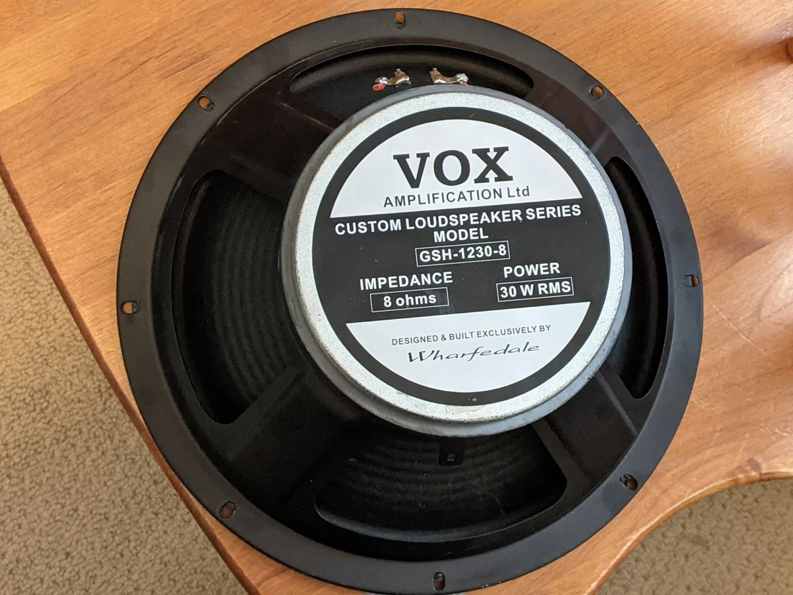

This one does not have celestions, Wharfdales?
this one I think.Found this yesterday.

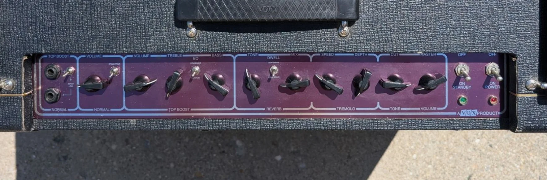

Control plate looks like this
I have waded through much of that link but found nothing to suggest the amps ever used Wharfdale speakers? I have never seen or even heard of a Wharfdale guitar/PA speaker.
Very early AC30s were loaded with Goodmans units but these proved a bit feeble and the swap was made to Celly blues.
Managed to find the above but they are just re-badged Fanes. Apparently though some guitarists did fit the hi fi speakers in their amps. I doubt they lasted any longer than the poorly rated Goodmans!
Re the "bias switch" in that link? I would never run modern EL84s at the 50 Ohm* setting, almost certain to redplate and die within days. Might take the GZ with them!
The very minimum for Rk I would use is 68 Ohms but much depends upon the actual HT voltage. Keep G2 feed Rs a minimum of 1k as well IMHO.
*Likely actually 47 Ohms. Even worse!

Apparently, the AC30CC2 from around 2004 used Wharfedale speakers. It was supposed to be their version of the Celestion "Anniversary" G12H-30. I don't think it was well received, although the people who replaced them get all the attention. Most people are probably like me, they just play their amps. It's like people who buy guitars and start replacing parts before they get it home! The last guitar I bought got a truss rod adjustment, and 6 months later, new strings!
That is certainly the Wharfedale typeface Rich. IIRC the Goodmans Audioms were also rated at 30W? I hope those Whaffs are better!
