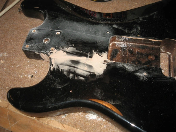

Had a bit of time this morning so finished filling the dings on the body and sanding them back. Looks a mess until I can shoot a white base coat later today. Then it will be the marbling process...

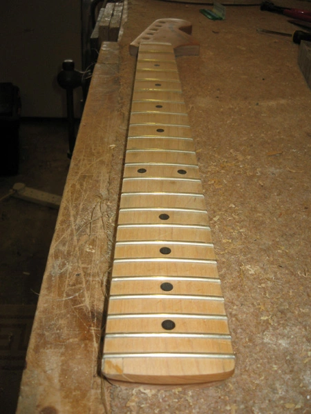

Also wacked some frets back in it. A much better fret job than the previous attempt I hope you'll agree. The polishing and final shaping will be done just before finishing.

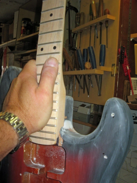

Checked that the neck pocket is still true and that everything lines up for the bridge when it goes back. Everything OK so far. About another 45 minutes spent today...

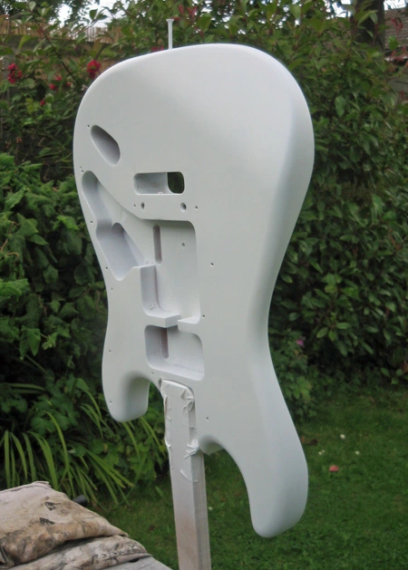

Shot a few key coats on it this afternoon. Did it in the yard as I didn't want white overspray all over the shop. Luckily the insects stayed away long enough. The thing is beginning to look like a guitar again.
Unlikely I shall be on it again until next week.

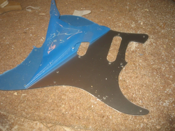

Still waiting for the marbling paint to arrive from Germany so looked into the fittings today.

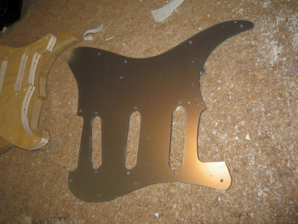

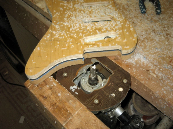

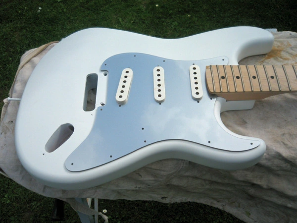

Definitely needs a new scatchplate and I don't want a stock one. A nice smoked mirror effect would be good and I have some sheet plastic thats just the ticket...
It's a standard strat pattern so I have the template to hand fortunately. A quick few minutes on the router and it's good to go...

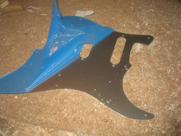

Peel back the protective film to see all has gone well with no "chatter"
Can't really see the colour
Hope it fits?
Yep, another 20 minutes well spent..
Hope it fits?

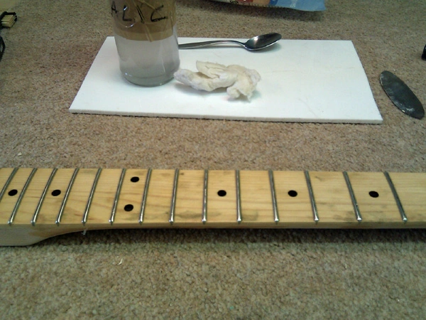

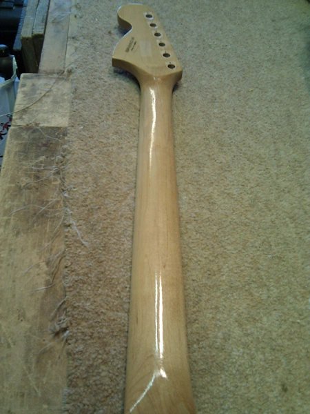

The neck was back together with new frets installed but had some nasty "iron" marks and other stains from it's previous neglect. A little oxalic acid solution and a light bleach should improve things?
Shot a coat or three of clear lacquer on it to seal it off.

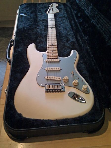

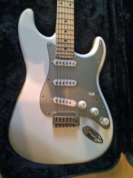

Before going further with the refinish I wanted to check how much of the original hardware could be salvaged. Cleaned all the rust off the parts and wired the sucker back up. Stuck on a set of strings and did the roughest of setups.
IT WORKS.... All parts operational and pickups still in tact. Sounds just like a Squ9ire strat...
Next up breaking it down again and doing a wacky paint job that the kids will appreciate..
Stay tuned.
I have the same blue handle chisels. I think they're older than me.
Great thread. :)
Those are the Stanley ones from the early eighties. Real work horses and good steel that holds an edge well. The recent Stanley stuff is nowhere near as good..
