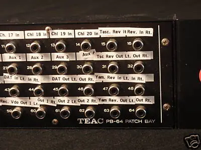

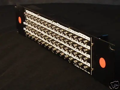

$55 shipped. They'll need some cleaning up (lots of labels), but I am gonna need something to bring the I/O panel 'round front on the M-520 because it will be pretty much inaccessible once I scoot it into position...plus I've got an acute case of patchbay envy after seeing post #15 in this thread... :D

Be careful what solvent you use to remove the tape with (try windex to start with) as that the paint can be removed....

I've been successful using iso alcohol to get label goo off of most stuff, but like the carpet cleaner says, "test in an obscure location first for color fastness".

Try goo gone for those difficult labels... but of course test first blah blah.
