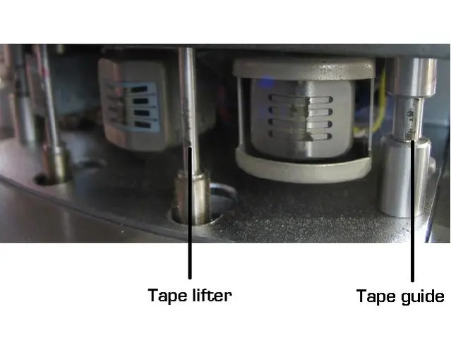

Tape guides and lifters below, were you able to get the gunk off ?:)

oh yeah..i thought you meant i needed to buy tape guides with the tape.

I'd use those cotton make up remover pads and alcohol [excess squeezed out] to clean not only the heads but also every thing the tape touches in its travel, which means all the dark, gunky stuff you see in the picts.
Do you have the manual? I found one online if you need it.
A couple of additional notes: Don't be afraid to apply gentle pressure and clean with the tracks and not across them [with regard to heads]. This appear to be caked on gunk so it may take a bit of time to do but once done, make sure everything is as clean as a mirror, including heads, tape lifters and all guides.
