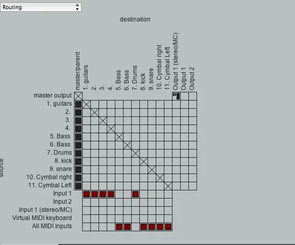

I'm not a pro at deciphering Reaper's routing matrix, but can you post a pic of yours for this project? I think that you can access it under the View->Routing Matrix menu item.
I didnt even know what that was or it existed haha, Looks like I still have a lot to learn about Reaper.
Anyway, there it is.

The routing matrix is a good way to take an overall look at your routing, just to make sure there isn't something goofy set up. Yours looks fine, as far as I can tell. No tracks routed directly to the master output, and no master routed anywhere other than the main stereo output.
This is a good quick tutorial on what the heck the diagram means: Reaper:Routing matrix
I'm really stumped here. If it's not the master effects, and its not any goofy routing, and it's not the rendering options...what the heck is boosting your rendering volume?
