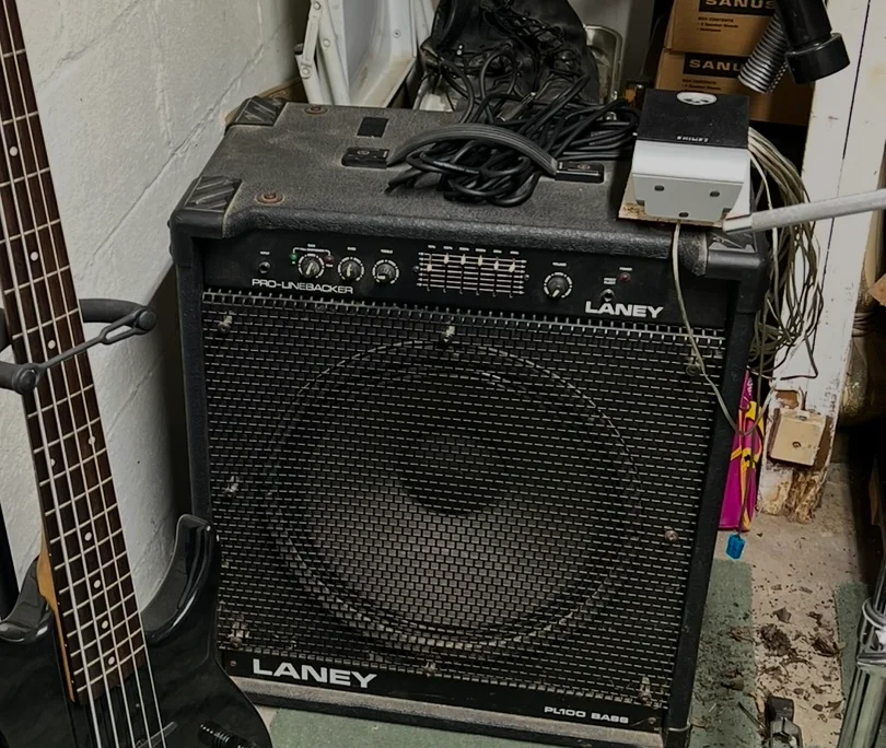

I have a Bass, I have Scarlett 18i20 and a preamp (Sansamp GED-2112) and some effects pedal which apply to these questions.
I am just starting out and at this point I have far more equipment than skills that would apply to this gear.
I have a 5 string bass and a 4 string, I'm told this 4 string very old, and the pickups are very good, the stamp on the head say AXL, whatever is says underneath that is unreadable, anyhow it sounds really good so I'm happy.
I started by buying some Bass effect foot pedals and hooked them all up, I'm happy. But then I bought the SansAmp GED-2112 preamp, When I looked at the back and said "ok now what?" This just got really complicated.

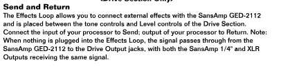

First I realized my amp has a "Send and Return" on the rear and an input on the front and is where I sent the pedal board effects chain and it sounded as I expected it to sound. Then it was described to me the GED-2112 is 2 preamps in one, the first being the "Drive' and the second being the "Deep" meaning it requires 2 input channels in my Scarlett. I'm ok with that, but I want to use the effect pedals I purchased. Since I'm sending 2 clean signals from that preamp to the Scarlett, I also want to mic the amp using a chorus and a 10 band EQ(more cuts than boosts) to my count now 3 bass channels I can blend together.
The problem I am having is 3 sets of sends and returns, 1 on the amp and 2 on the GED 2112. What Do I Do???

OK, maybe I am not getting it, but why do you want to DI the bass, why not just mic it? Why not split the input one DI and the other mic'd? Or, just play it twice and blend how you want it to sound. I mean, it is digital, you have as many tracks as you want.

Honestly I really don't know, I'm more confused with the signal chain. I bought some gear and want to use it or at least try, lets call it a learning phase.
As I describe my amp has a send and return but someone told me to just use the input on the front, if that the case then why does it have so many options?
In addition it has a "Direct inject" on the front and "DI" on the back, and gain is also a Compressor when pulled out. I didn't really need the SansAmp what attracted to me was the parametric EQ it has. This is where it gets crazy at least in my mind, (I'll remind you I have no clue, I've only had a small practice amp before I picked up this amp) So the DI is the SansAmp right? I'm guessing here, so I add a "Chorus" using the "send and return" or the "Direct Inject"?, that sound would come out of my speaker and would be mic'd. Then how can I add the DI's tone capabilities to the amplified sound?
In addition the DI has 2 pairs of "send and returns" one for the Drive and the other for the Deep and then XLRs for both to travel the distance to my audio interface, these signals would not have the effect applied, probably a poor example of wet and dry signal.
Please note the effect "chorus" is an example effect and wont be on full time, it's just a momentary effect but I want to hear it live when I stomp the switch. Also I do know effects work better before amplification
I see you have EQ on the amp itself.
You have lots of routing options, but you don't have to use the sends and returns.
If you put the effects between guitar and amp input, they're going to come out of the amp speaker, and also the DI output.
So you have a choice of micing the speaker, or just connecting the DI to your interface.

Here’s the thing, I understand using separate channels to do different things, I have basic stuff fairly mapped out (cabling usb, midi, xlr between drums, strings, keyboards vocals, I just have an issue understanding “send and return” it doesn’t make sense to me, if there is jack titled “Send” am I sending a signal to the send or is that jack where you send a signal somewhere? “Return” seems like it is referring to an output that goes to an effect pedal’s input jack, so then if that is correct, send is an input right? If someone can tell me Send is an input and return is an output I’ll be alright.
Send>>>>>>>>>>>Effect Input-----Effect Output>>>>>>>>>Return

I just have an issue understanding “send and return” it doesn’t make sense to me, if there is jack titled “Send” am I sending a signal to the send or is that jack where you send a signal somewhere? “Return” seems like it is referring to an output that goes to an effect pedal’s input jack, so then if that is correct, send is an input right? If someone can tell me Send is an input and return is an output I’ll be alright."
On SSL mixers the channel signal always comes out of the Send connector, whether you plug it up to something or not.
After you've sent it through outboard kit, the processed signal re-enters the mixer through the Return.
Send is an output. Return is an input.
