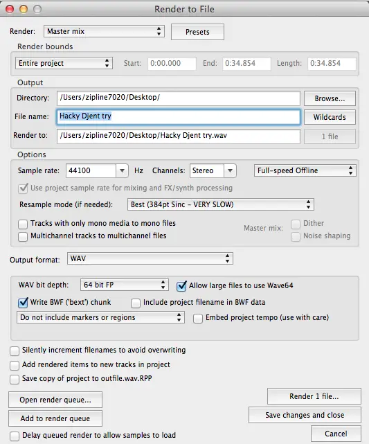

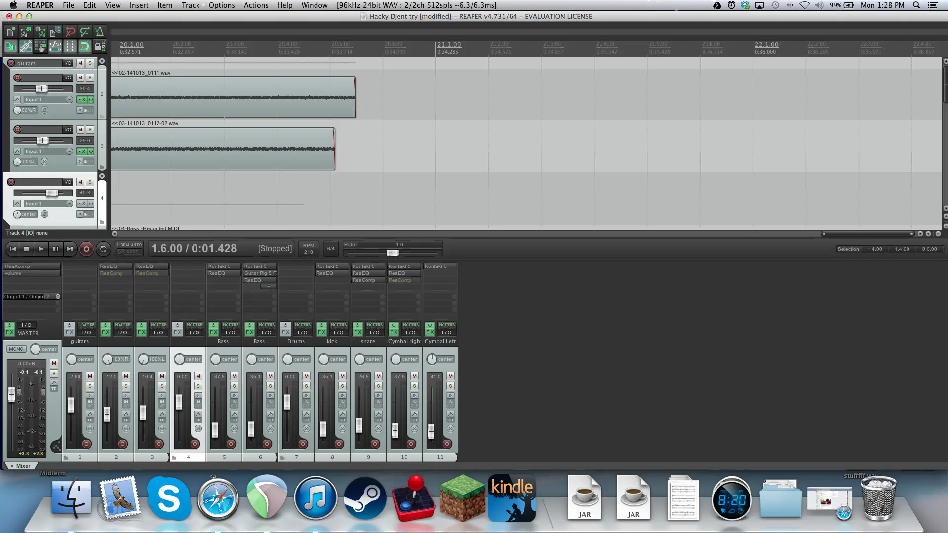

What settings are you using in the render dialog? Can you show us a screenshot of that and maybe the MCP for the project?

and things can be played but not sent to the master track? how do I check that. I thought everything went to the master track unless you muted it.

Based solely on the information in this thread, and the screenshots, I'm stumped. If you load a new project in reaper with nothing on the master and insert the rendered file, does it sound right?

Wait! Why are you rendering to 64fp? I'm kinda surprised iTunes will even take that. Render it to the bit depth at which your converters are running and see if that changes anything. Still don't completely understand why that would make a difference...
I don't know why its 64 fp, thats just what it set to. Im not sure what it even means.

Try rendering to a 44.1 KHz 24-bit WAV file and see how the results are. And as mentioned above, start disabling master bus effects until you find the offending one.

I turned the master bus off, and set it to 24 bit, and though the bass boost wasn't as extreme as with it on, it was definitely there. so it seems that theres a rendering bass boost coming from something else,
and the multi band from the master bus is making it worse.
