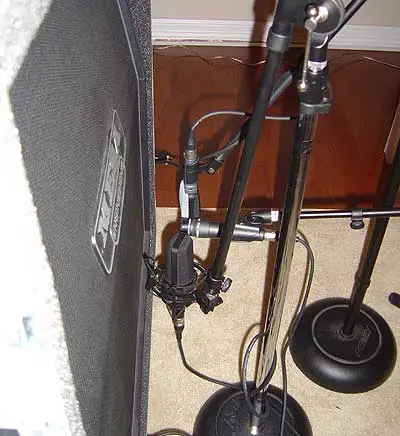

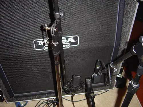

I threw these up to do some testing tonight so we would be prepared to record on Saturday. How does this look to you guys?

Yeah, you got a very nice gear but the only thing that counts is sound. No one who listens to your songs will see how you miked the cabinets (even if they care)
I don't know that, of all the options available, I would be inclined to choose to mic the very bottom speaker.

FWIW, I would go with the 57, track a guitar DI representative of what you're going to record, loop the DI track and feed it to the amp (reamp it)... adjust the amp and mic position for the tone you're after whilst monitoring using phones or your studio monitors.
I was more looking for a, "yeah, looks like you're going about it the right way" or a "no, no...you've got it all wrong. you might try...etc".
There truly isn't too much advice that can be given here. There are no showstoppers in your setup, but you really just have to listen. Throwing up 3 mics positioned only by eye could simply give three bad sounds that will sound worse when blended.
IMO, dial up a good guitar sound on your amp then sweep the 57 across the speaker until you have a good usable sound. Record a pass and make adjustments to the amp and mic from there. Personally I'd start with the 57 closer to the cloth and not dead center (looks that way in the photo but I can't really tell). Then add the other mics and blend to taste (or not at all). An awful lot of records are still made with a single 57.
If you want to time-align the mics to minimize phase issues and if you have a DAW, record a palm mute click on the high E string and check the alignment of the peaks in the DAW of the three mics. If, for example, the peak of the E609 appears later than the 57, then move the E609 closer.

Seriously, though. Get those mics up on one of the top speakers. There's a reason why lifting your amp up off the ground can have a positive effect. And you've got a mesa cab there - and the top speakers already have a bit of built-in altitude. So you don't even have to do that. Move those mics up, and you'll be set.

Yeah, i would mic both the top and bottom speakers. Maybe the sm57 on thbe bottom and the others (e609? and something in a shockmount (?) to the top LEFT speaker. My opinion tho.

Anyway, I'll heed your advice, chessrock, and move my mics up to one of the top speakers (whichever one I think sounds best).
To de-emphasize the LF content, you could also focus some of the mics more towards the center of the speaker, but don't be afraid to roll some lows off at the head as well:)

But going by visuals alone, I would have had at least one of those off axis by about 45 degrees, just to give some options.
Test all speakers. Each will be a little different. And you never know, one may be alot different (going bad or was bad). I think you should shove the 57 up close and use the others at different lengths away fron the enclosure for room ambience.
i really dont see the point in having the 2 large diaphram mics on each end. I can see the SM57 in the middle, and one large diaphram on one side.......
but why have 2 of them, one on each side? arent those 2 mics basicly capturing the same tone?

If I'm seeing correctly, the mic on the right side of the 57 (the one with the silver front) isn't a large diaphragm condensor, but a Sennheiser e609. It's a dynamic that has a different flavor than the ol' tried and true 57.
I've tried the same combo many times, with the thought that I'd mix to taste, but I hardly ever even use the track from the 609. I've got an old Unidyne III 57 that I just love all by it's lonesome.

After testing some stuff this afternoon, this is what I came up with...
I changed the mic positions. I have the 57 on the top right speaker, off axis. I have the e609 on the same speaker off axis, but not as much as the 57. I then put the 4033 on the left speaker, just a bit from the cone on the left side.
The mix is 609 & 4033 on the left, 57 on the right. Volume adjusted accordingly, of course.

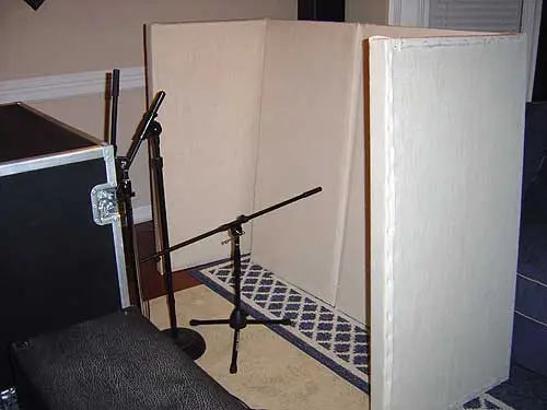

Cab is downstairs with 703 around it (pictured above). Cab and mics are plugged into a Pro Co snake that goes upstairs. Upstairs is the amp head, guitar, and DAW.

EDIT: Forgot to mention that I checked the phase of all the mics with each other. There is just a tad bit of phase. When I flipped the phase on any given mic in relation to another, there's just a bit that I can still hear. So, they don't totally cancel each other out...but I guess that'll be okay, right?
