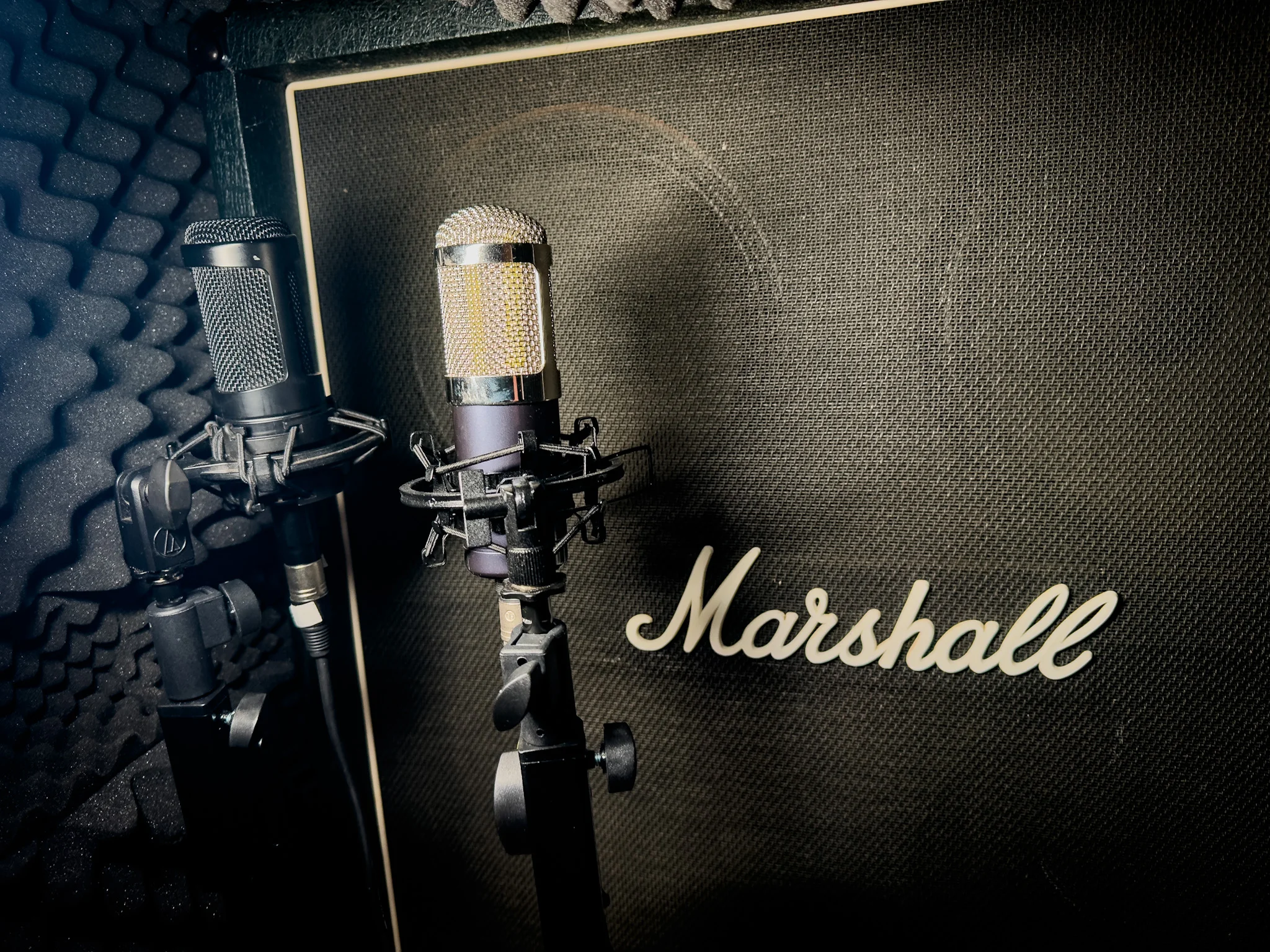

After adding the ENGL 920 i can use my cab easily again besides the captor X so time to add the mics.
It's a marshall cab with blackbacks
At the moment setup with a AT2035 and MXR R144
Testing tomorrow 😉
Set them up pretty accurate, if needed which allignment software do you guys use ?

I do it by ear and nudging the tracks a couple of ticks if need be.

IMO Something must be whonky in your method/setup/Microphones if you are getting phase issues all the time - the only time I remember getting any alignment issues was when I recorded a whole band with mics - and even then it was really minor.
Maybe I did not explain it correctly.
When using a ruler I'm almost spot on with position the mics.
And indeed listen en nudge. It's not a big deal and can even work nice with some detune and a light pan L/R.

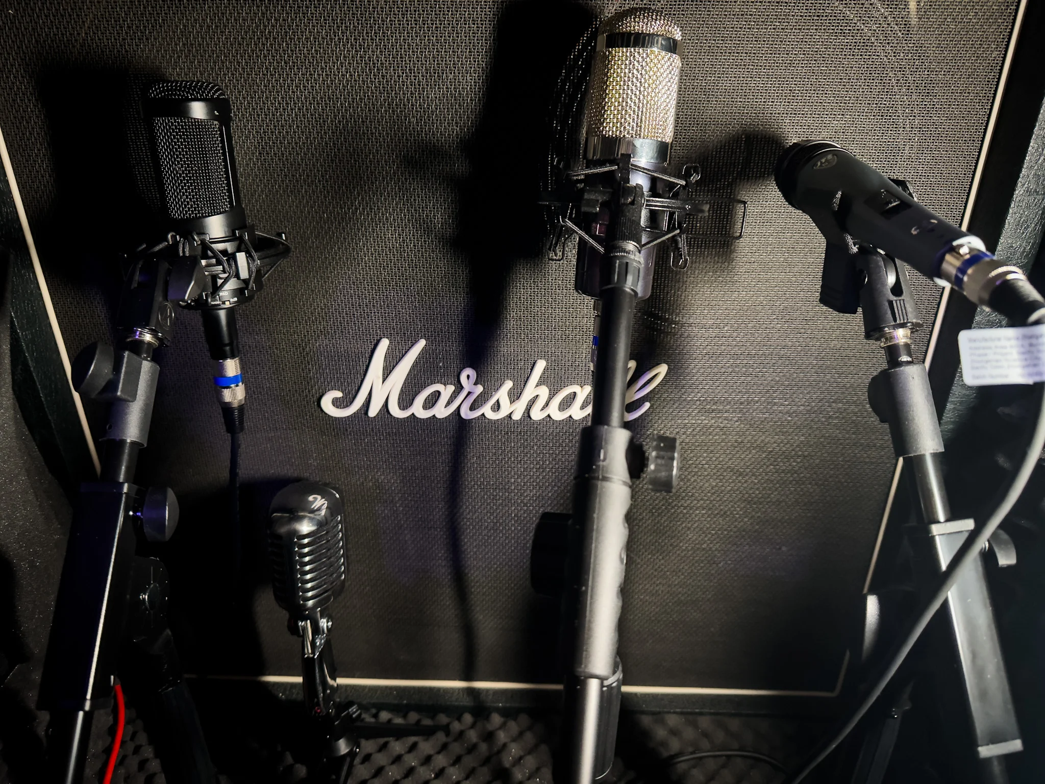

Tried a new setup now that the ENGL920 is back.
Synergy Vai module
ENGL 930 into a Marshall SE100
Marshall Cab with blackbacks
AT2035 as main mic, SM57 clone as fill and on the cleans very soft a MXR144 ribbon.
Testing a few mics for base tones
Have to start playing with placements later ;)
it's a cheap knockoff I bought for photoshoots but in all fairness doesn't sound bad.
I did just order a slate digital ml2 to play a bit more.
