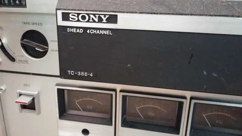

These types of machines usually had a mic input on an unbalanced ¼" jack AND a line input. When you did SOS recordings, you took the left channel's output, and then mixed it with the mic input on the right - so that one then had two tracks, then you did the same and bounced back the other way. Other tape decks didn't have this facility and you had to do the routing externally. There was a snag that with three head machines, the replay head was after the record head so the two tracks got shifted on the tape. Some people were able to use the record head to do the replay so it was in sync. Stereo machines of this era were nearly always dual mono - you selected left, right or both channels. You could also use the SOS facility to create copycat style echo - which I remember being rather neat. You changed the delay time by changing the recording speed! The Sony 377 mentioned was also available in a 4 channel version - and this model was pretty good for editing because you could remove the head cover and there were no pads to get in the way. Sonically, they were better than the cassettes of the day, but certainly not really brilliant by the standards of today.
I've got this sitting next to me...
