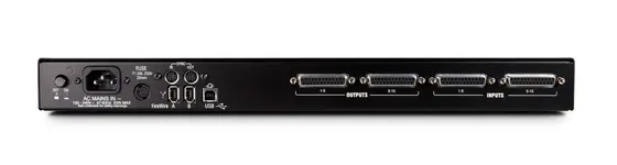

Allen & Heath ICE16 or Cymatic LR16 for a straight 16 channel input and output interface, no bells and whistles.
I use echo audiofire 12 which is similar but 12 channel I/O. I think the Allen and Heath and the Cymatic are both USB based while the Echo is FireWire.
I have an MSR16 with an M520 board.
I run the tape outputs directly into an Allen and Heath ICE 16. From the ICE I go into the board.
ICE unit is hooked into the PC via usb, and 16 tracks all at the same time are transfered to the daw. They're stored on an SSD usb drive as wav files.
My setup couldn't be easier. I can mix digital tracks in the box or on the console.

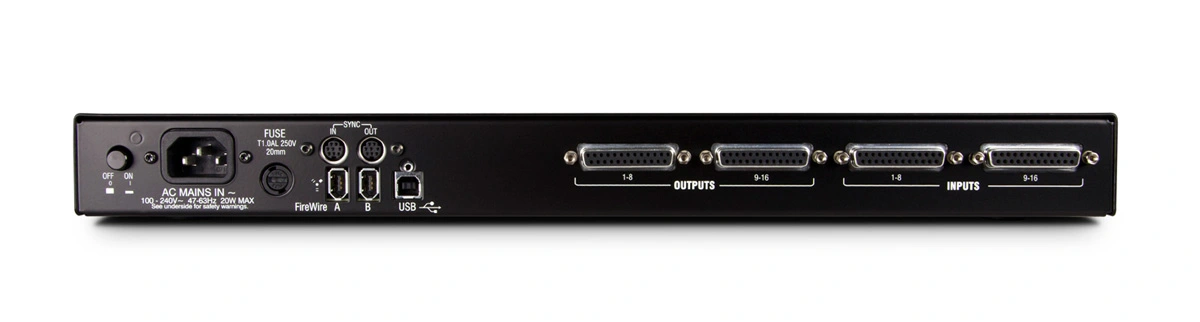

So it took me some time but at last i got hands on the ICE16D for a good price.
I do have some small technical question i'd be happy to ask you or anyone else here....
Actually i was on the hunt for the normal version, but then the balanced version popped up for 200$ so i grabbed it..
Inputs wise , the M512 got the same balanced amp XLR outputs that the M520 has, so it is a perfect match with XLR to D-SUB snake.
question 1: i came to know that the Tascam mixers XLR outputs are pin 3 hot rather then 2 - quote from an old tread:
"It is true that the M520 is pin3 hot - But It is a true differential output with both pin3 and pin2 driven. Both are hot with pin3 on the + phase and pin 2 on the - phase. Don't run it into anything that has either pin 3 or pin 2 grounded. If you need to do that use a line transformer ..."
according to the ICE16D manual (https://www.allen-heath.com/media/AP9216_2_ICE-16D_UserGuide_A5.pdf) - the inputs conforms AES59 standard. - does that mean that any ready-made snake will work regardless of the opposite pinout of the tascam?
question 2 i am still in doubt what will be the best wiring for the outputs of ICE16D back to the console.
option 1 is a D-SUB to rca snake, so that means loosing the balanced signal.
option 2 is using the mic inputs of the M512 input channels . Going thru the manual, there is nothing mentioned regarding driving these inputs with line level signal. I contacted A&H supports, they replied:"The signal going out of ICE will be a bit low so you will have to crank it up on the mixer channels.Final quality depends on how well you can manage the level differences. It's a matter of experimenting."
What in your opinions guys will give a better gain staging chain?
