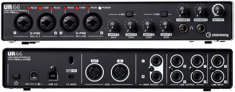

Awesome! I just found one that is exactly like you said, it's called steinberg UR44 and you can clearly see the separation between the monitor outputs and the channel's outputs. It sounds like this is gonna be the way to go, thanks!

Just to point out that the Tascam 16x08 is the same price most places as that Steunberg deal, but with more of everything...

Don't want to be boring about this (again!) but the Native Instruments Komplete Audio 6 has the connectivity the OP needs and definitely has the low latency he needs. That Steinberg looks superb but I wonder if it has low enough latency?
I heard the low latency in the steinberg is good, i saw on youtube people using in with an ipad software in real time to get reverbs, compressors, eq and all sort of stuff from there. The Native instruments is tempting because of the software and all the plug-ins it comes with, but i found its outputs to be a bit confusing. I mean you plug your voice and guitar in channel 1 and 2 where the preamps are but then the outputs "1 and 2" are Main outputs so i'm not sure you can get the signals nicely separeted like i need, also it has got 2 preamps less than the steinberg. But i mean at the end of the day in this price range i'm sure they're all valid products.
