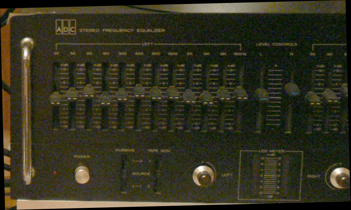

You can have a dip at 300, it depends on what it is. You can work off the MIC measurements for a plan of attack. It was much, much cheaper for me to get a EQ for that one problem area
A fixed band eq? :o
Don't worry anyway. In small mostly untreated rooms, unless you keep you head in a vise all them different gotchas' gonna add up to a huge complicated pile no eq could ever 'track' :>)
haha. fixed band has done well for me since the late '70s. Many still sound like shit and that can be reason enough to toss them, but for mixing it can sound like shit and be fine. I used a auto EQ for installations as a starting point always working on placement. For having something cheap I can switch in for my 90-180Hz area, it was quick and easy. I'm not a fan of eq for most things, but it seemed the logical choice after my measurements.
