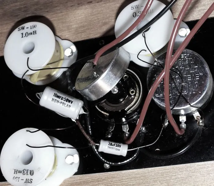

Maybe some have never heard of L-Pads for room correction, either. Here they are;
