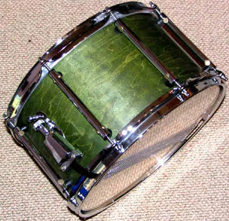

Cory,
Have you thought of trying either the Recorderman's or Glyn Johns minimalistic micing approach for the drums, if you can do it you'll only need 4 or 5 mics/tracks. Personally, I'd only worry about getting the drums and main vocals to R2R and run the rest straight to the DAW. Put the time in to experiment with 1) instrument/amp positioning within the room and 2) mic placement, get these right and you can save a lot of EQing, etc.
Make sure you have good heads on the drums, if you're not happy with your snare sound consider other head options. If you cut a sharp bearing edge, maybe consider carefully rounding it off a little with some fine sandpaper, change the tuning.......experiment ;).......................guess who makes ply snare shells occasionally :D

Make sure you have good heads on the drums, if you're not happy with your snare sound consider other head options. If you cut a sharp bearing edge, maybe consider carefully rounding it off a little with some fine sandpaper, change the tuning.......experiment .......................guess who makes ply snare shells occasionally

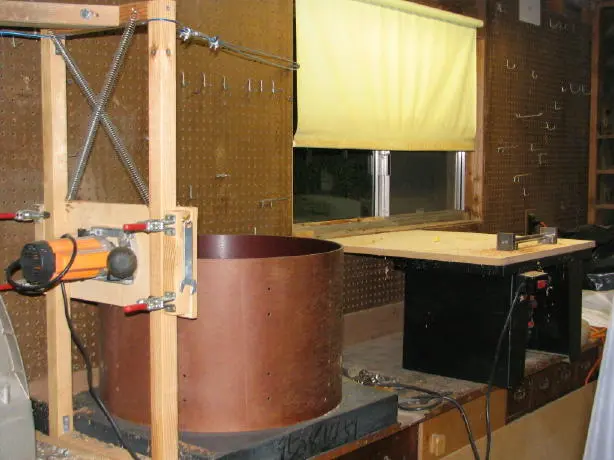

AUSROCK!! PM me about your shells. Totally curious about your craft. What wood do you make them out of? Do have a press mold or what? I made drums for several years. I devised a system to ensure, within 0.003" that the top and bottom bearing edges of a shell were parallel to each other, flat and true, and that the bearing edges were perpendicular to the axis of the cylinder. I can cut any profile, but my preferred favorite doesn't use a bevel at all...a round-over bit on the inner cut, and a round-over bit for the counter-cut, leaving you with a rounded profile...look at the vintage drums and by this time some of them (especially the classic 3-ply maple-poplar-maple Slingerland shells with the thick center soft-wood poplar ply) have a nearly flat profile...well I found to take that, refine it, make it precise, results in a warm, full and controlled sound. That's for the toms and kick shells, but for the snare I do use a conventional 45-degree inside cut and a healthy radius counter-cut. The lugs were a design inspired by my mentor George Tuthill. George has since passed on, but was a New Jersey jazzer with a tremendous amount of theory, chops and feel...he was extremelay versatile; had the ability to teach pretty much anything, and also spent many years directing champion drum and bugle corp, and did R&D for Slingerland and Yamaha. The early Field Master series field drums from Yamaha had many of his innovations, as did the Magnum series set drums from Slingerland. The lug on the drums I used to build was a GMS inspired design, but the shell mounting point is outboard of the lug nut, which prevents the lug body from bowing and pulling away from the shell in the center which as was an issue with many high-tension lugs, which led to the triple-screw mounted lugs. So the lug design is overkill for a tom or kick, but it does provide a very strong and stable minimal contact design, and on the snare drums its great. AUGGHHH you opened the floodgate, Ausrock!!! :eek::eek::eek::D
Heads...yeah, that's a can of worms huh? I've been really happy though with the sound and durability of the Renaissance series heads from Remo for both live and studio, especially on snare. Tuning is something I'm sure I could play with on the snare. I'm really happy with the tom tuning and kick tuning...snare is kind of a final frontier. I really like the sound of my snare for live and unmic'ed situations, but it is somewhat limited for studio work. I'll keep at it. Thank you for the encouraging words.
Seriously, though, I would love to hear more about your shells...
