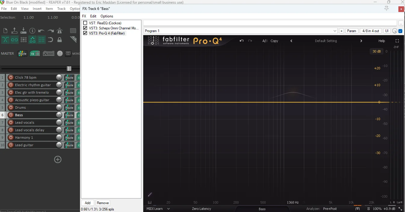

Well I broke down and bought Fab Filter Pro Q4. I'm learning a lot about how to use the GUI. I know that learning EQ techniques will take time and patience. But I'm having fun exploring what it can do, including using dynamic EQ. So much simpler than setting it up with ReaEQ, though ReaEQ is pretty cool in it's own right, considering that one is free.
I just used a bunch of instances of Pro Q4 on a mastering job I've been meaning to get to for way too many months.
I have a question about sidechain EQ in Reaper using Fab Filter Pro Q4.
I can't find the button to click to let me use an input channel for the sidechain.
I know how to create the send, just not how to select the input.
Generally FabFilter - Cog Wheel - Plugin Cog Wheel - Processing - Stereo Side Chain - In the Drop Down Menu are your channels that you want to send to.

The problem I have @Papanate or anyone, is that I don't see the Cog to begin the process:
