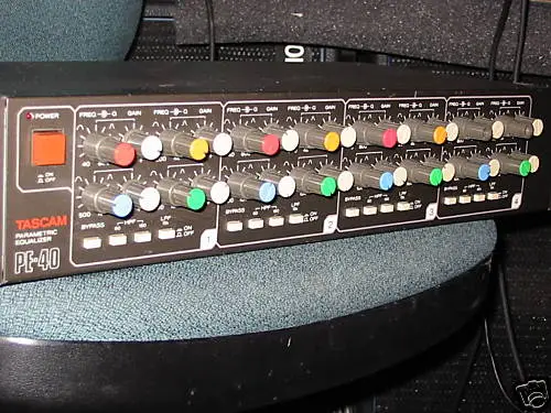

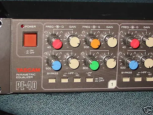

...I have two Tascam PE-40 parametric eq's. I don't get the sense that these are really sought after units for their sound, but in my humble studio they are pretty slick for front-end analog eq. !!!:D:D:D
Dude, for what you describe as "not sought after", I call "sleeper gear" or a "sleeper deal".
The PE-40 is a premium and fine piece of gear from end to end, including sound and build quality. People today just don't know it, because this line of gear was only produced and marketed for a short time in the 80's. Not only that, but the marketing presence of TASCAM at the time was pretty much nil, as their marketing ploy always seemed like a "pros should know" type of attitude, and forget the rest. Now that home recording is being marketed to every high school kid and his grandmother, Behri, Mackie, Focusrite and all those newer guys have the aggressive marketing strategy on their gear. Tascam never marketed gear well, IMO, but back OT...
The PE-40 is a premium piece of gear for HR, & despite it's vintage was ahead of it's time & holds up well today. In it's day it wasn't the highest of esoteric gear you could find, but it was solidly high-end-midline gear,... if that makes any sense at all. By today's standards it competes well with most and stomps some gear technically, depending on what you compare it to.
In short, this gear is loaded! I don't know if "pros should know" the PE-40, but I know and now you do too!:eek:;)

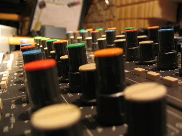

Yeah, I'm totally pleased with the feature set, and they sound pretty good too! I paid about $200USD for both of mine in total. One had a busted gain knob on one of the channels...it was supposedly functional, but I got a replacement from Tascam and put that on. No complaints here!!! :p

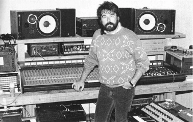

I did get that book that you recommended...only part way into it so far, but it is really a great resource. It'll have a permanent spot on the bookshelf, and one of the co-authors, Larry Wichman, produced and engineered one of my favorite albums of all time, Men At Work's "Business As Usual".
I got to the first page and the picture told me the book was a keeper...that's an M-520 he's leaning on. ;)
