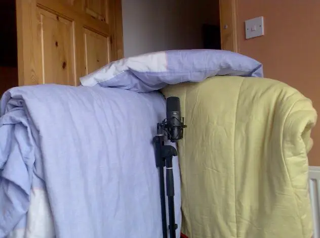

I've noticed the room I've been recording in has effected the quality of the recording. Usually I record at home in the front room when no one else is home, so there aren't alot of changes I could really make to the room since other people have to live here too. I'm not quite sure what do to about the space I record in or if there are any solutions, but if there is I'd like to hear them.
You could build rigid fiberglass broadband gobos, and arrange the mixing position to the best place, without too much distruption. However, unless you're recording a full band, and mixing, then i don't think you really need more than just headphones. If what you record is sent somewhere else with monitors/good mixing environment, to be mixed/mastered(if you go that far), then don't bother with monitors/acoustics. I'd suggest trying to get a dead sound, however, while recording, so the person mixing has the most flexability. Something like this can help acheive that dead dry sound(duvets/pillow over a mic stand :D):
