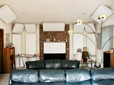

Cool.. I just saw that on one of the links above.. So that seems simple enough as far as building bass traps into the corners. But I dont think you guys understand what Im talkin about when I ask about traps being hung vertically.. I mean vertically from wall to ceiling.. Kind of whats going on the corner form wall to wall... but up across the top of wall to the ceiling. Is there any value in this?

The answer to your question is yes. Check out Ethan's site and you will see pictures of real world examples of what your describing. As they say, a picture is worth a thousand words, and Ethan's got 'em.

Rick and Ethan are on the money regarding design technologies.
The corner wad is kind of fool-proof, but it is broadband. The sealed membrane traps are bass-only with an ability to reflect highs back into the room. I used a comination of both in my room, to keep the high end from disappearing altogether.
Here are some pix: http://toddejones.com/hugegallery.html
The combination approach works really well.
Now This Is Exactly what I meant! :D I Wonder if my ghetto way with the pillows will look as nice? lol
