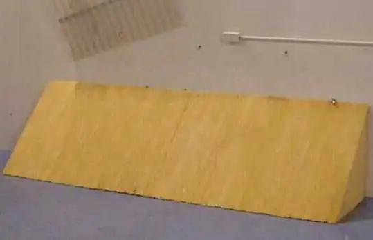

Here is what I mean.

Just to add to the confusion...
If the drywall and studs are acting as membrane absorbers, does that mean a concrete wall has little or no absobtion qualities. Or does it depend on whether it's concrete block, or solid concrete?
Yeah, that changes things, too.
