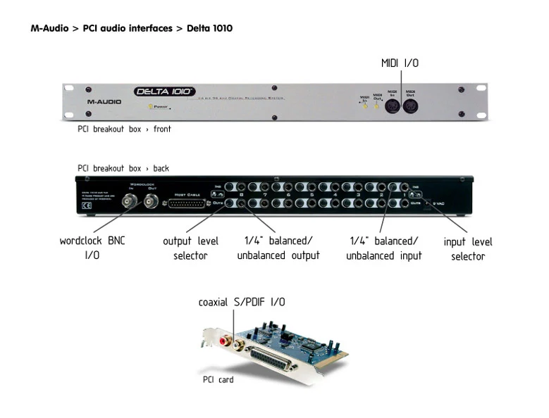

I have a Delta1010. I've recently moved my computer to another room, and won't be using the expansion for the Delta1010 for the time being, and would like to set the card up to just plug into my amp straight from the back of the computer. It's got the typical red/white audio outputs, so I plugged my line into that, then into my amp. However, I have no sound. When I open my MAudio control panel, I can see the levels increasing and decreasing as music is playing, but nothing is coming out of the speakers. Do I have to do something special? How do I set the patch bay up?

If I'm not mistaken you NEED to use the breakout box with a Delta 1010, those two RCA jacks are the (digital) spdif I/O I think.
Oh... well that kinda sucks then... I didn't really want to bring my rack in here.
Actually, if that was the case, why can see the levels changing with the music on the M-Audio Control Panel?
it's coaxial.....
joro said:
it's coaxial.....
Which means that 1 RCA connector is a stereo input, and the other is a stereo output, but they are both spdif (digital) connectors.
