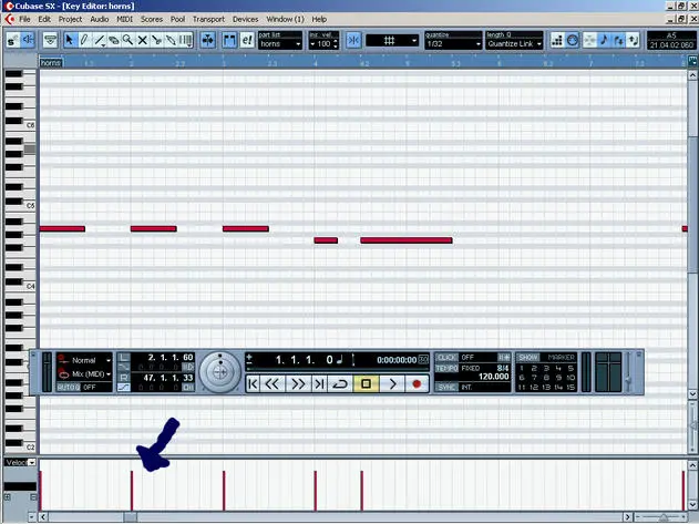

However in sx3 when you click on the midi part.
across the bottom of the screen is the velocity section.
you could select all the notes in the part and set the velocitys from there.
Why do you want to do this ?
heres a screenshot of the key editor in sx3
the arrow points to the velocity bar.
if needs be you can drag the pencil tool across the velocity bars to set them manually .

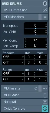

Use the midi modifiers section on the midi channel. You can use Velocity Shift or Velocity Compress to do what you want. Just put 128 in Velocity Shift and 128 will be added to the velocity of every note - effectively doing what you want...

Who knows - I got negative repped for giving the correct answer. When you want the velocity modified consistently in realtime as you play - you gotta use the midi modifiers - the piano roll is not an option. I like the midi compressor modifier for drums - usually use a 2/1 on my kit using AD for best results.
