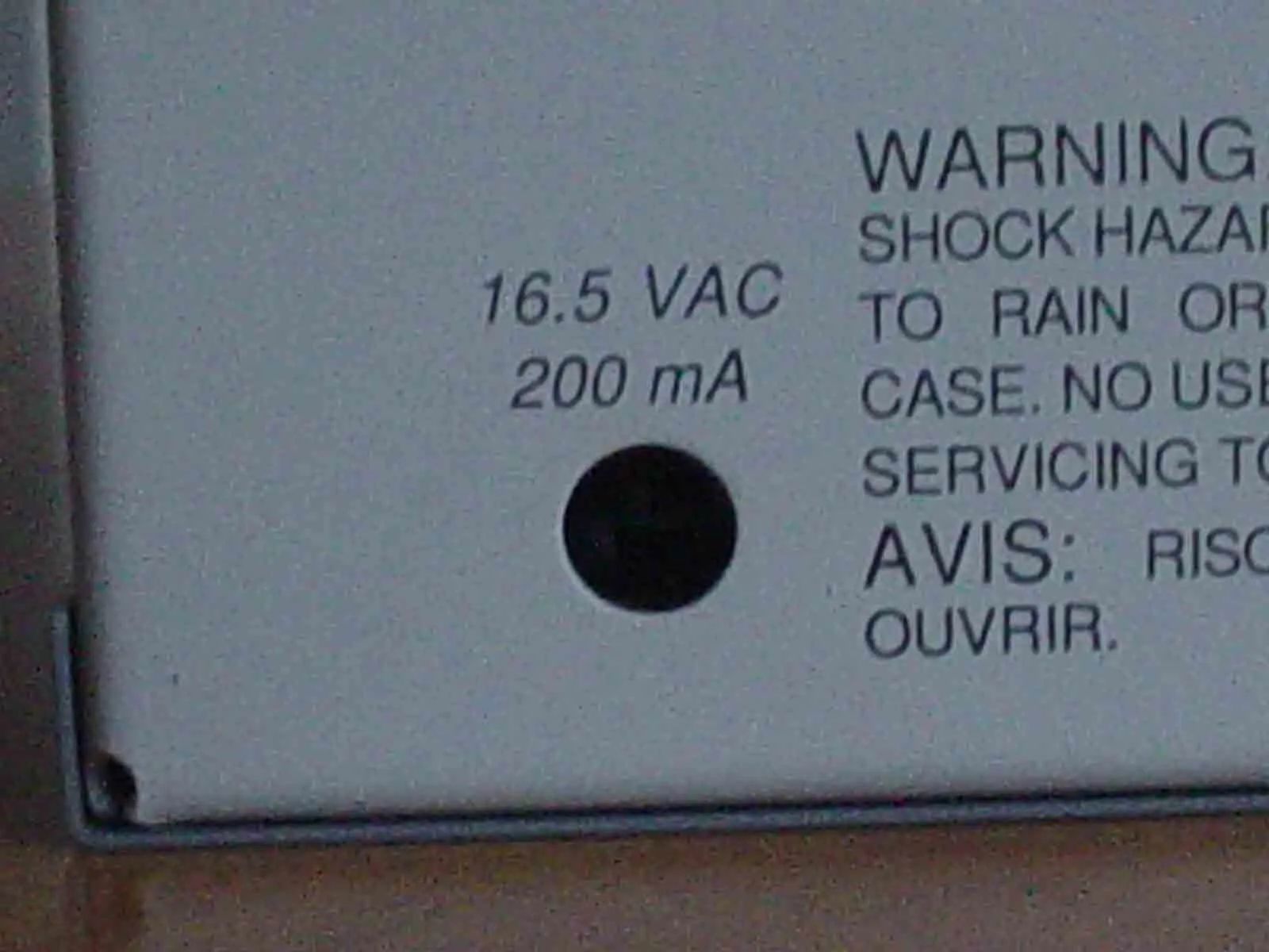

hi,
the power input on my rackmounted equalizer has come loose. so I am going to open it up and glue it back in place or something. I took all of the screws out, and i think there are 2 possible ways of opening it, but I am not sure which to do. On the bottom I can slide off a panel, which reveals the board. On the top I can slide off another panel, which is attached to the front faceplate and all of the knobs.
So, I am unsure of whether I should remove the board, to get inside, or the ouside plate with the knobs. I don't want to break it.
Thanks for any input.

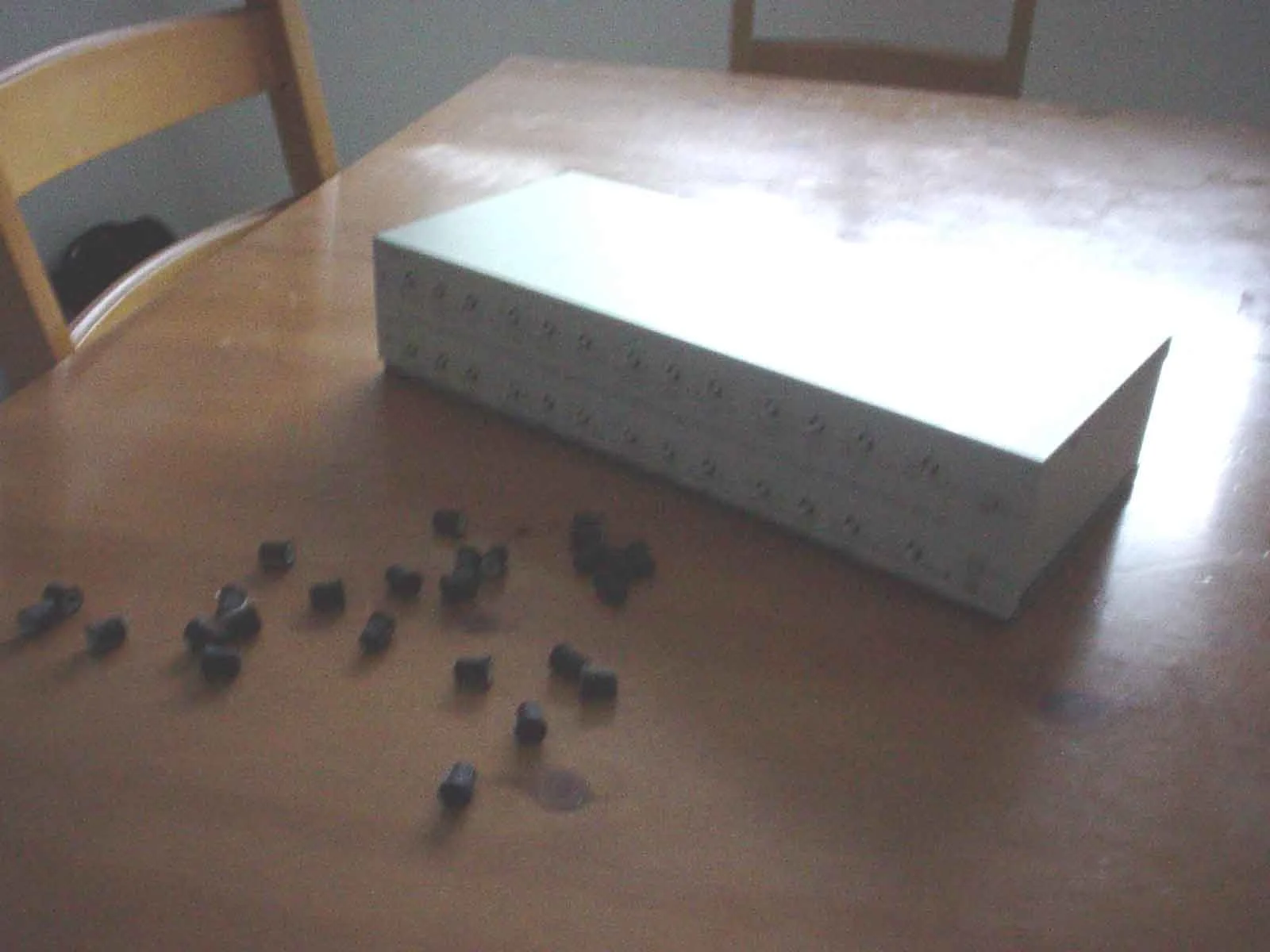

just start unscrewing things and remember where it all goes. This stuff isn't as fragile as everyone likes to believe. That doesn't mean you can let your guard down, but take care and it will be okay. You might have to pull the knobs off the front panel (they should just pull off unless there is a screw in the side, but if you don't see a screw, just pull) and then use wrench or whatnot to get the hex nuts off. Then it would all come apart.

it has a power supply on the removable power cable, it is simply the input jack that has come loose. I figured it came loose because it was glued-on originally...maybe not?

Dude, it's the POWER plug.

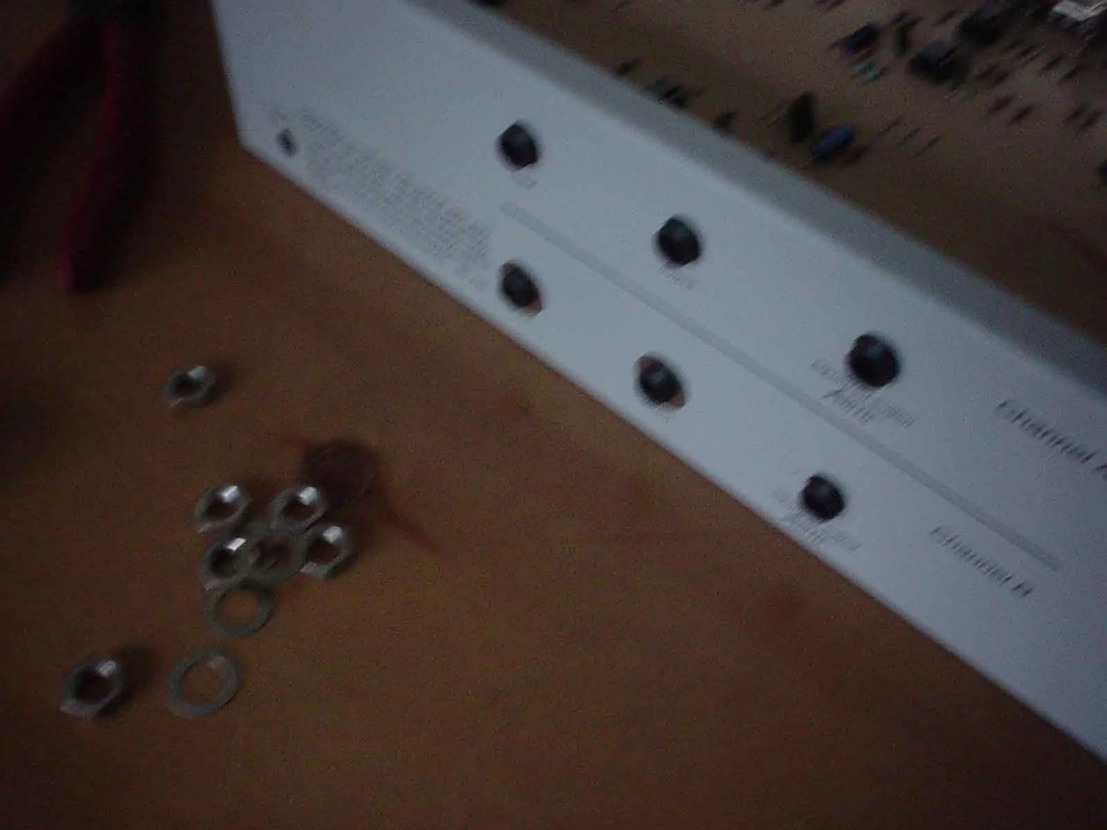

If you don't see screws on either side of it (or holes where the screws might have been) then there is a retainer clip on the inside. Just take off the knobs, you won't hurt anything. Taking the circuit board out from the bottom will be a much bigger pain and might require you to take the knobs off anyway.
no,no. it is the power input jack. which is very small. one of those small circular ones with a pin. I will give the knobs thing a try.

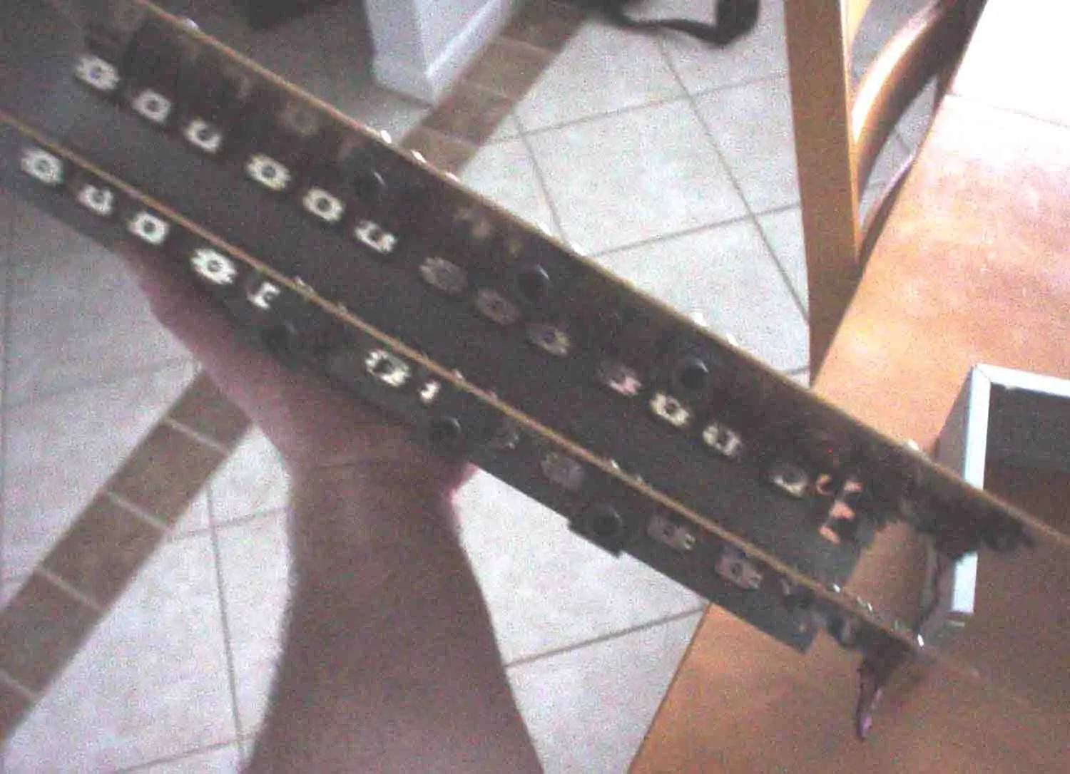

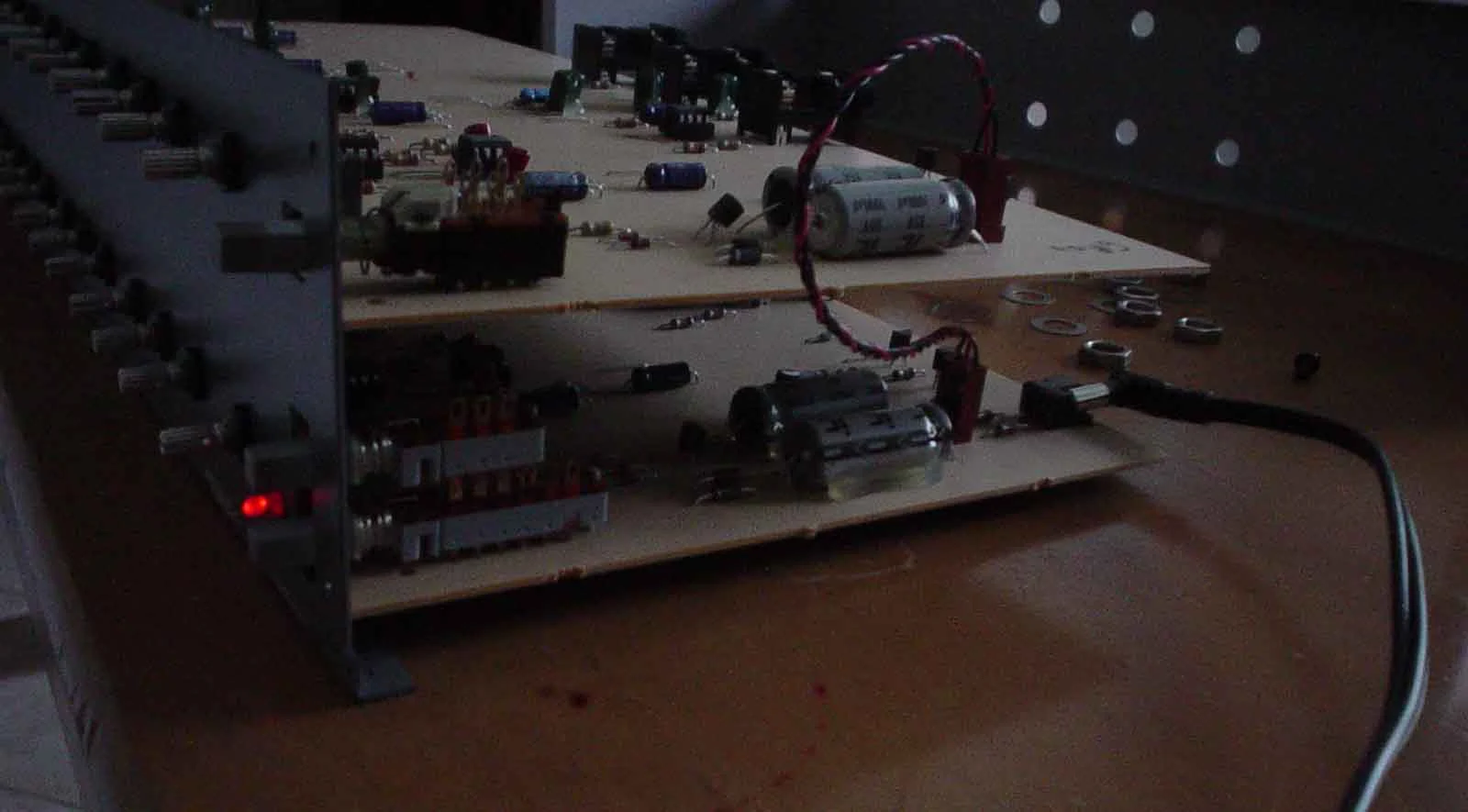

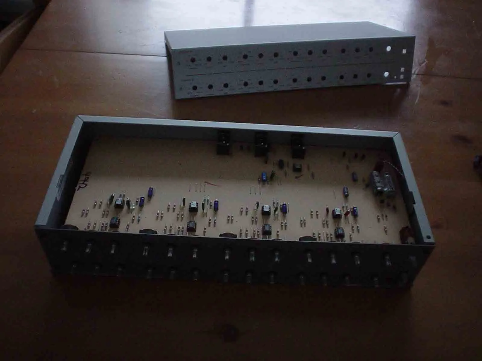

I followed everyones advice and pulled all of the knobs off, and then the cover. this revealed ANOTHER circuit board, and ANOTHER faceplate underneath. There were four screws on that faceplate, after unscrewing them, the sides-rear panel could be removed, leaving a faceplate with 2 boards attached paralell. So I got it open.

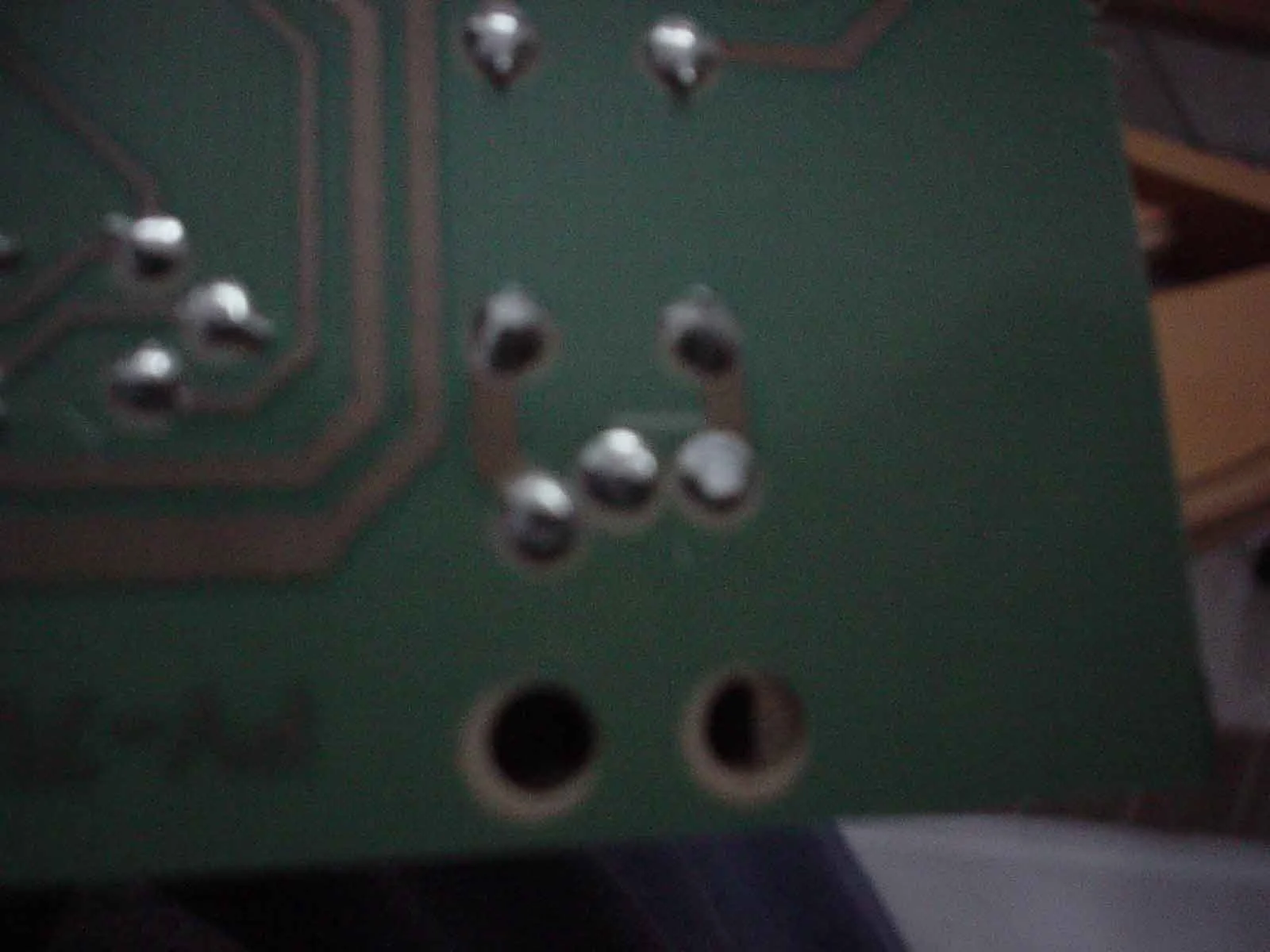

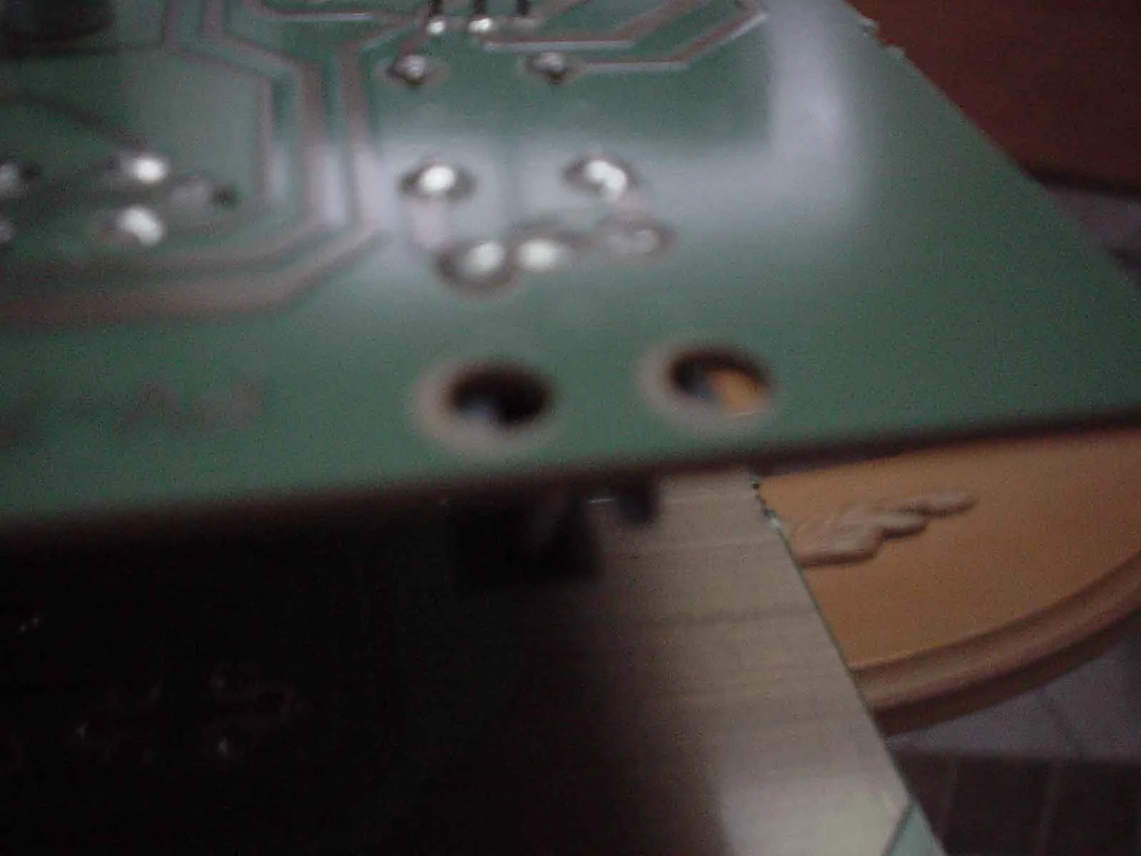

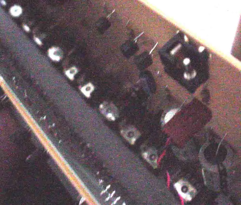

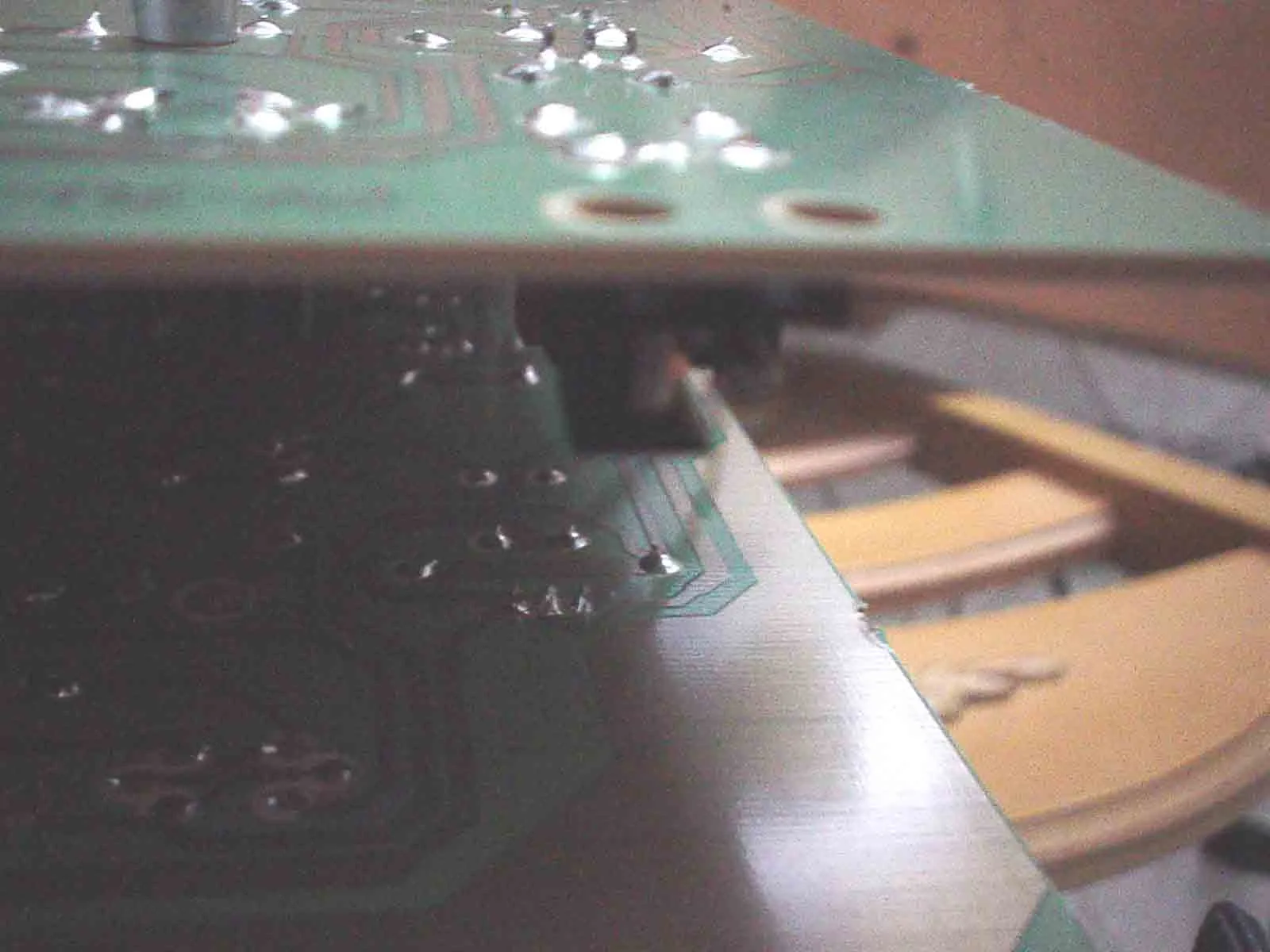

Below is the power jack input. It is attached to the board via those three points on the reverse side. it then has 2 feet that stick through two tiny holes. which is what came loose. Suprisingly, they just popped back into the holes.
Plugged it in, still works. So nothing needs to be re-soldiered. Just set back in place. The power input is not attached well and will come loose very very easily. I need a way to secure it to the board. Any ideas??

See....wasn't so bad was it?
Notice the "groups" on the circuit board? Simple stuff really. Basically probably the same thing repeated over with a different value or two to adjust a different frequency. I didn't realize it was a DC adaptor plug in. I was thinking of the three prong.
So explain again how it was mounted if it wasn't soldered and there was no screws? I think I missed it.
it looks like there are 3 soldiered points, and 2 sort of "feet" that stick into the two holes there. they just stick there. only they dont stick there anymore. the soldiered points also seem to carry the power, and they are still connected. I really think some glue would do it.
edit-
..actually I could just soldier the plastic to the board, where there are no lines or connections...I have never soldiered a board but I think this might do the trick?
