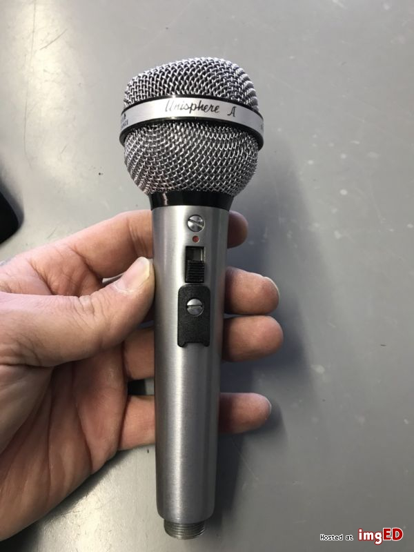

Hello i have this mic with me a old shure 585SA unisphere A
so im trying to open it and change the internal wires to a more superior quality wires to make little improovement
i opened it and removed the screw from outside of the mic looked inside and the switch on off still seems to be attached to the inside of the microphone by some glue rubbered-foam, im thinking to use a plier to push the switch out but im kind of worry about doint that, also is there more thing inside the mic like small tranformers or something? im afraid after removing the switch i cannot remove the transformer, i know in the bottom of the mic there a soldering but its easily removable. thanks for any help.

Hi,
I think you'd need to remove both screws to remove the switch assembly.
If there's any glue holding it you should then be able to break that seal by pushing the switch in, gently, from the outside.
What they said, though ^^.
Unless the wiring is damaged somehow, replacing it isn't going to make any difference to the microphone.

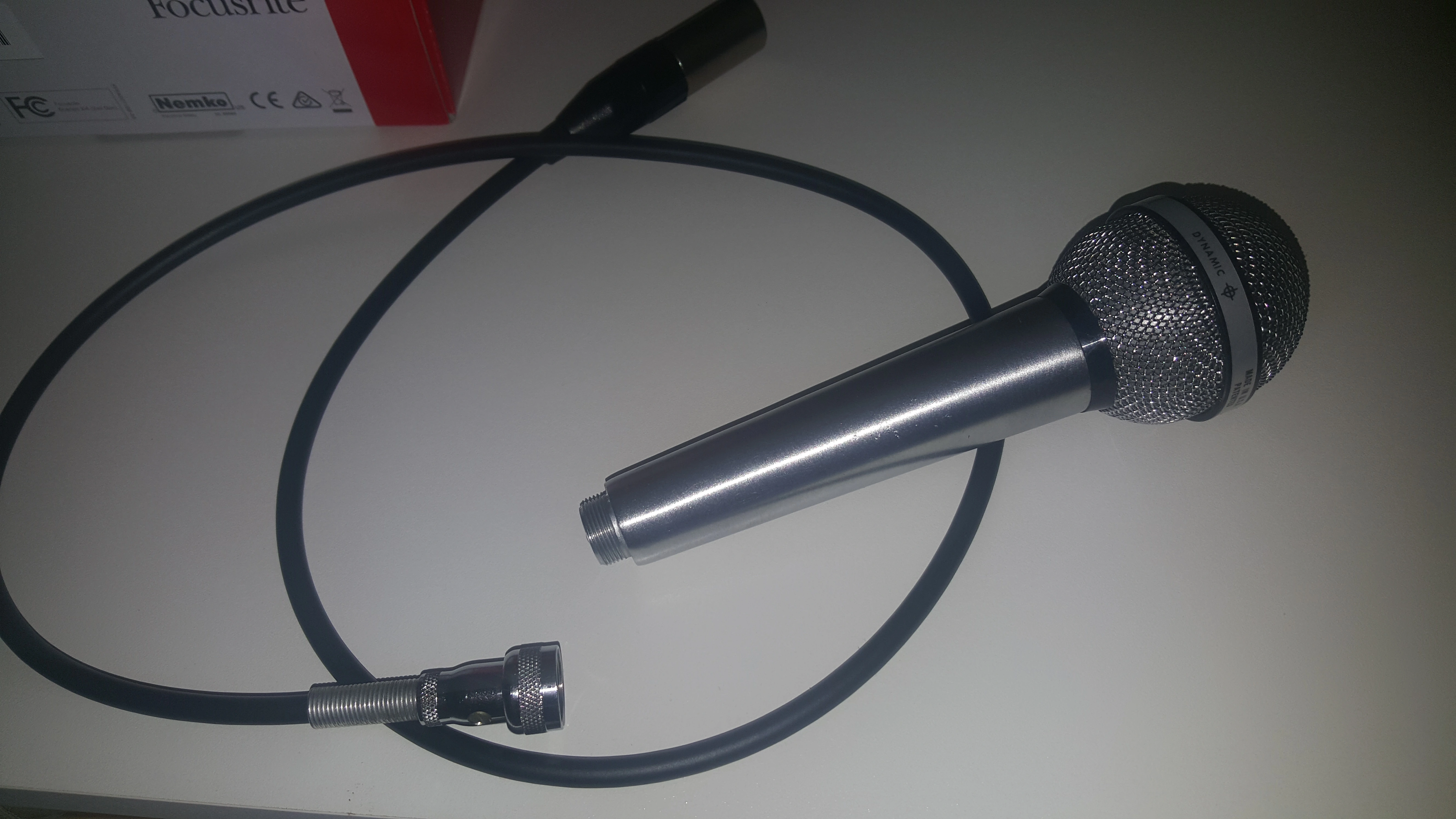

I did some tests with focusrite interface on youtube
/watch?v=rVSCJK8BBcw
/watch?v=cDl9TVkdq-A
---------- Update ----------
thanks i will leave it that way
Not sure why you're worrying - sounds very close if not so close I cannot tell. Amazing for such an ancient mic!

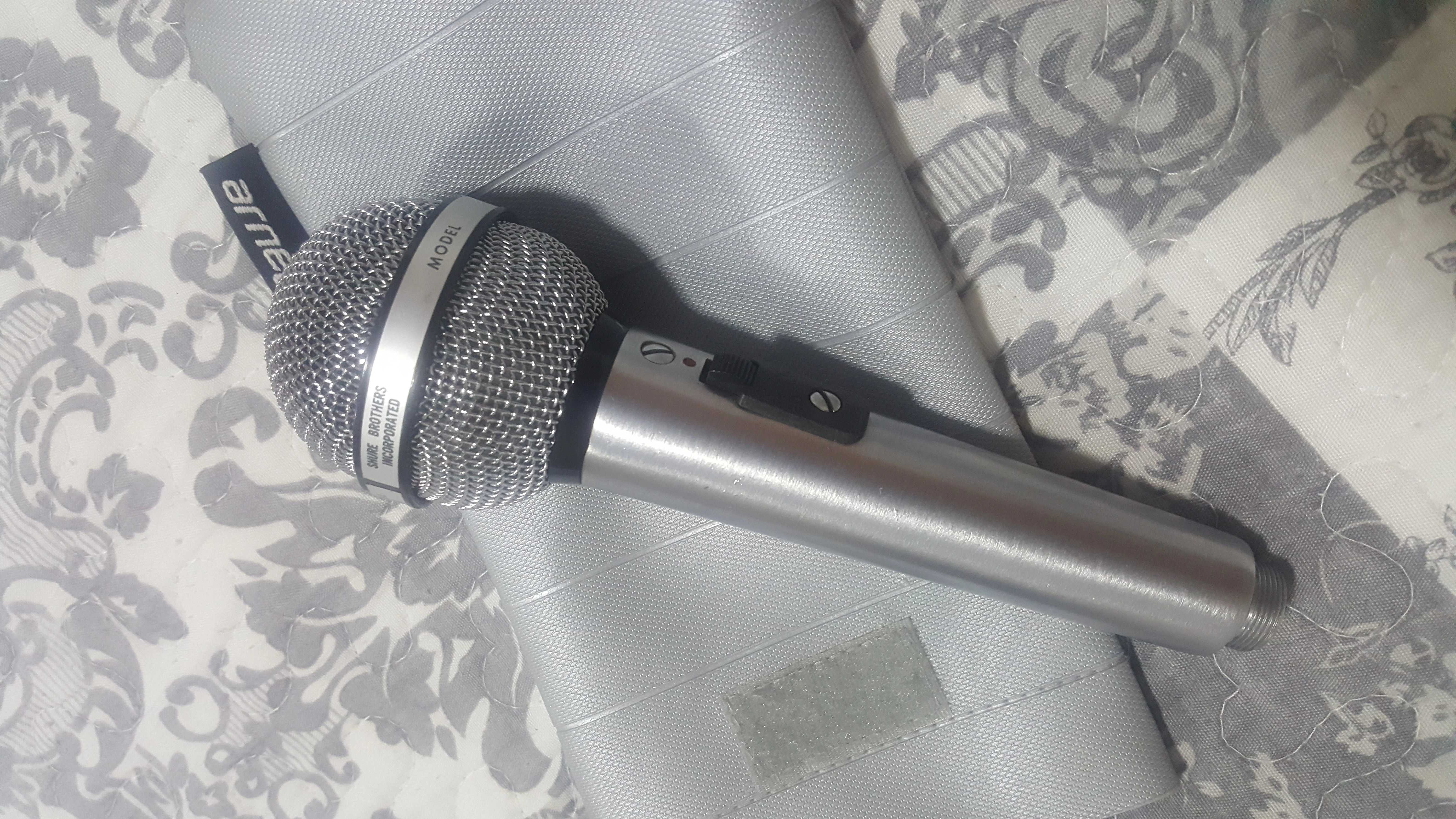

heres the real pic of the mic, i was hurry so i get a ramdom photo on the internet
This mic has some history, the previous owner was Omar Izar a famous harmionica player from Brazil he was also very friend of toots thielemans, here videoclip of him : /watch?v=brM2swRphU8
these probablity this mic was used by Elis Regina and Toots Thielemans
