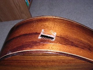

Okay, I just banged my precious acoustic guitar (against some furniture) and made a perfectly square hole on the bottom of the guitar (clear through).
It's not the most expensive guitar in the world but for $600 it's the most expensive guitar I own. Any one know if there is a DIY on how to repair a guitar or has any of you had any similar experiences?

Here is a pic for reference if anyone has any ideas.

There shouldn't be any structural damage at that point. Where's the missing piece? I would just glue it back in - you could support it from the inside by gluing a thin piece of veneer inside over the hole. Then fill the defects with plastic wood and sand.
No matter what you do, the problem is going to be matching the finish. I don't have any ideas there.

You want that crack fixed. I have a similar crack on the upper treble bout of my D-35. Full bottle of beer off a table right onto the side of the instrument. Cracked claer through. Fix was a piece of cotton cloth glued onto the inside of the bout. Patch has held for 20 years.
If you don't get some glue in there you run the risk of the entire side splitting. You don't want that to happen.

Actually, the only way is to get some similar wood, cut out a small piece, glue it in, sand it and restain it. It's not really something you want to do unless you have done it before. If you want it fixed, take it to someone who does woodwork, they can probably help you. If you don't want to fix it, make sure that you use a file and round out the sharp corners of the whole. If you don't, that is where a crack will start, then the guitar will be junk. If you round the corners, it shouldn't crack.

The missing piece is still on the guitar. From this angle you cannot see the piece got pushed in. It's really like a inch long gash (the width of the corner) and the sides of the gash got crushed (in an accordion fashion) but stayed attached.

Using animal hide glue get some cleats in there to stop further cracking. Hide glue allows you to undo anything you've done without damage.

I would just leave it alone. Find the toher peice and glue it back on from the inside. You don't want to use Bondo in my opinion it is a pain in the rear!

Can you reach in through the soundhole and feel the bashed in wood? If so, gently try to push it back out straight. Then you could glue it - as noted, hot hide glue would be best, as it is reversable - if you can find it.

Yes that's the forum I found. In fact they said, find a professional to fix it don't try to fix it yourself. I'm likely to do more damage than good if I try to repair my guitar. They recommended talking to guitar teachers or the high end music store (we have one in town) because they'll know a reputable person who can repair guitars in our local area.
I thought I may want to do this, but I don't want to cause further damage. According to the mimf forum, it's a great deal harder to fix a guitar than it is to build a new one.
