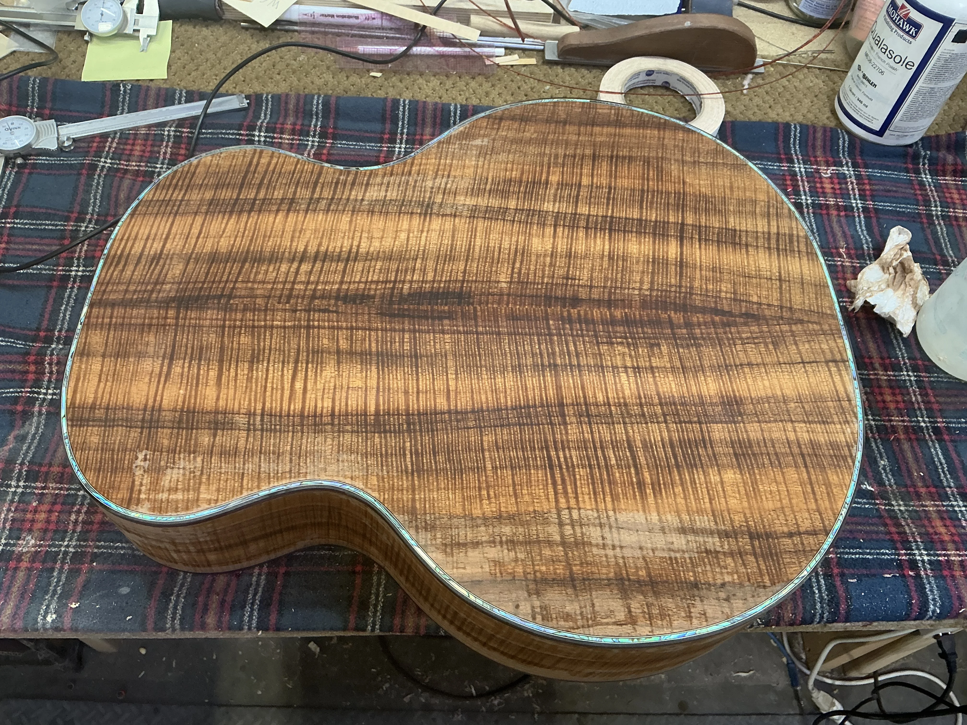

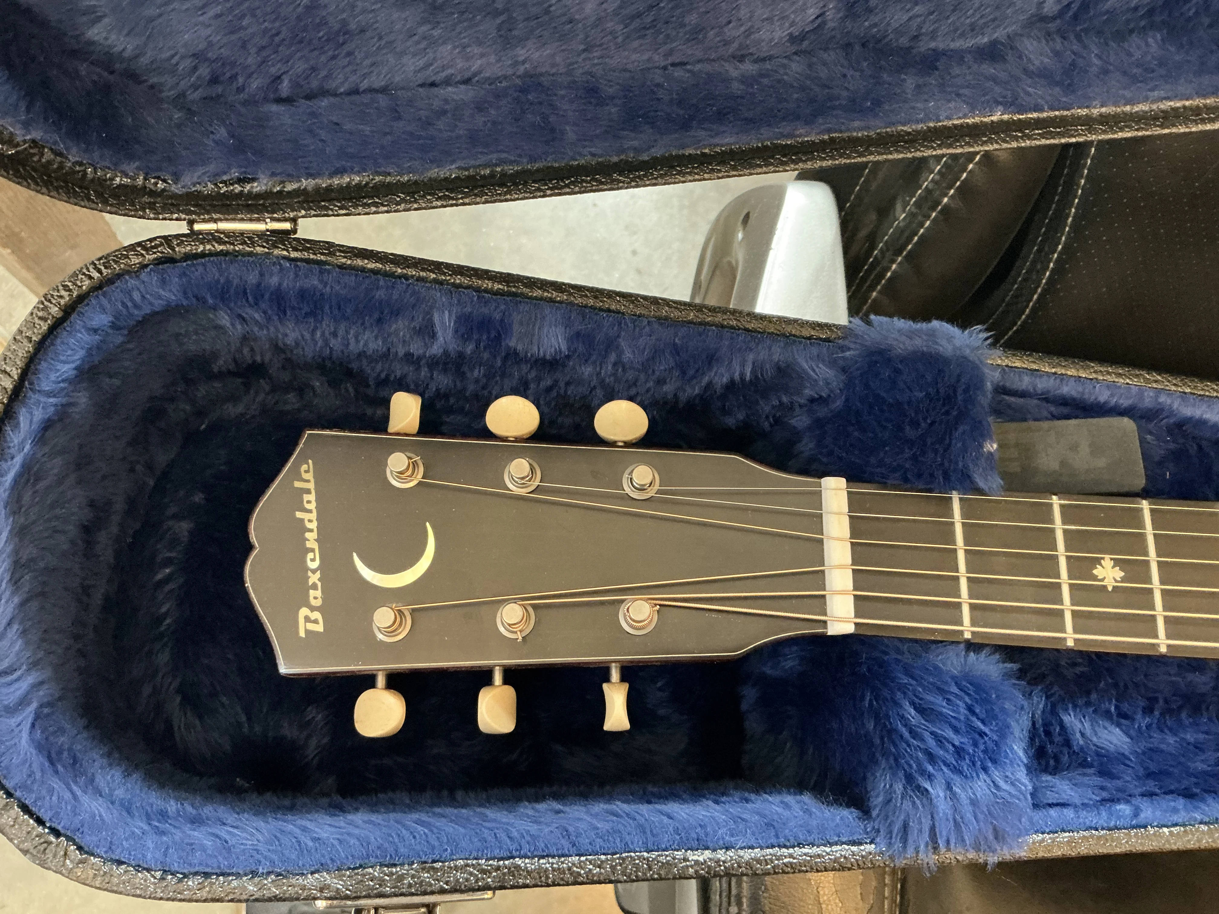

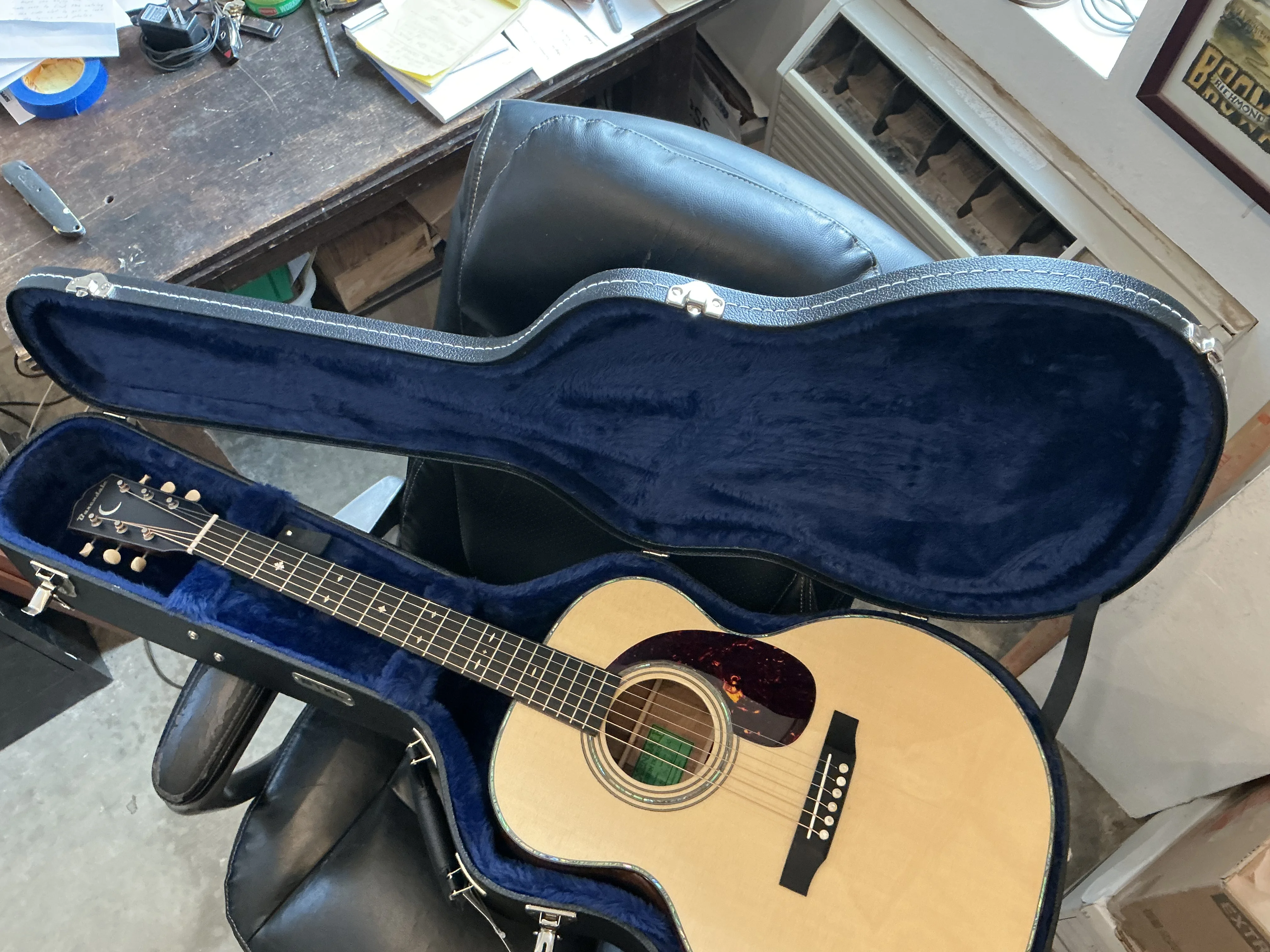

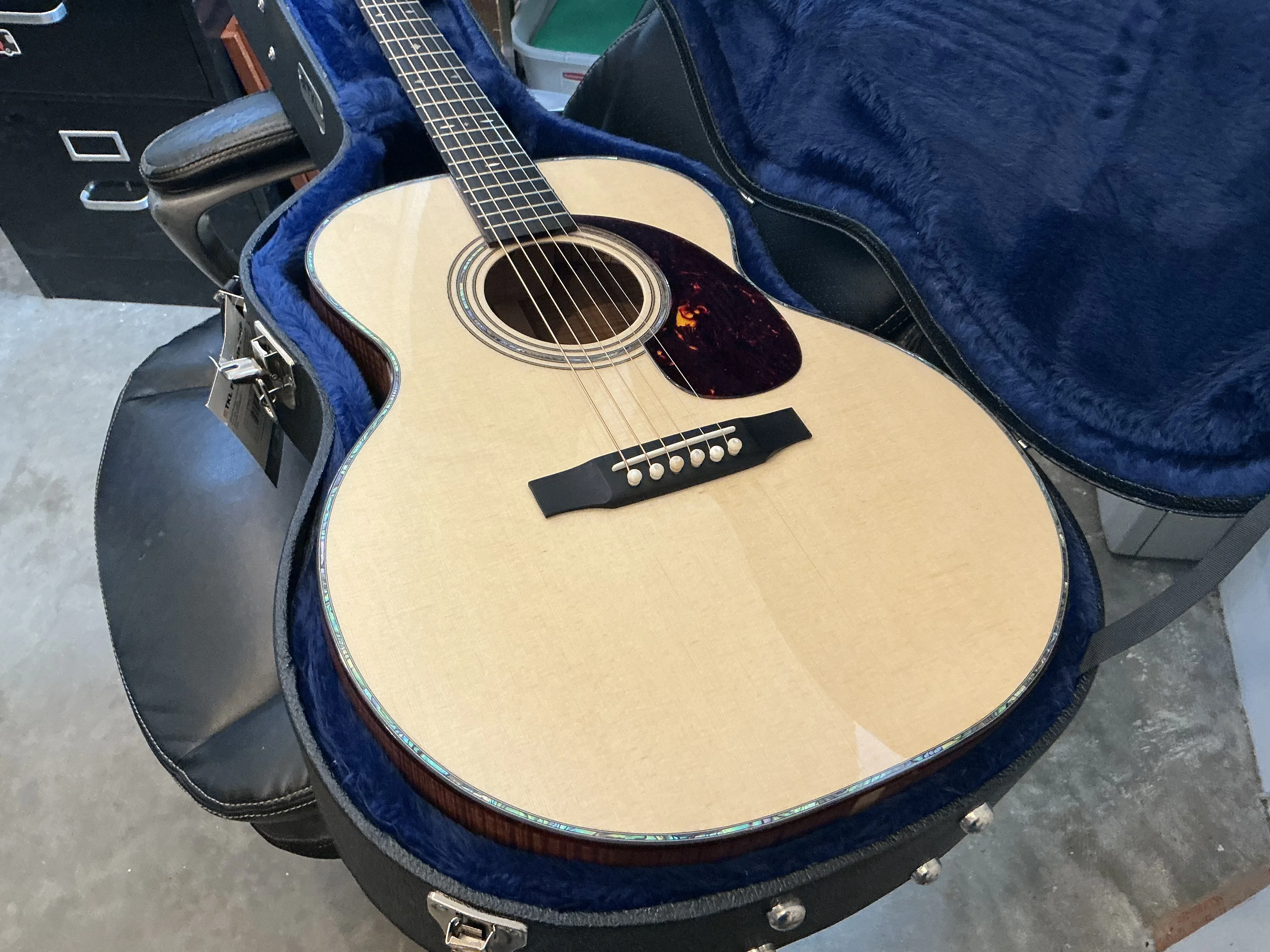

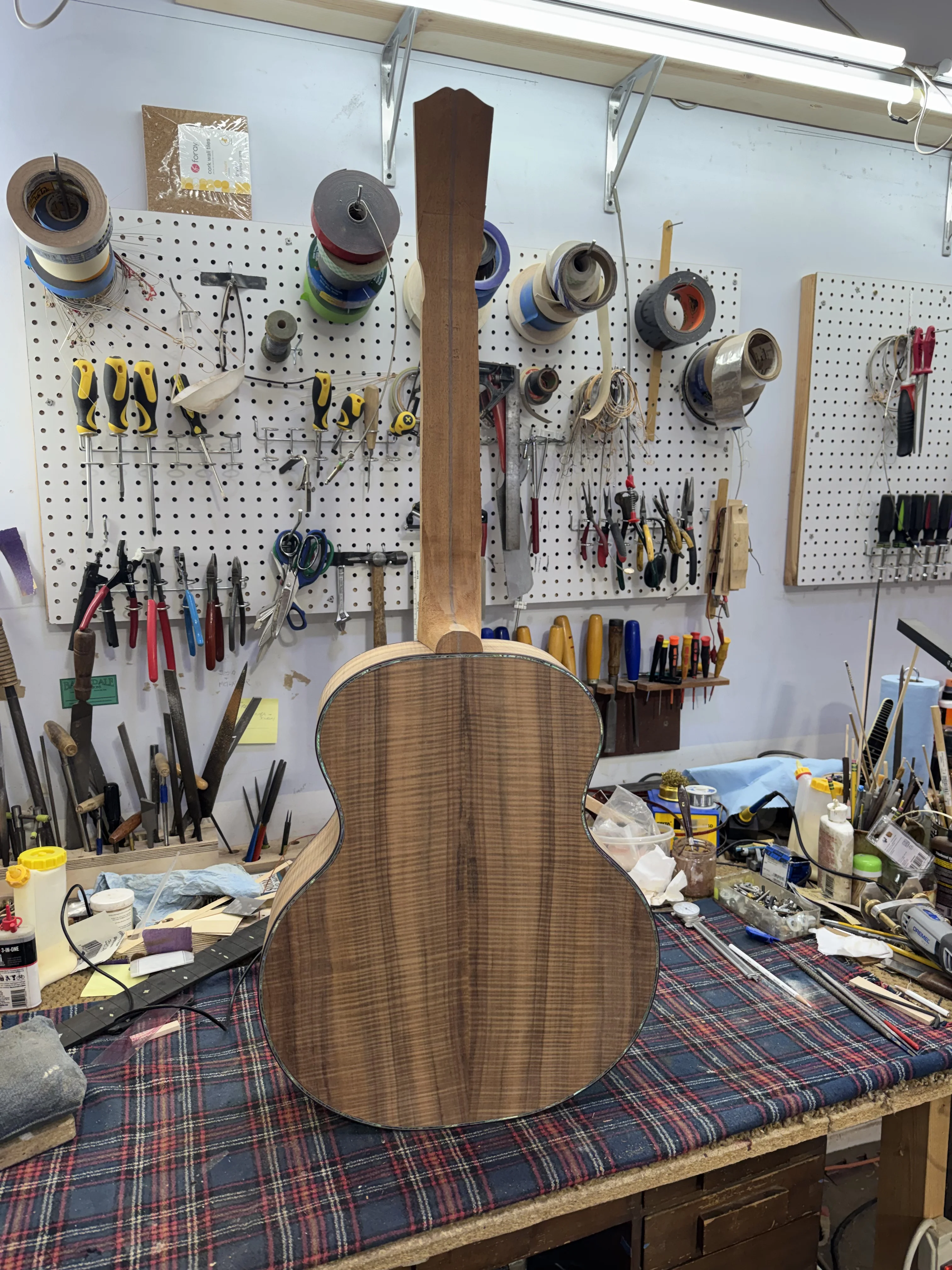

I just today finished building this Koa wood OM Custom Baxendale Guitar. I’m going to record it over the weekend before I deliver it to the customer. I’ll try to post the recording.

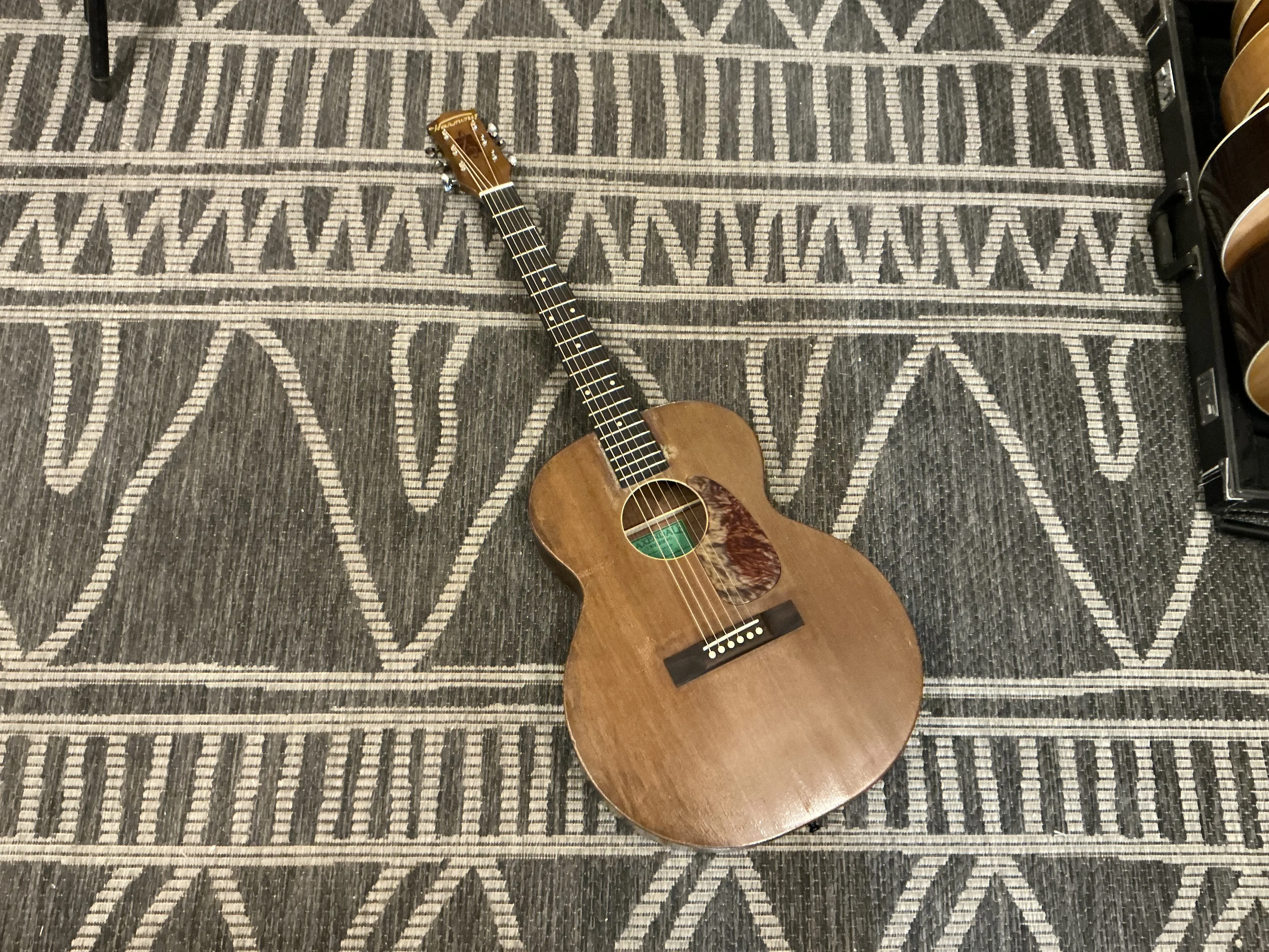

The best sounding/recording guitar in my shop is a 1940’s mahogany H165 that I rebraced like a prewar Martin. See the last photo.
